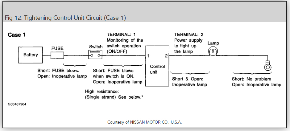

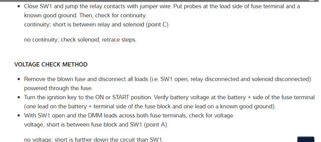

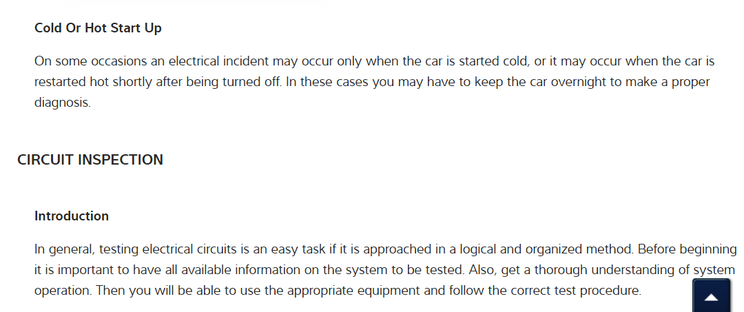

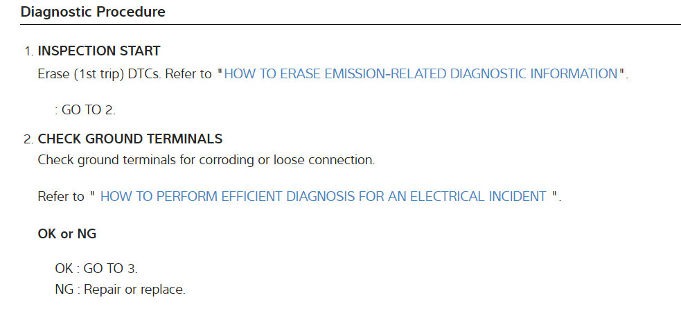

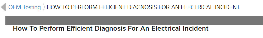

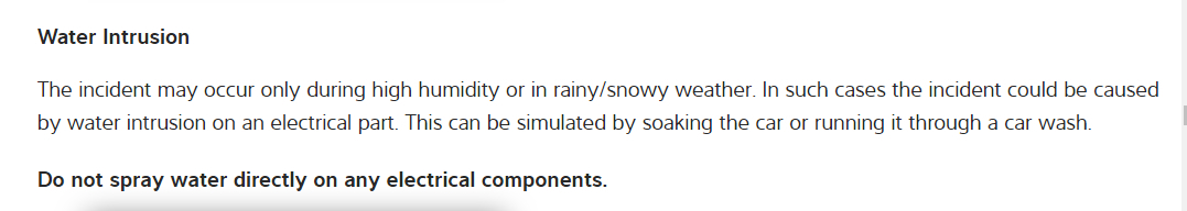

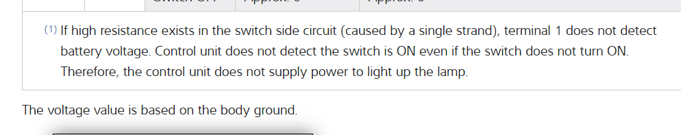

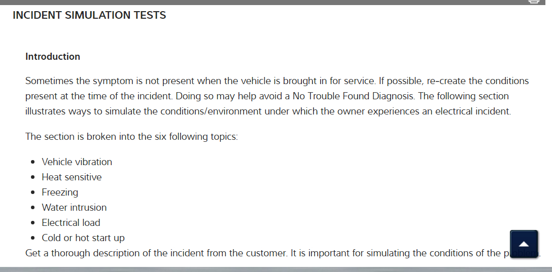

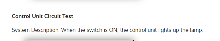

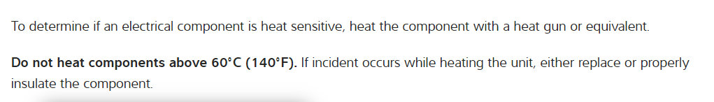

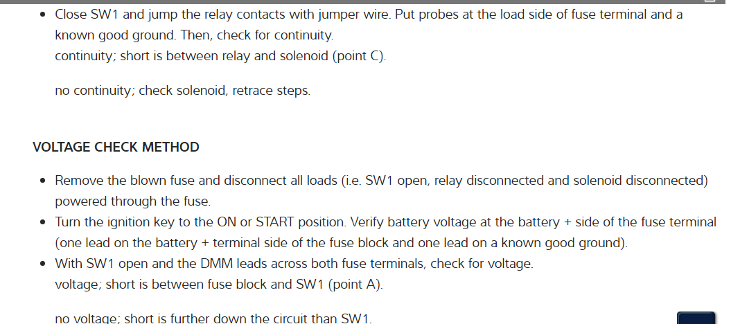

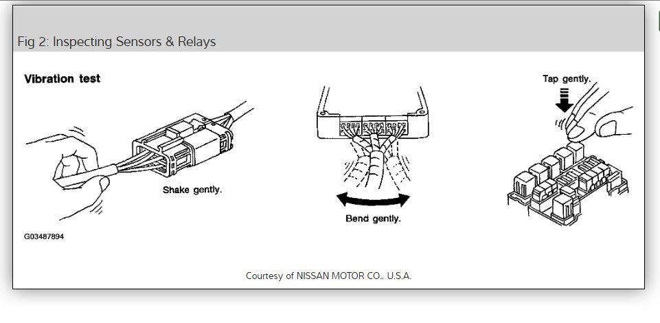

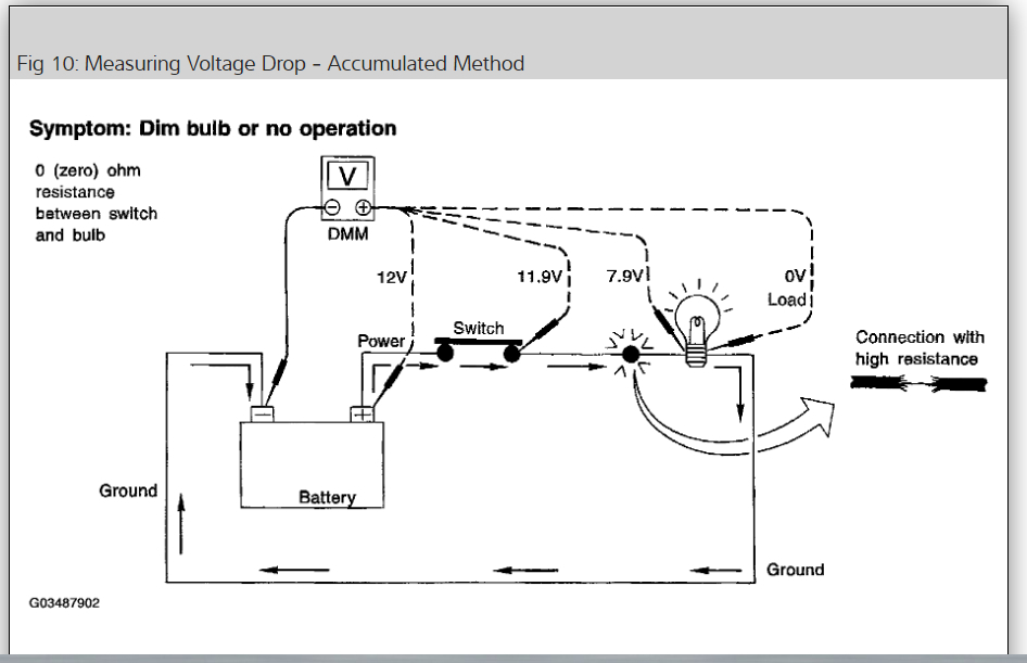

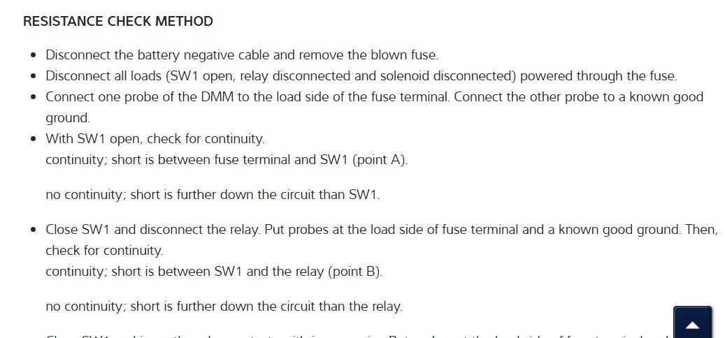

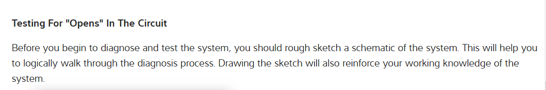

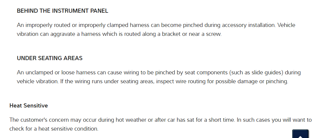

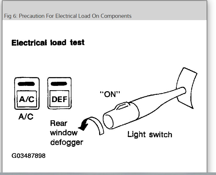

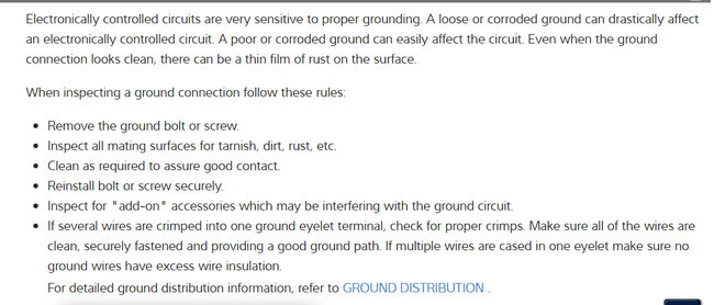

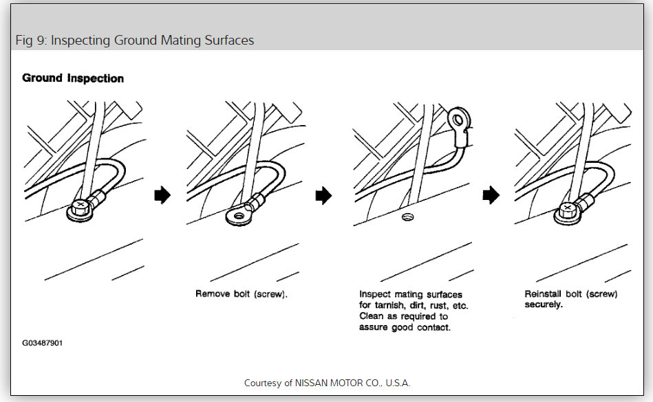

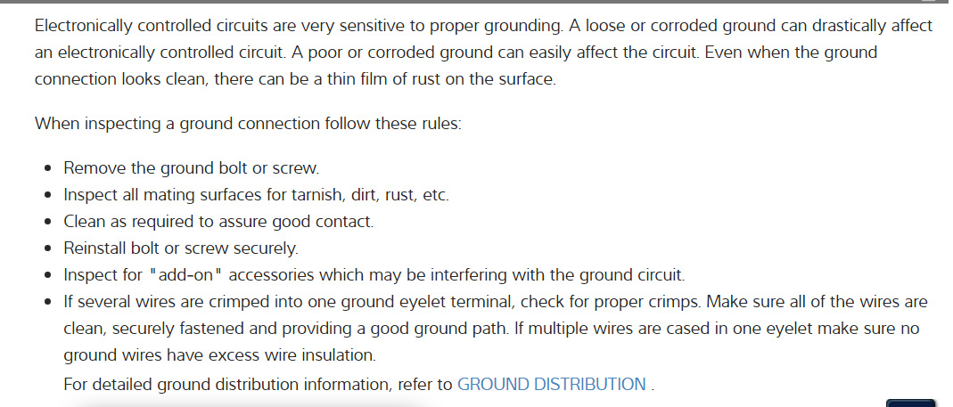

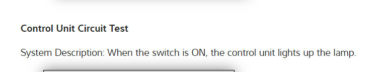

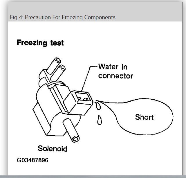

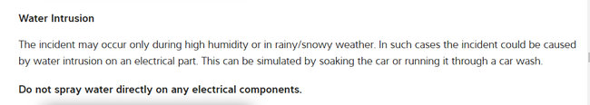

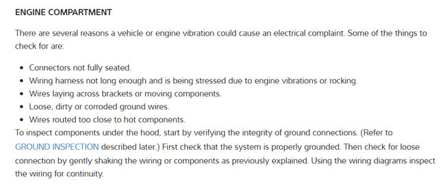

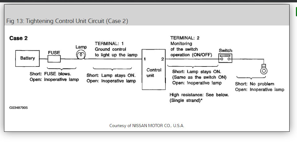

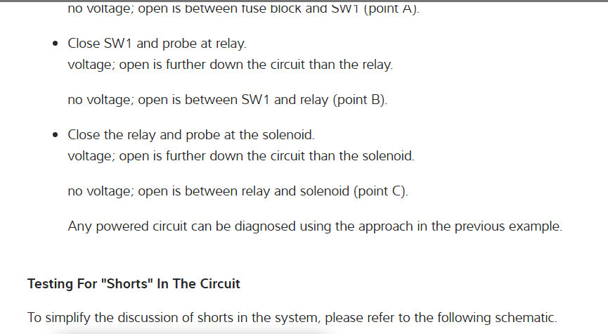

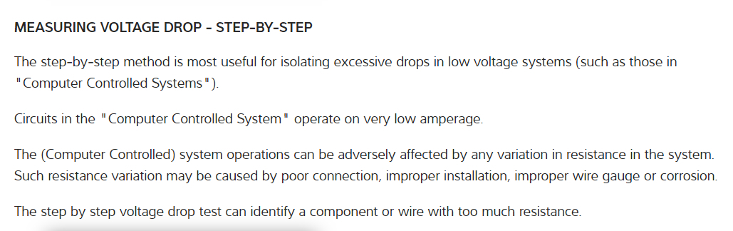

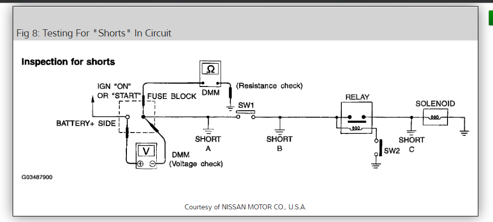

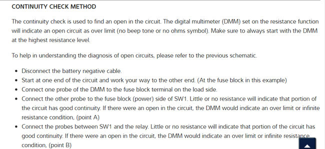

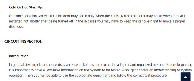

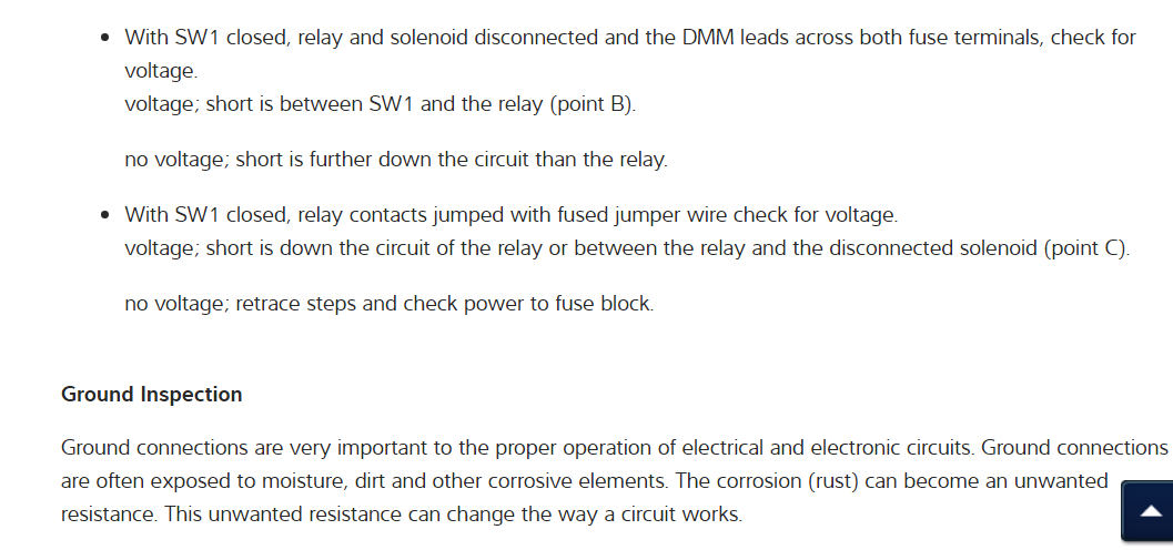

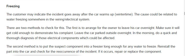

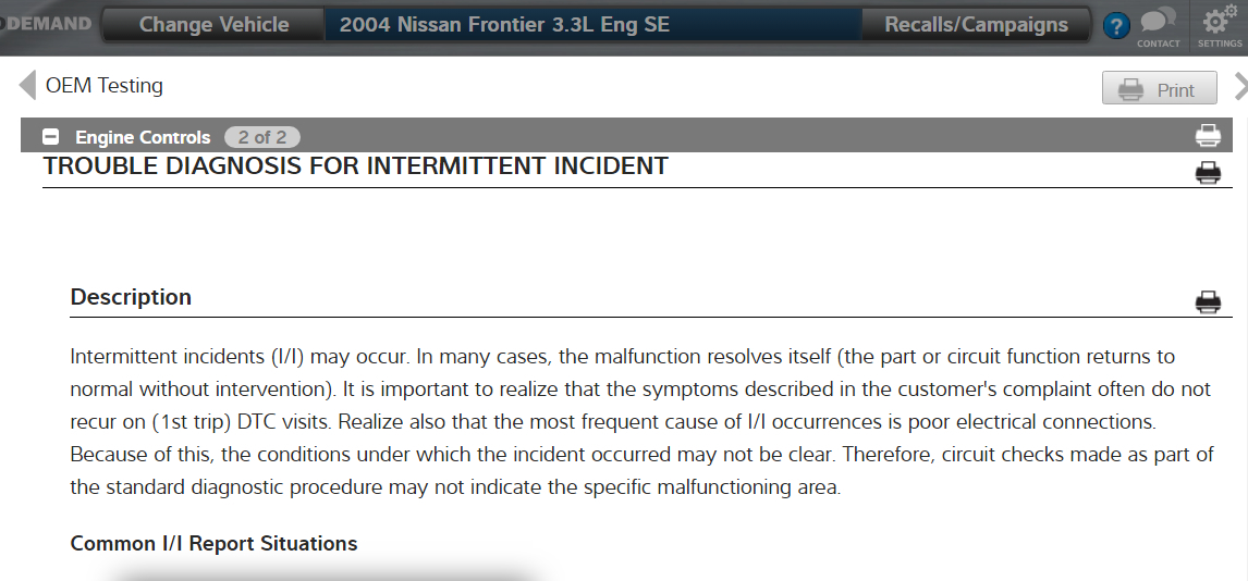

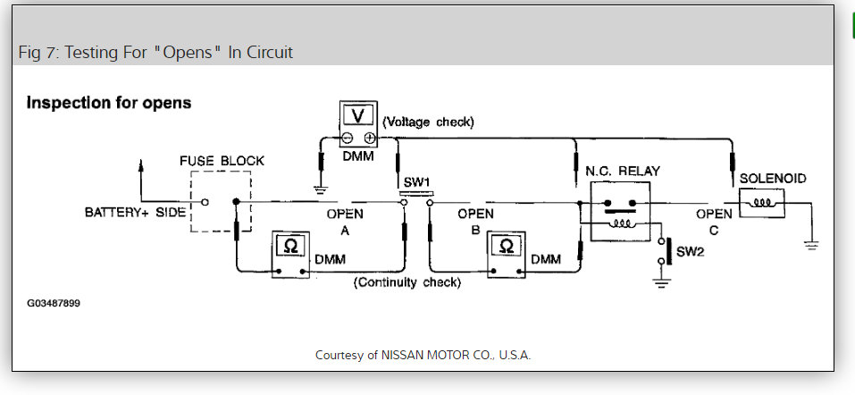

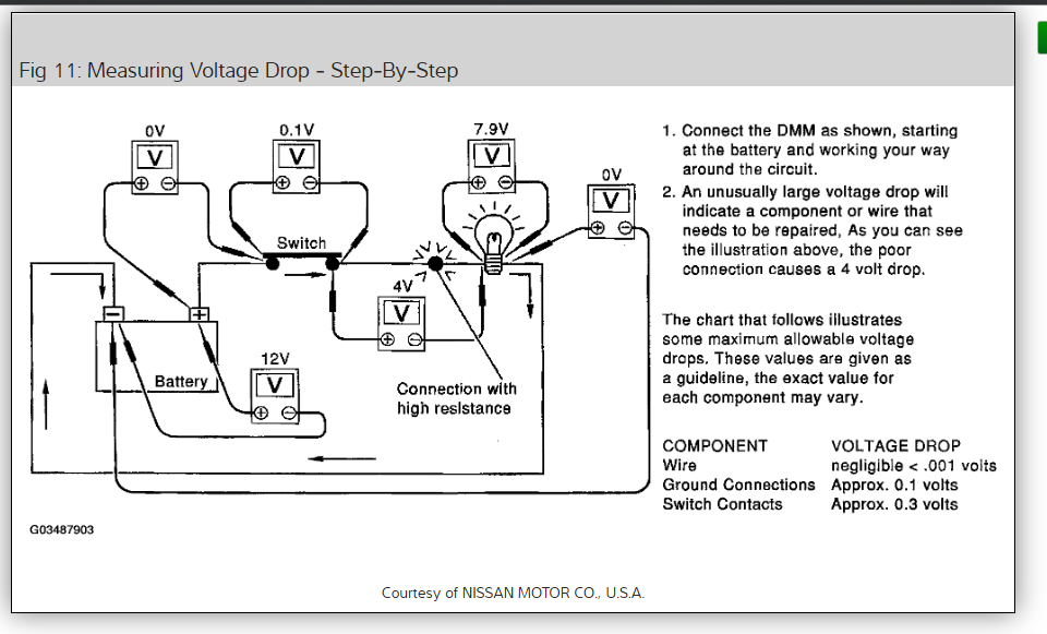

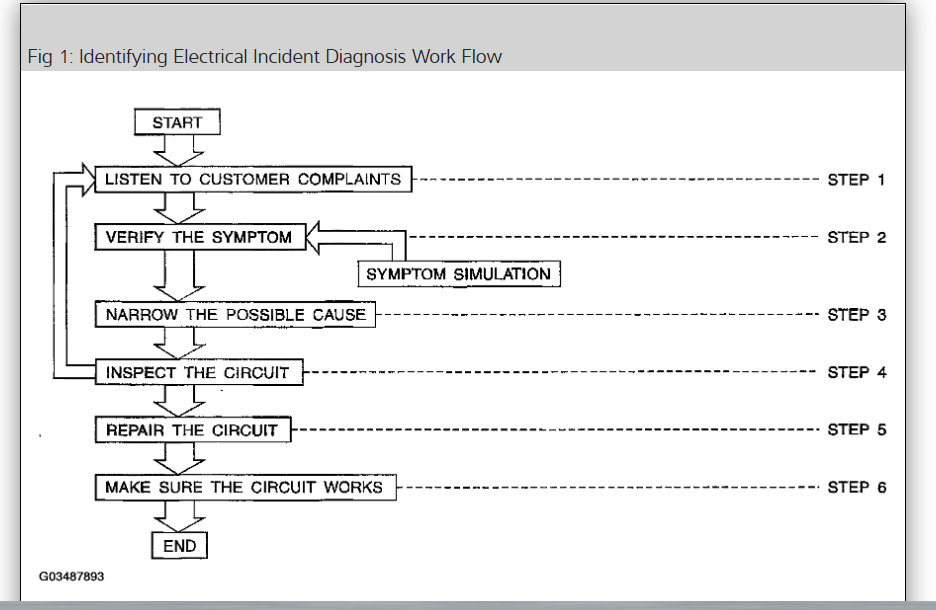

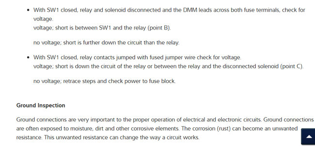

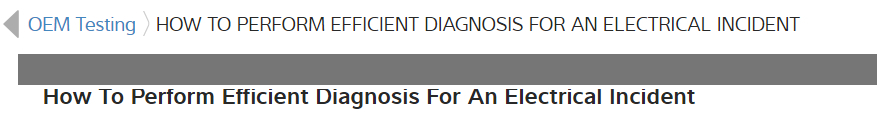

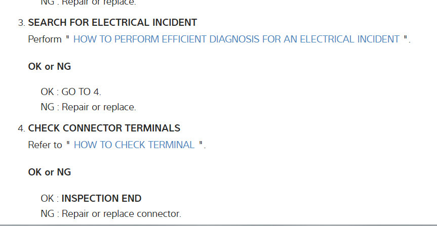

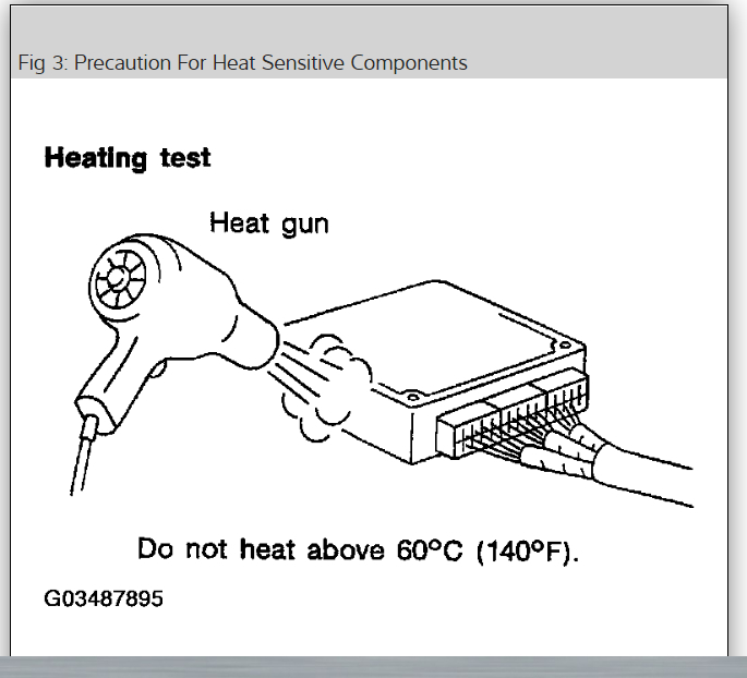

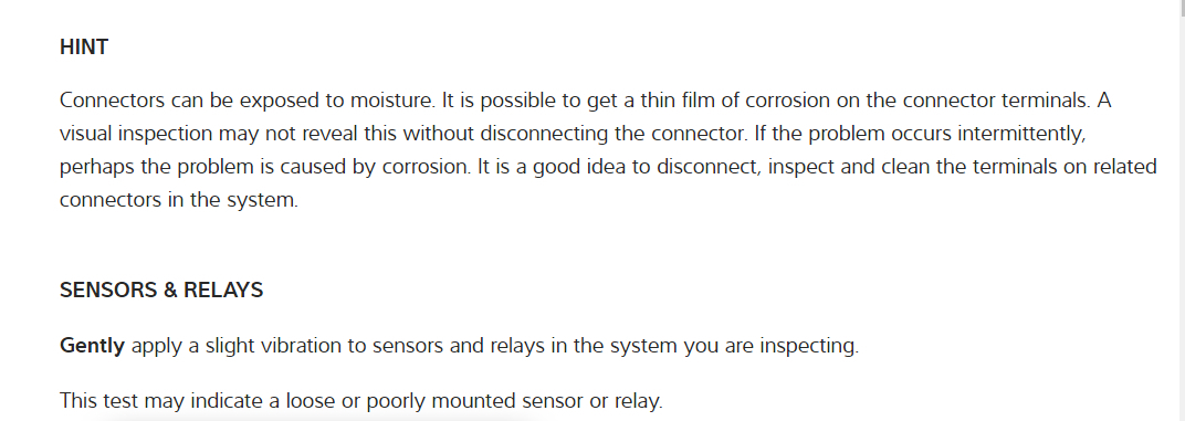

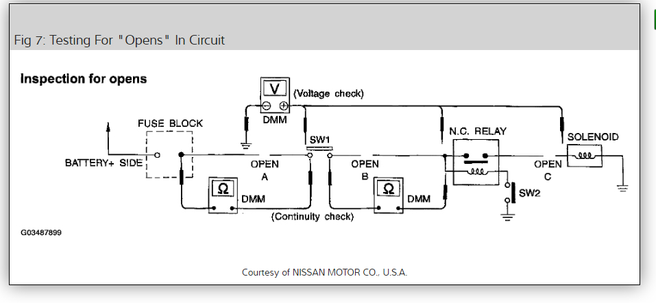

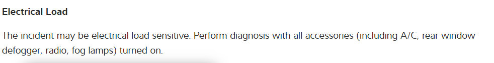

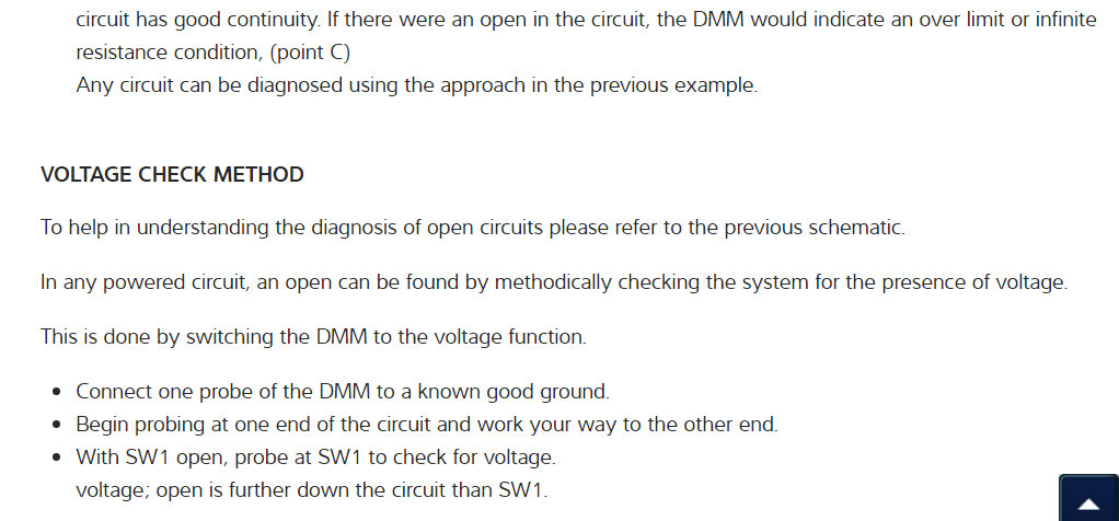

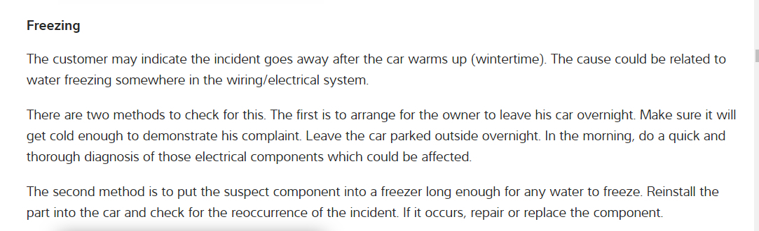

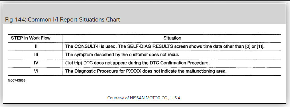

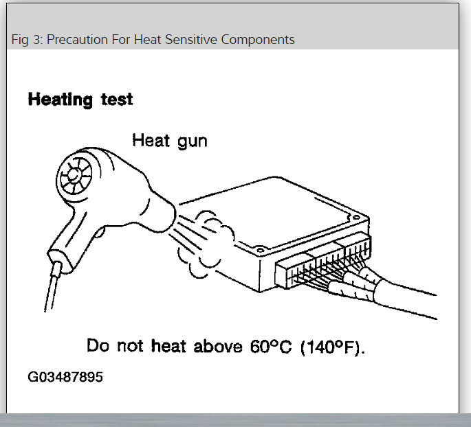

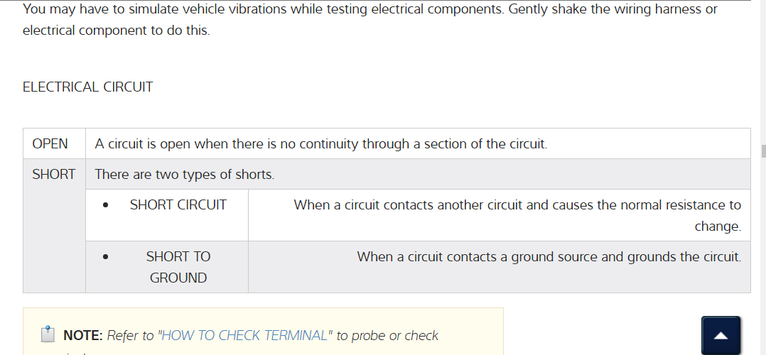

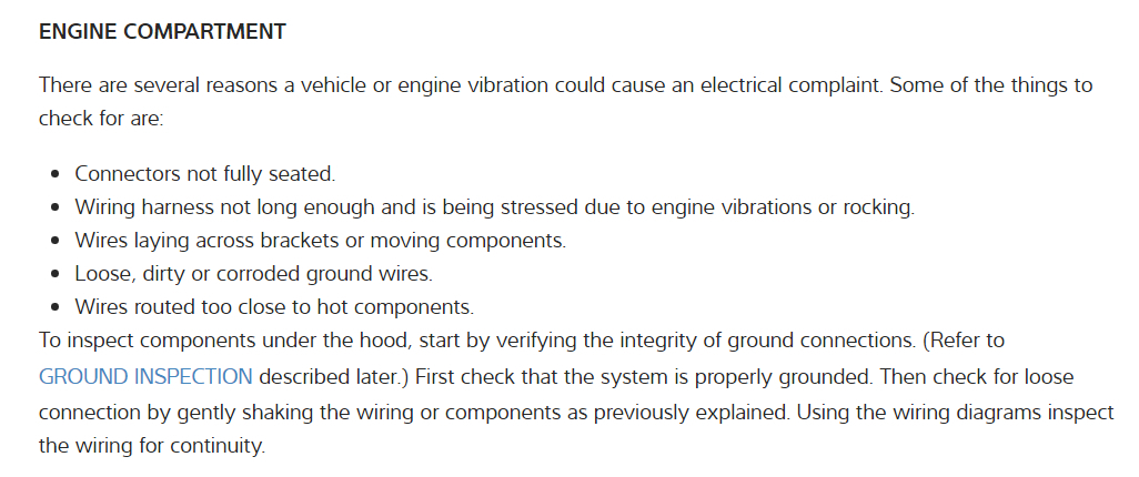

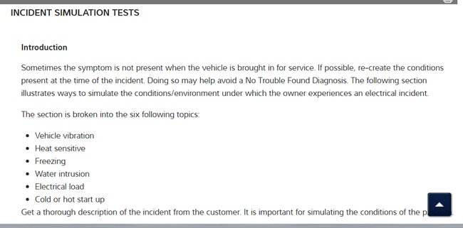

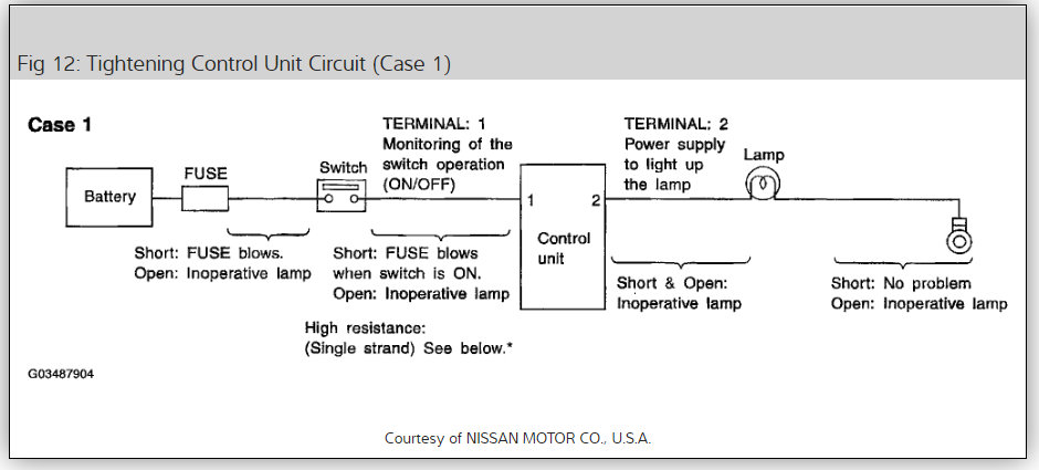

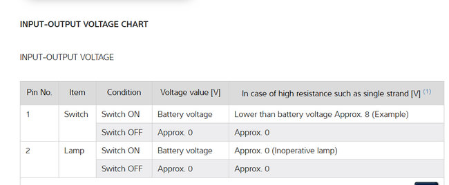

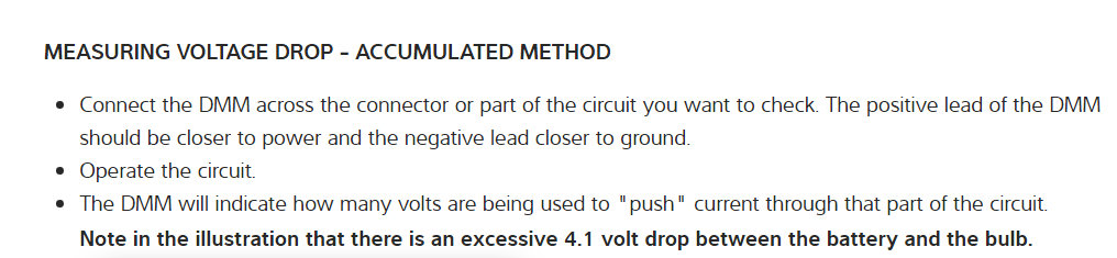

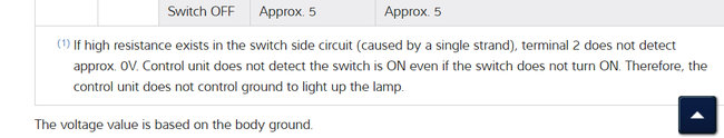

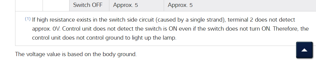

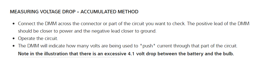

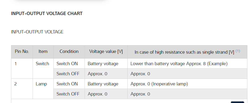

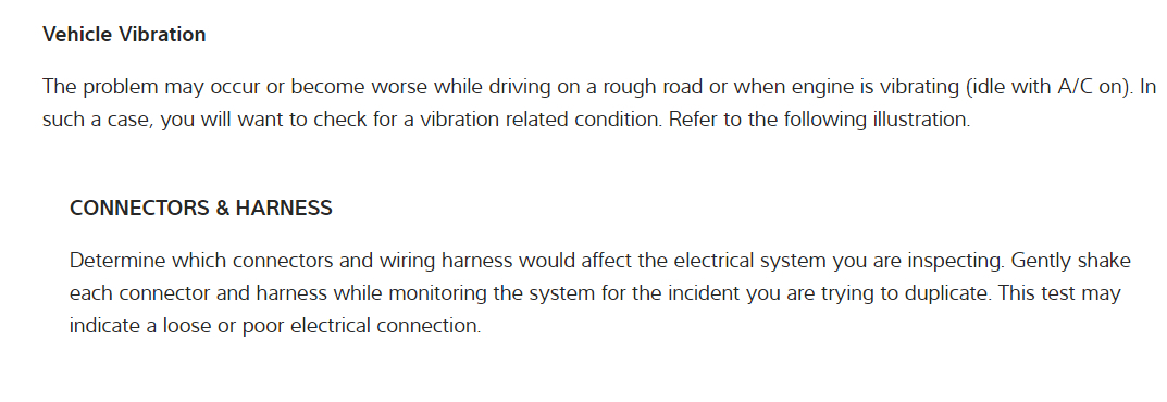

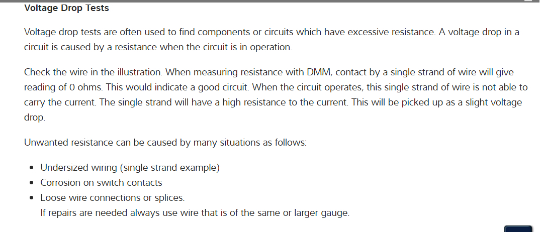

This could be a problem with the rotor being 180 degrees out. I have included in the diagrams down below Diagnostic Troubleshooting for intermittent conditions of your vehicle's ignition system. Please go through the guide and get back to us with what you are able to find out, please.
Thanks,
Alex
