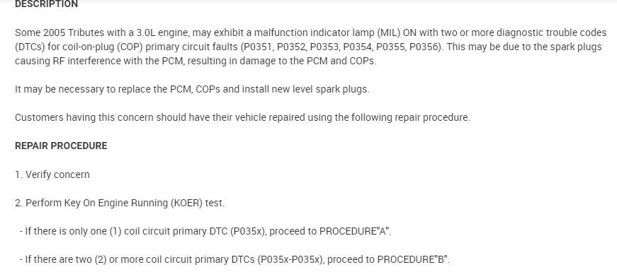

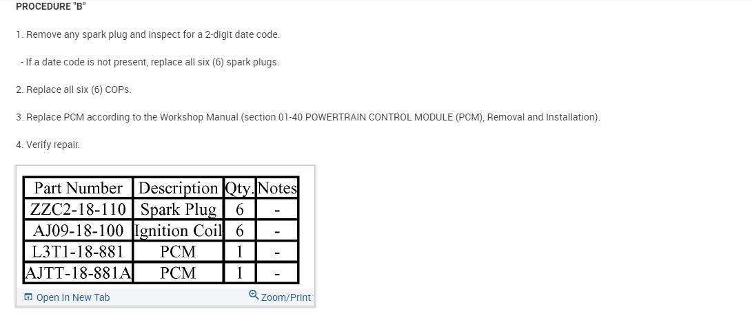

You should have changed the plugs when you had them out. That would be good preventive maintenance
Anyway, there is a TSB on this issue. It indicates that when the coils fail, it damages the PCM . This will require replacing plugs, coils and the PCM. Did many of these in the old days.
POWERTRAIN CONTROL MODULE (PCM) PROGRAMMING - WDS
When the PCM is replaced, the new PCM must be programmed with the old module's configuration information. The following step by step procedure guides you through replacement of the PCM in a Tribute using WDS or equivalent tester with B18 or later software.
