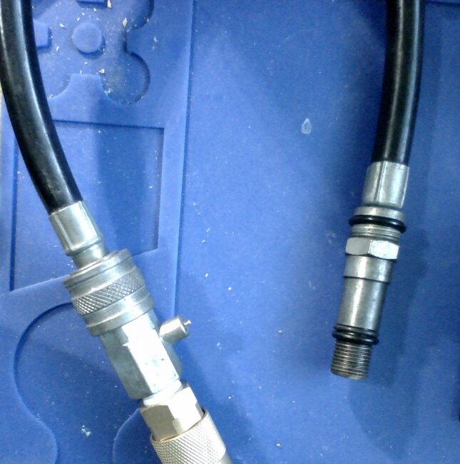

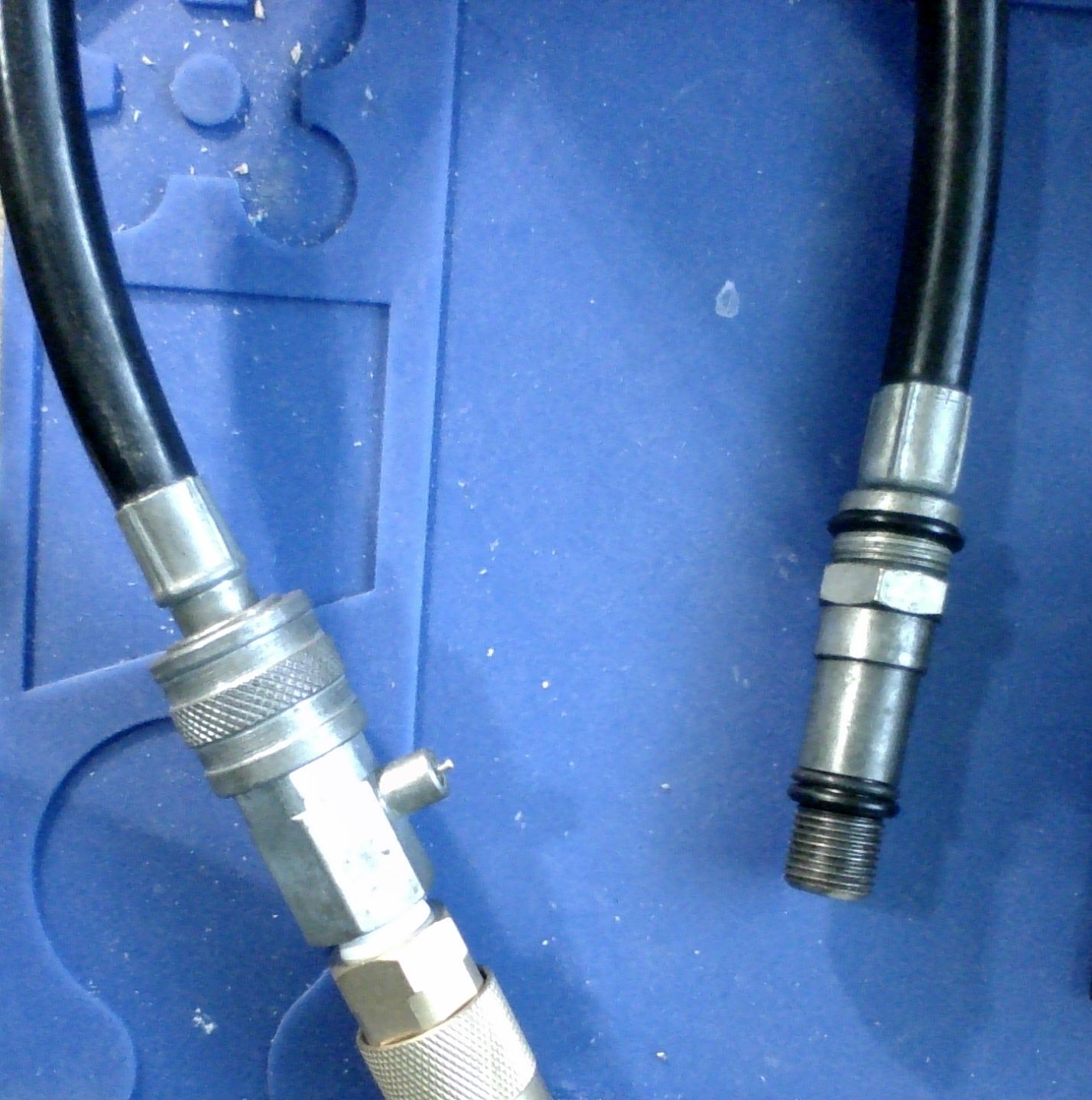

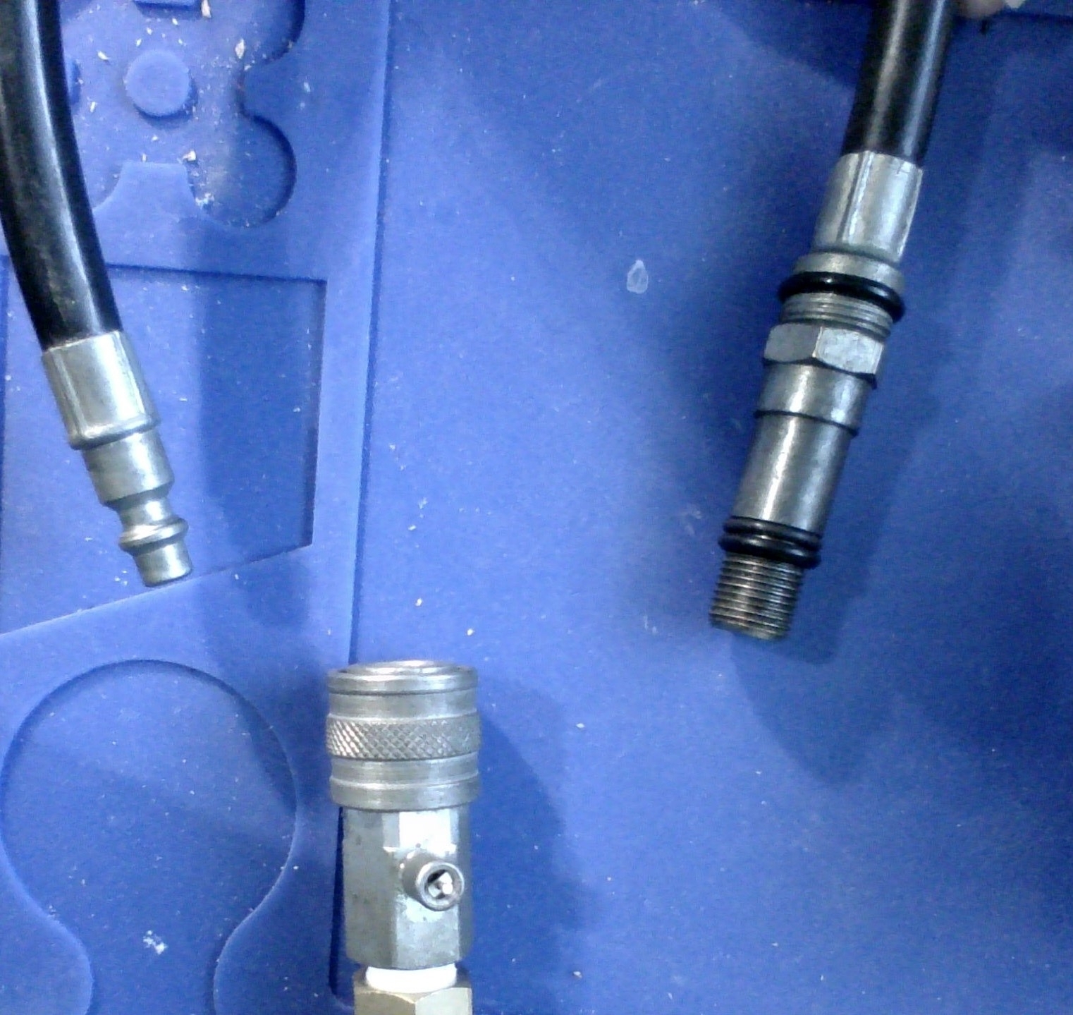

This is my compression gauge fitting; you can see the gauge comes off and it's an air hose fitting so I can put an air hose on it from my compressor for cylinder leakage tests.

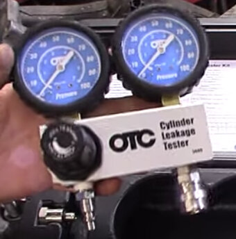

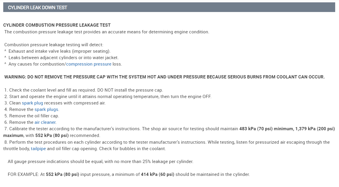

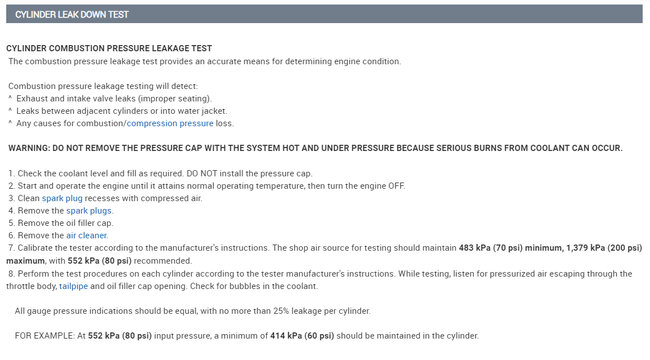

The 3rd picture is an actual cylinder leakage tester you can get at Harbor Freight for around 70 dollars. But once you determine whether the fault area is in the cylinder head or in the engine block such as a piston or ring, then you can decide what to do from there.
Here's a quick video that walks you through the process. It's only 10 minutes:
https://www.youtube.com/watch?v=h993q16Oul4
