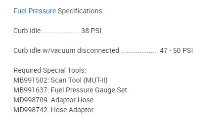

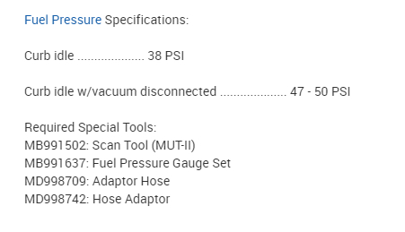

Also, check the fuel pressure to be sure there is sufficient fuel to the injectors for running the motor correctly.
