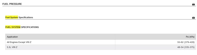

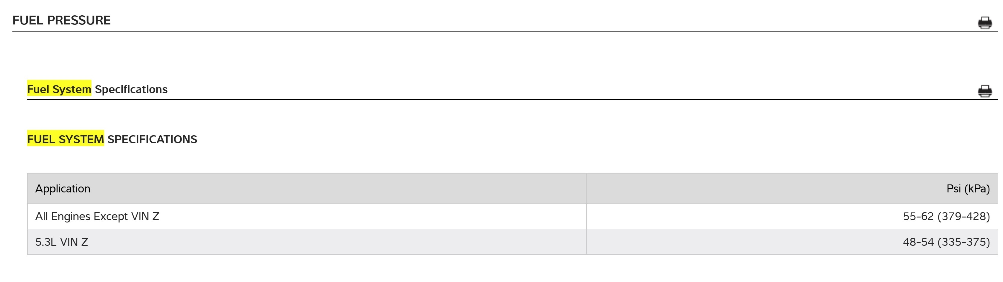

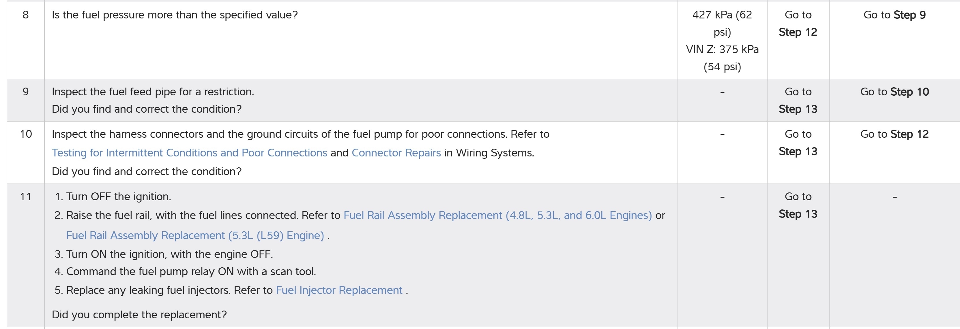

The spec for the fuel pressure shouldn't go below 55 PSI is what my information is telling me. So, a weak fuel pump could be an issue, but I think it is best to check the wiring and make sure there are no issues with the connector or any resistance in the power circuit that could cause the pump to slow down before condemning the pump.

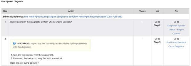

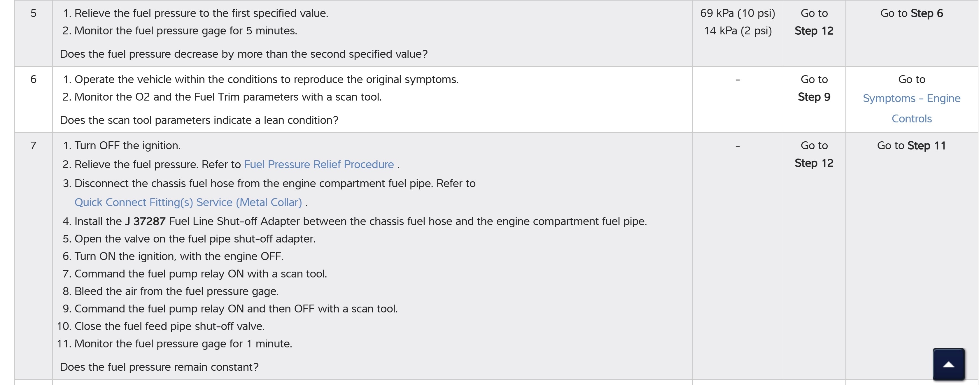

I would check the wiring to the pump. I will include a wiring diagram for you. There is a ground on the outside of the frame rail under the driver's side door right behind a body mount. I would clean that up to make sure you have a good ground. This runs the Fuel pump and the ABS Module.

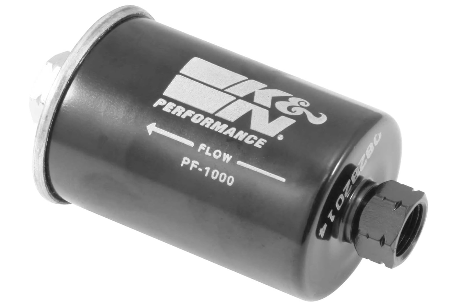

I would also replace the fuel filter. I use a K&N High Flow filter.

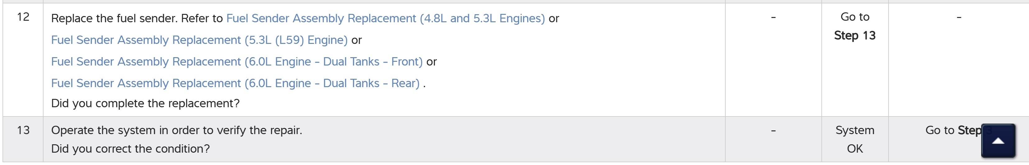

If you replace the pump, get it from GM. It's actually cheaper or at least was than going to an auto parts store and it comes with the updated harness. I think mine was under $400.00.

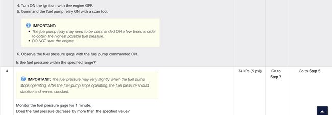

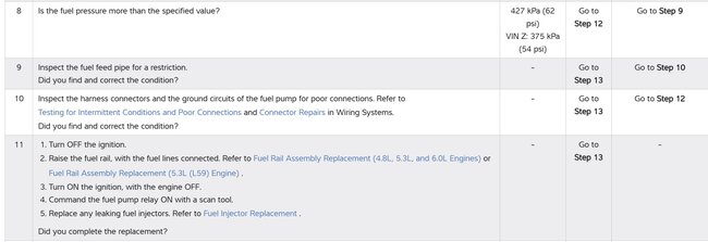

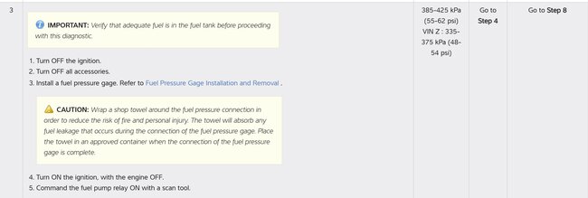

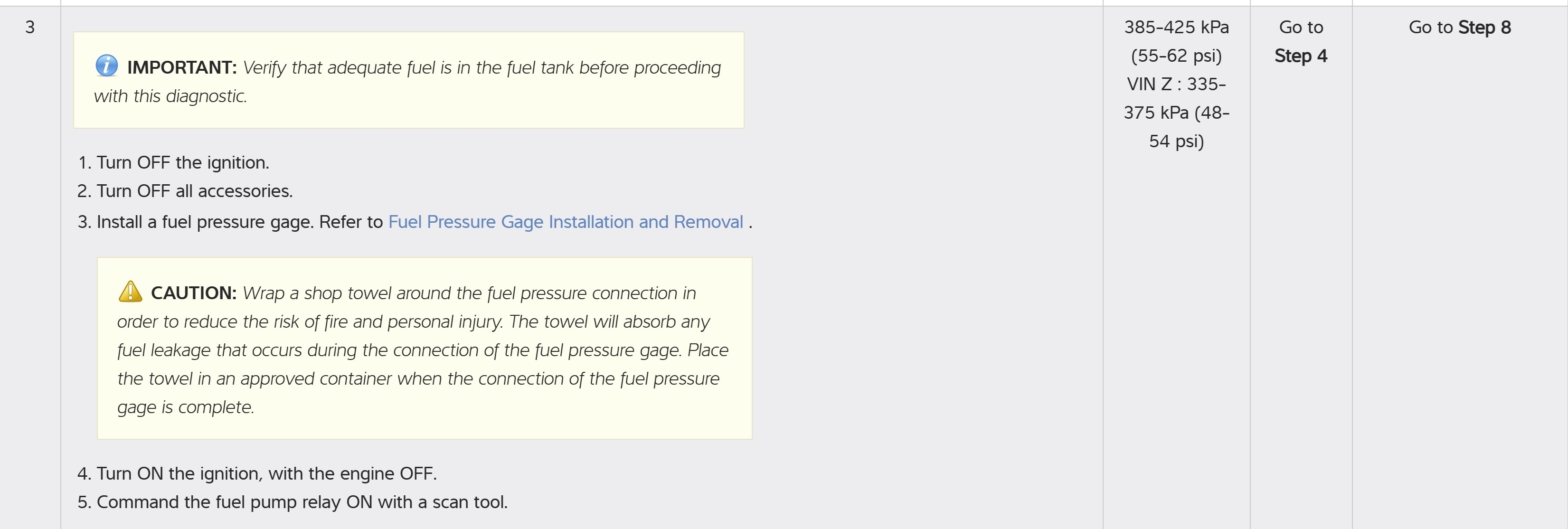

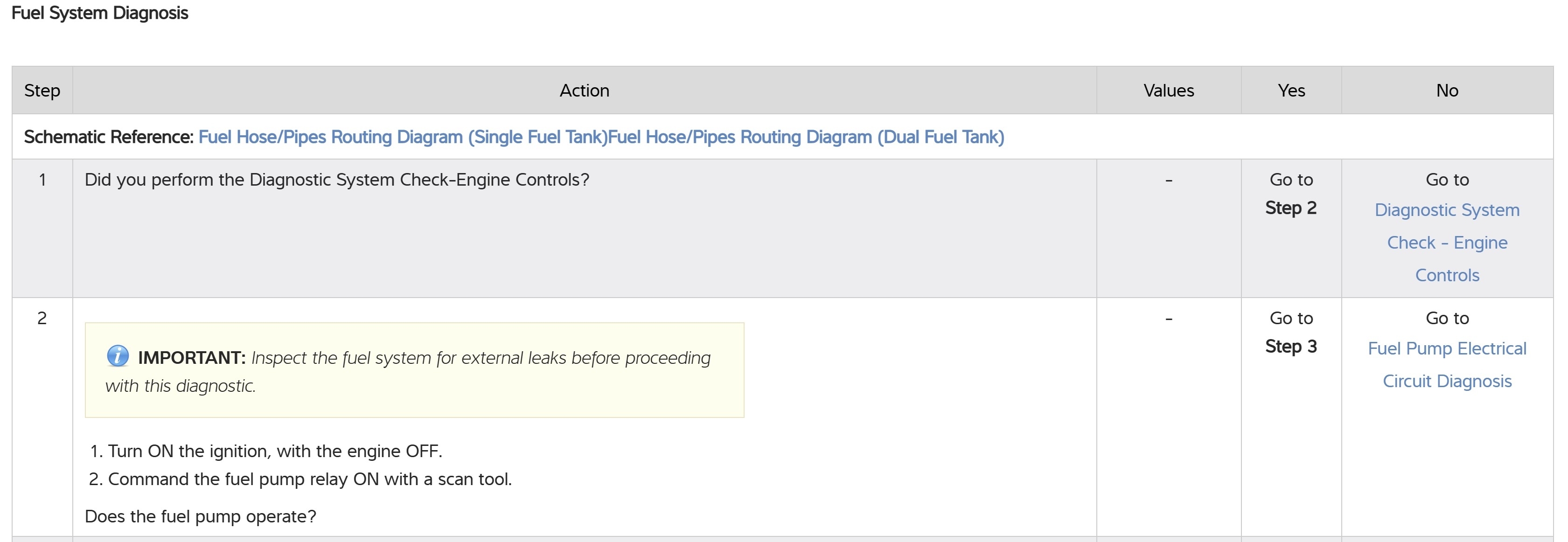

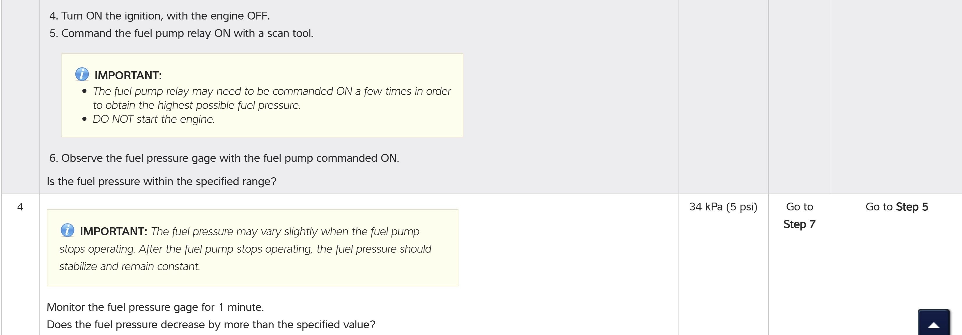

I will include some wiring diagrams, images and diagnostics procedures for you. In one of the pictures there are some pins called T-pins. I use these myself to back probe connectors. I suggest using them as it makes it easy to clip and alligator clip to for a multimeter.
