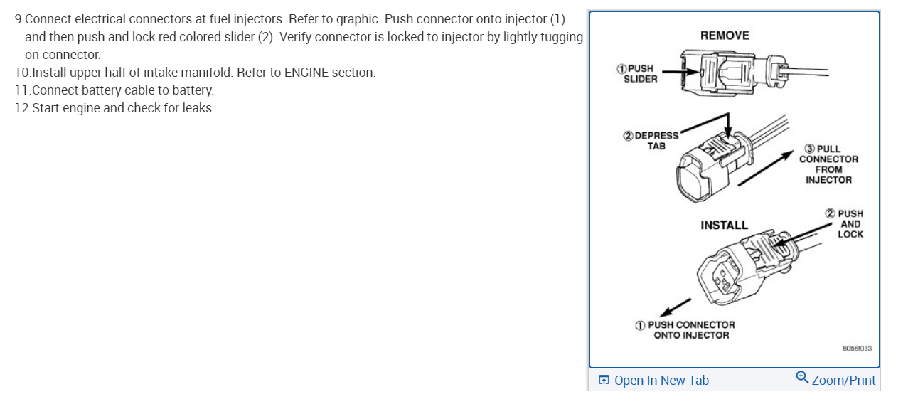

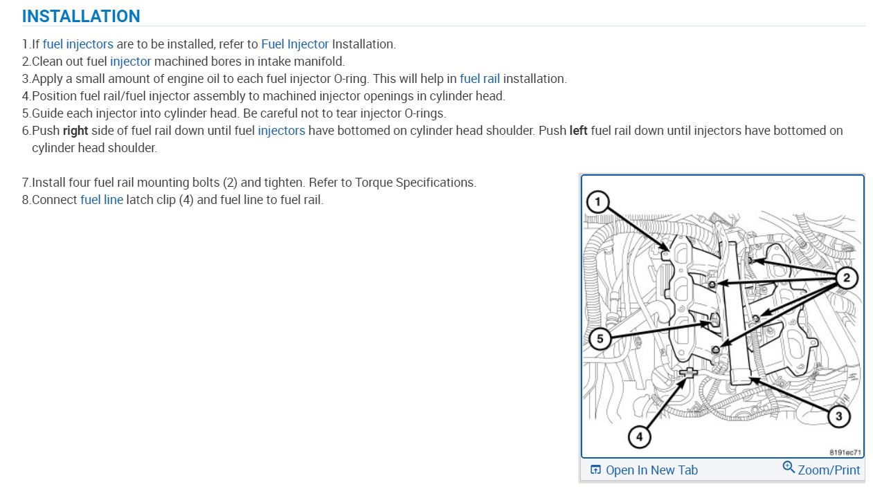

Yep, the fuel injector would be next. Can I ask if the engine is making a slight ticking sound? If so, can you please shoot a quick video with your phone so I can hear the noise? that way I can tell for sure what's going on. You can upload it here with your response. You might have a valve train problem.

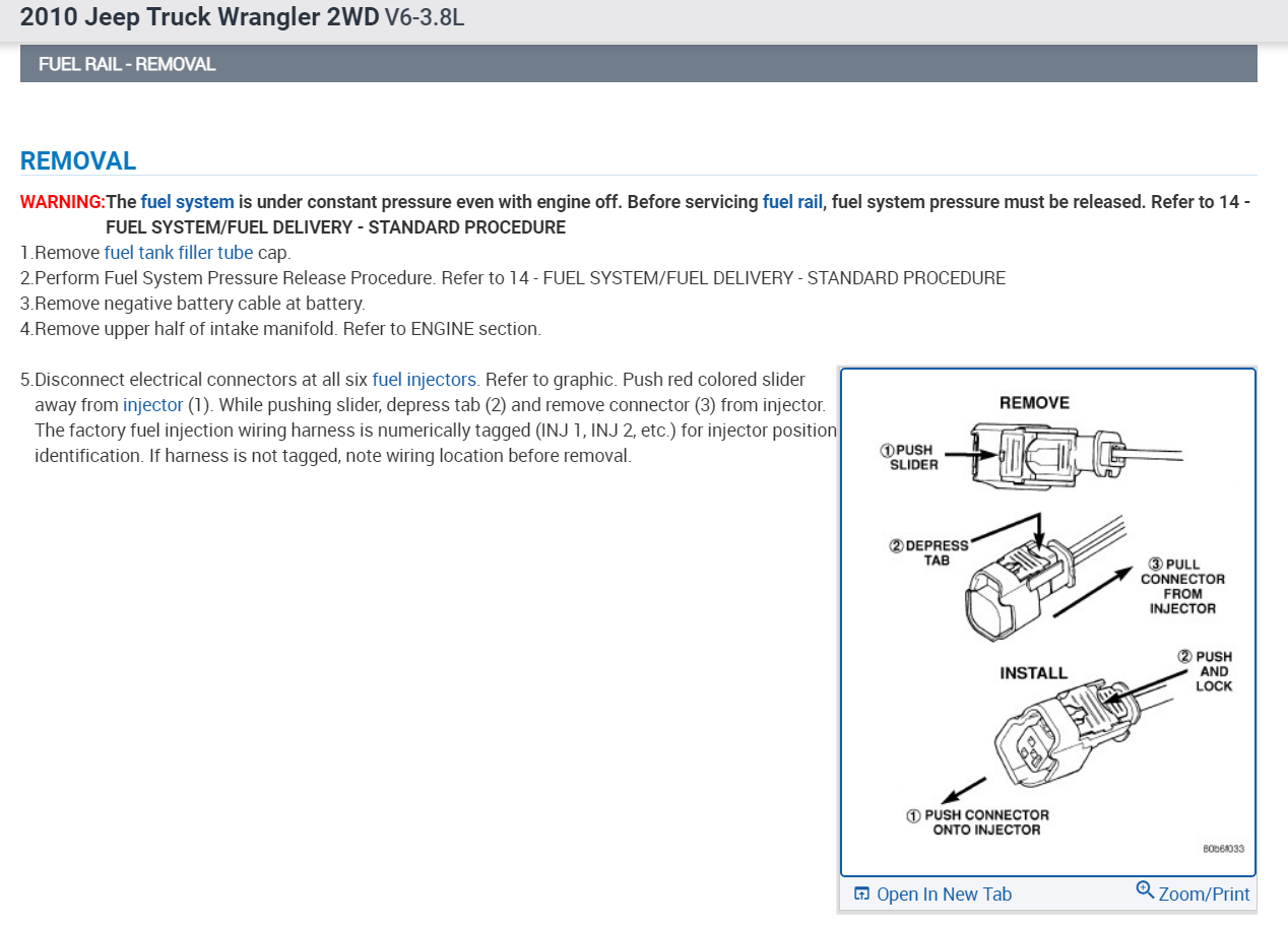

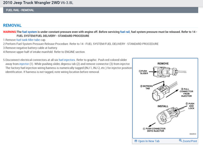

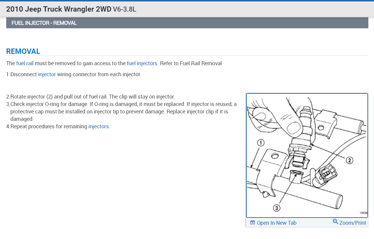

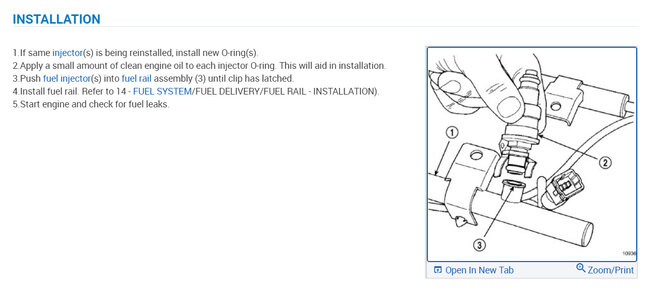

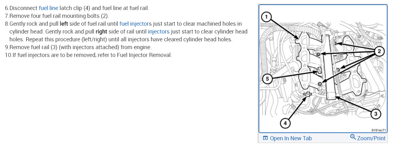

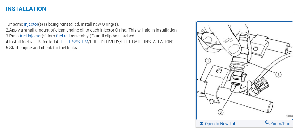

Here is how to change the fuel injector out and a guide on misfire problems:
https://www.2carpros.com/articles/engine-misfires-or-runs-rough
and
https://www.2carpros.com/articles/symptoms-of-engine-misfires-a-step-by-step-guide
Check out the images (below). Let us know what happens and please upload pictures or videos of the problem so we can see what's going on.
