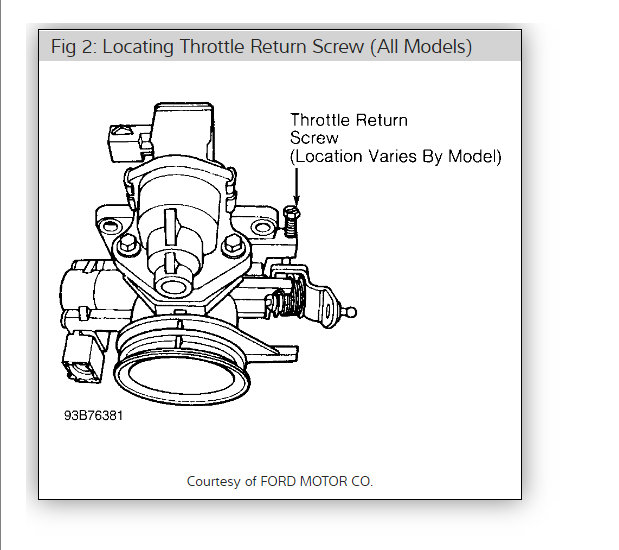

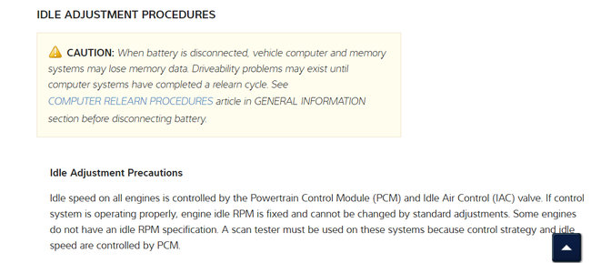

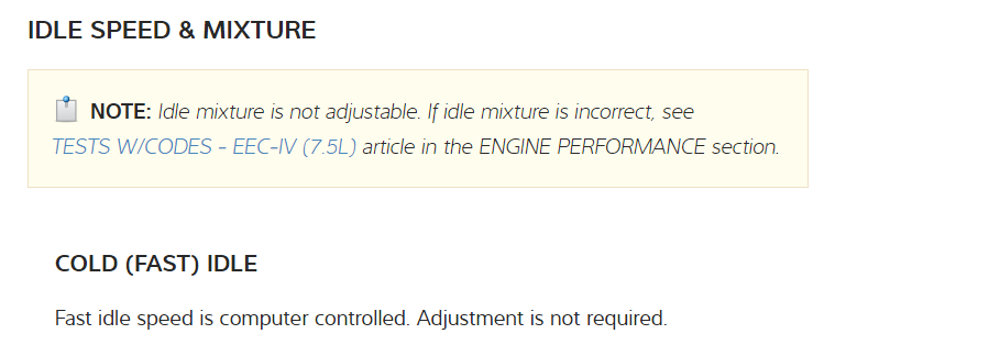

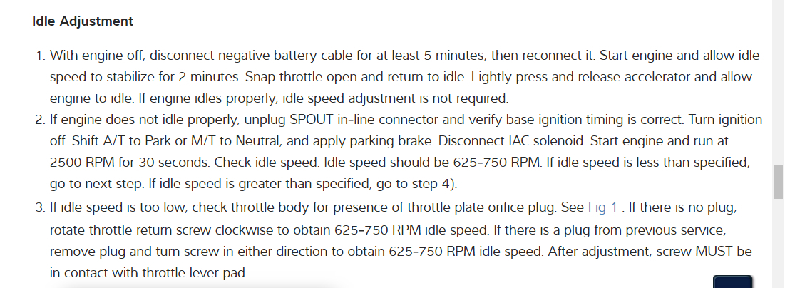

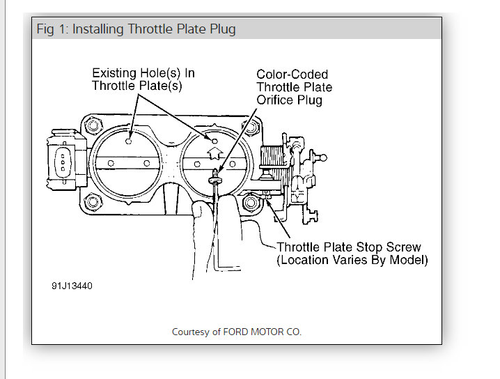

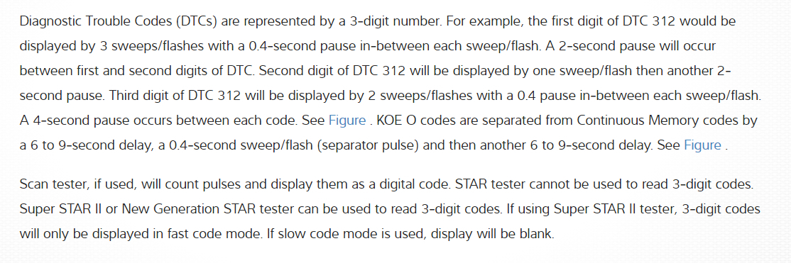

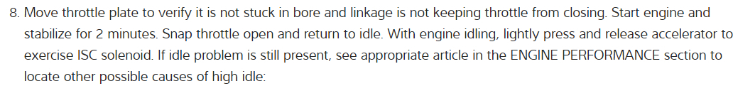

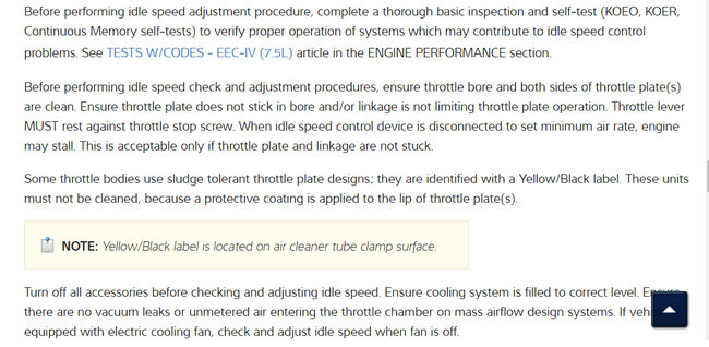

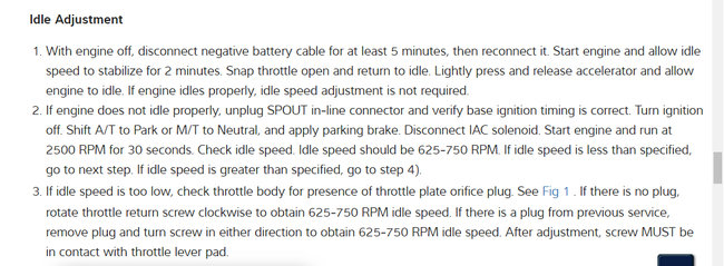

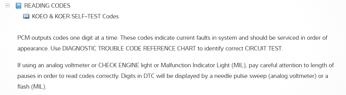

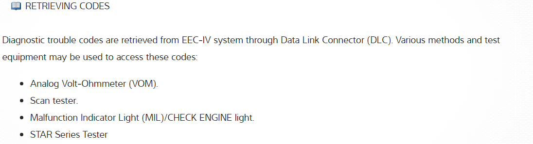

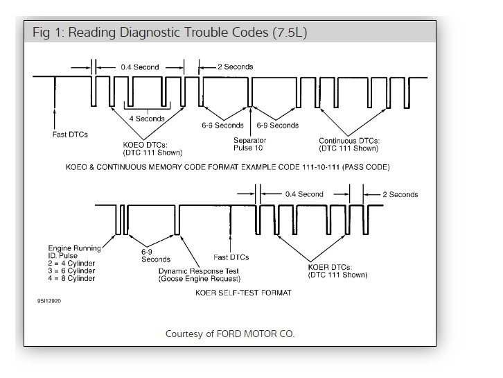

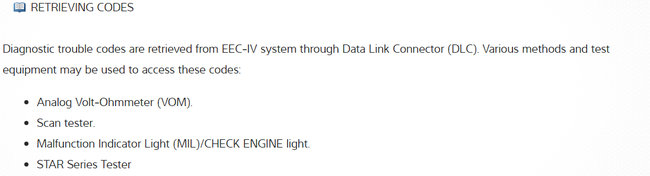

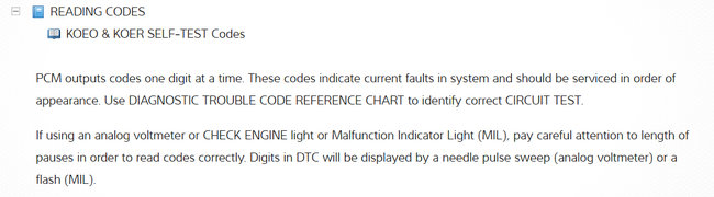

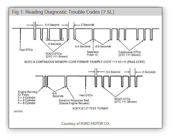

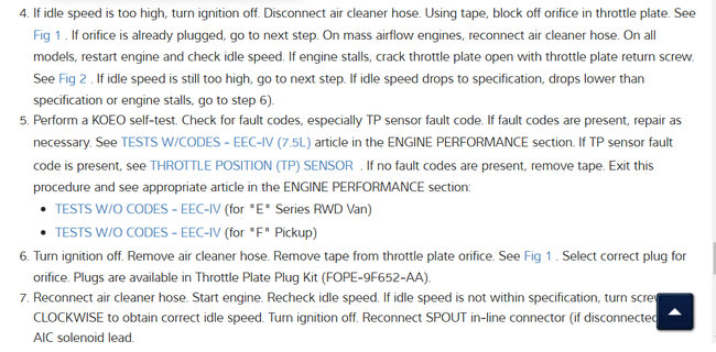

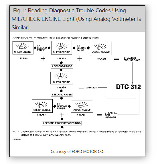

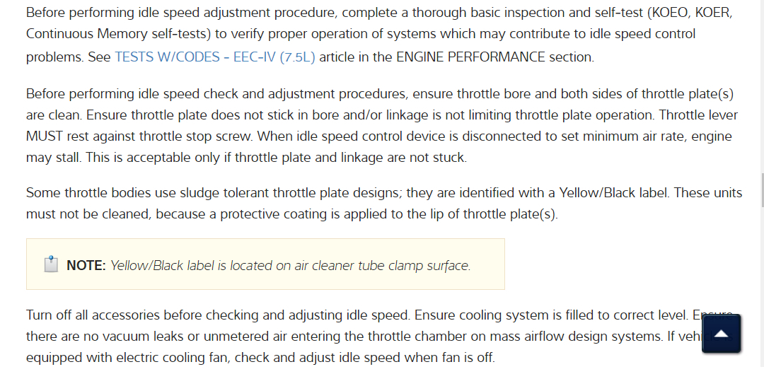

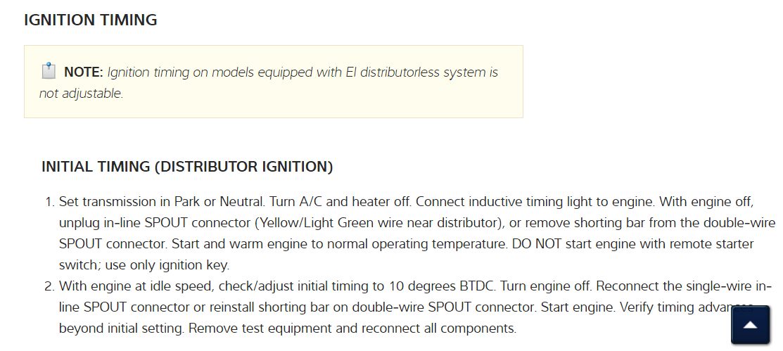

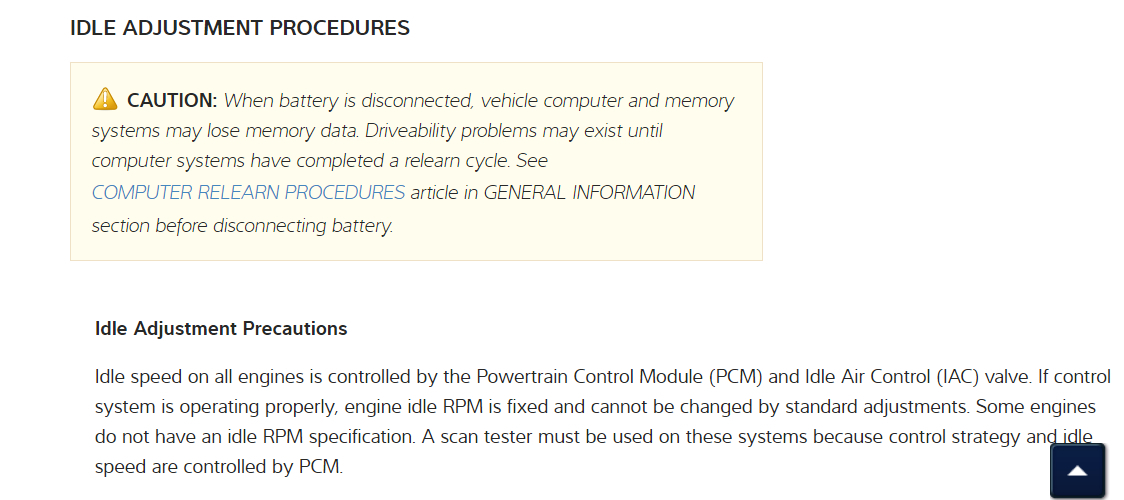

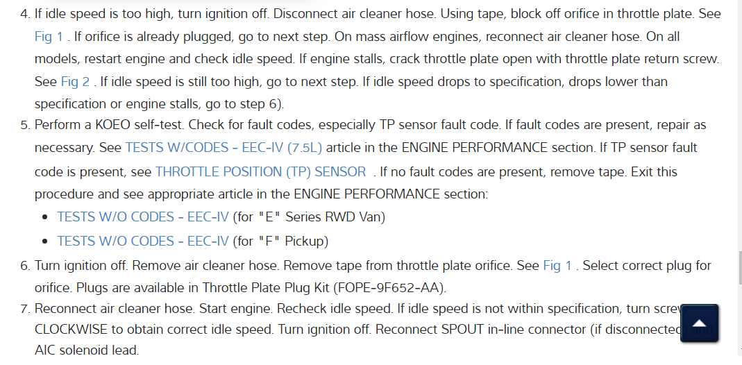

In the diagrams down below I have included the factory guides for timing adjustment, idle adjustment and a guide for retrieving the Direct Trouble Codes (DTC)(s) from your vehicle without having to use a code reader. Please go through these guides and get back to us with the DTC(s) that you get and we can go from there.
Thanks,
Alex
