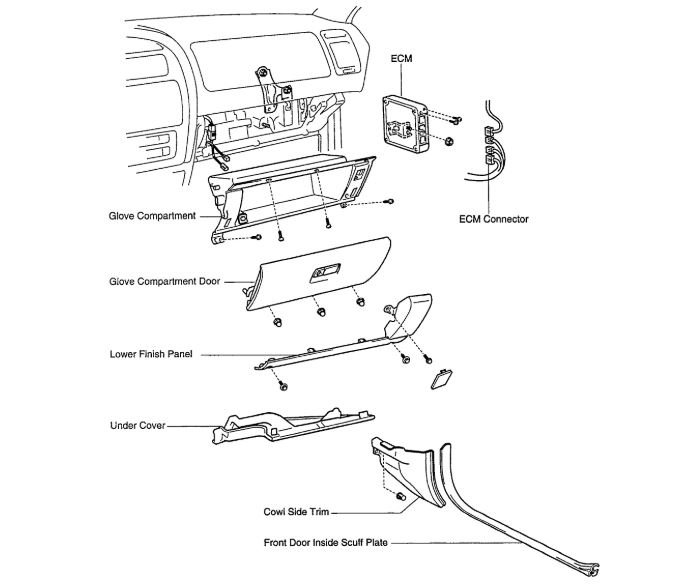

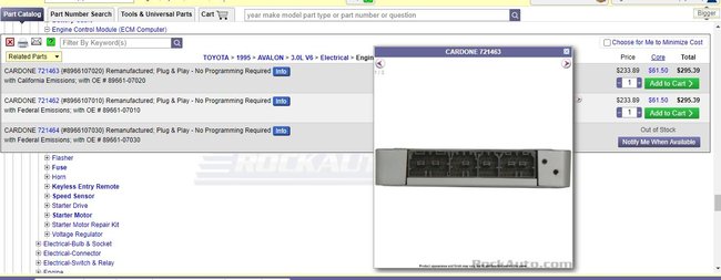

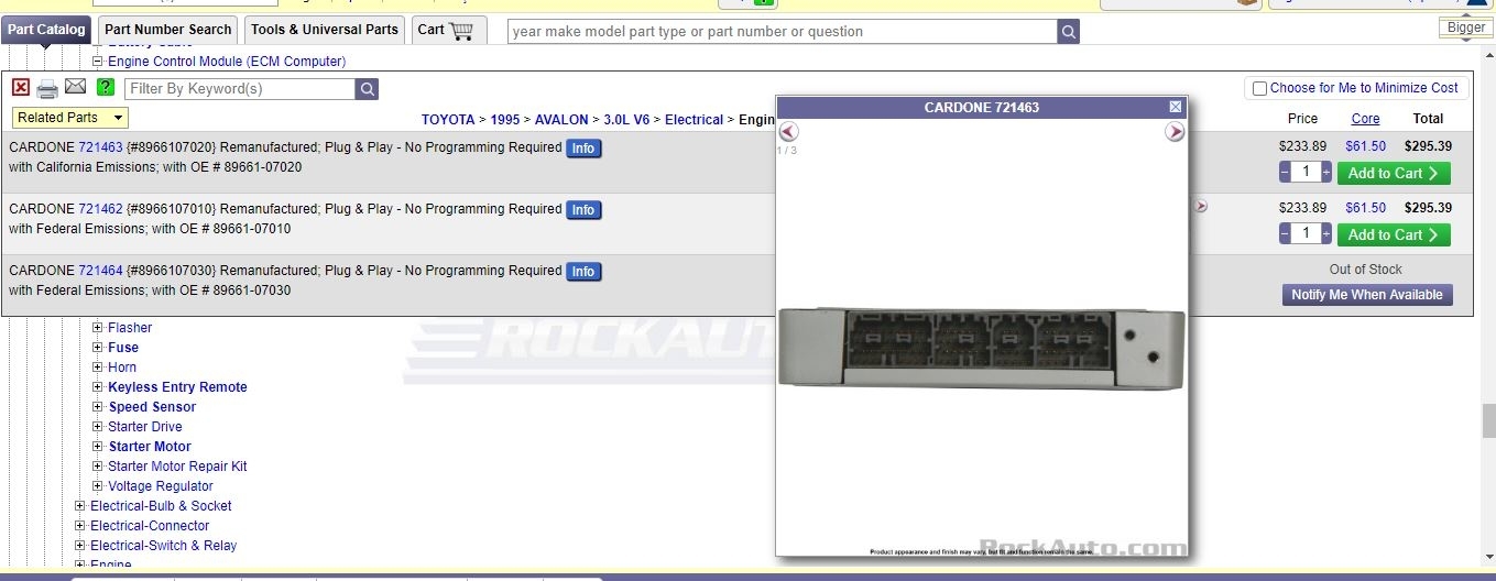

I attached the replacement from rock auto for you.
The ECM is a plug and play. No programming required at all.

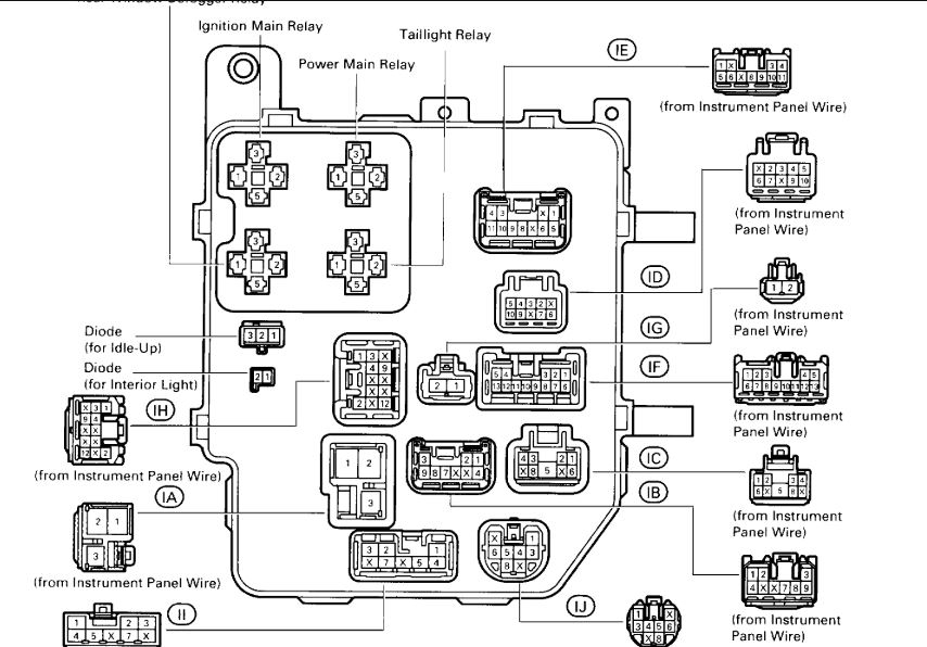

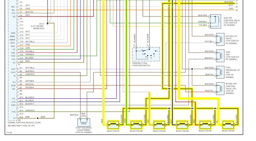

So, I understand that the ground wires for the fuel injectors are connected to the ECM and the ground wires for the ignition coils are connected to the igniter. While power is supplied by a 7.5 amp fuse in the fuse box,, where exactly are the power wires for the fuel injectors and the ignition coils connected to? Also, where is the fuse box where power is being supplied? Is there an individual fuse for each power wire or is there just one fuse for all of the power wires? Thanks!
Jul 31, 2020 at 11:27 AM

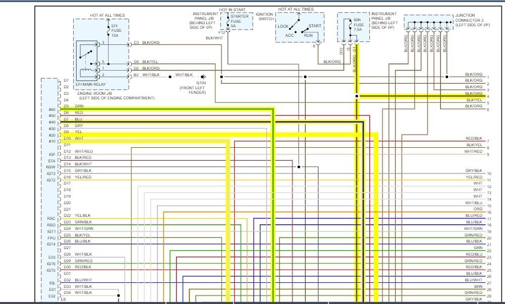

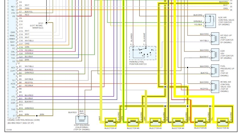

The power comes off a splice that feeds all the injectors.
I attached the diagram and location of the fuse block for you.
Test for power on both sides of the fuse.
Jul 31, 2020 at 12:05 PM
AVALON1995
  • 121 POSTS

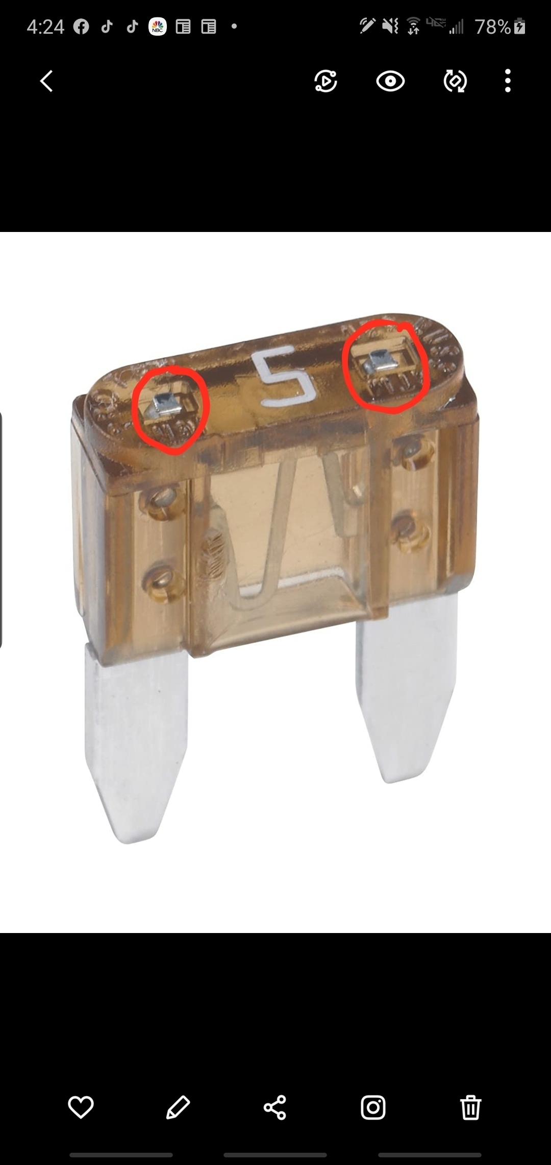

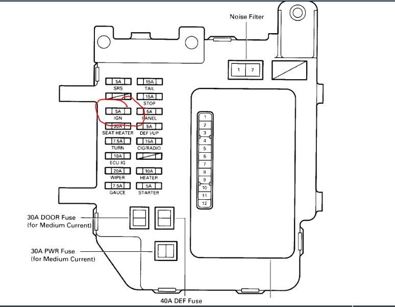

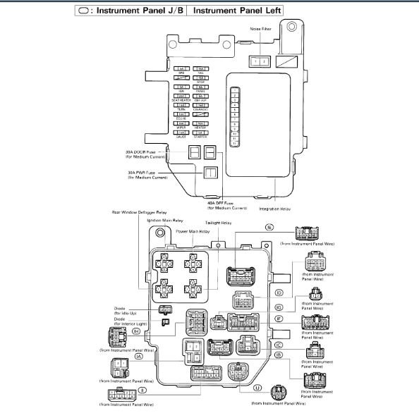

So, when you say test for power, do you mean the fuse you circled in red? Also,when you say both sides of the fuse, are you referring to what I circled in red in the attached picture? Apparently it's a 5 amp fuse, not 7 5 amp. Is there a way you can resend a better version of the picture you sent on the left? It's really not legible. The one on the right is great. Thank you!
Jul 31, 2020 at 1:35 PM
Yes, test the terminals circled with a test light with the fuse installed, key on with a test light.
Attached the enlarged picture.
Jul 31, 2020 at 1:43 PM
AVALON1995
  • 121 POSTS
I think you forgot to attach the picture.
Jul 31, 2020 at 2:10 PM
Sorry, I did but I failed to verify it.
Jul 31, 2020 at 2:18 PM
AVALON1995
  • 121 POSTS
Where is this fuse box for the last picture you sent located? I know where the other fuse box is located, the one where you had circled.
Jul 31, 2020 at 2:47 PM
