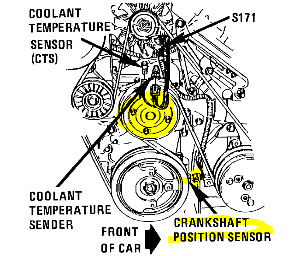

Based on what you described, if there is a leak from the water pump, it could leak down onto the crankshaft position sensor. The sensor is behind the crankshaft pulley, right below the water pump. See pic 1
Do me a favor. Check that area for evidence of a leak. Also, take a look through this link and let me know if the symptoms seem to mirror what you experience.
Also, here is a link you may find helpful when looking for the leak:
https://www.2carpros.com/articles/car-is-leaking-coolant
See pic below.
