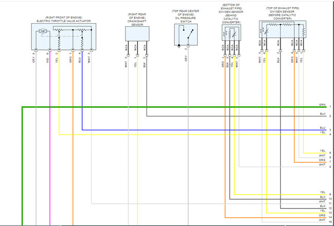

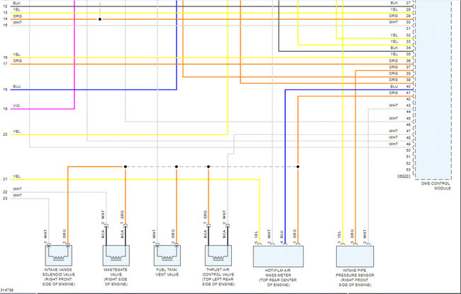

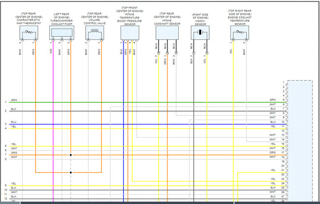

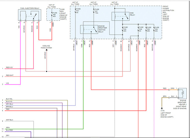

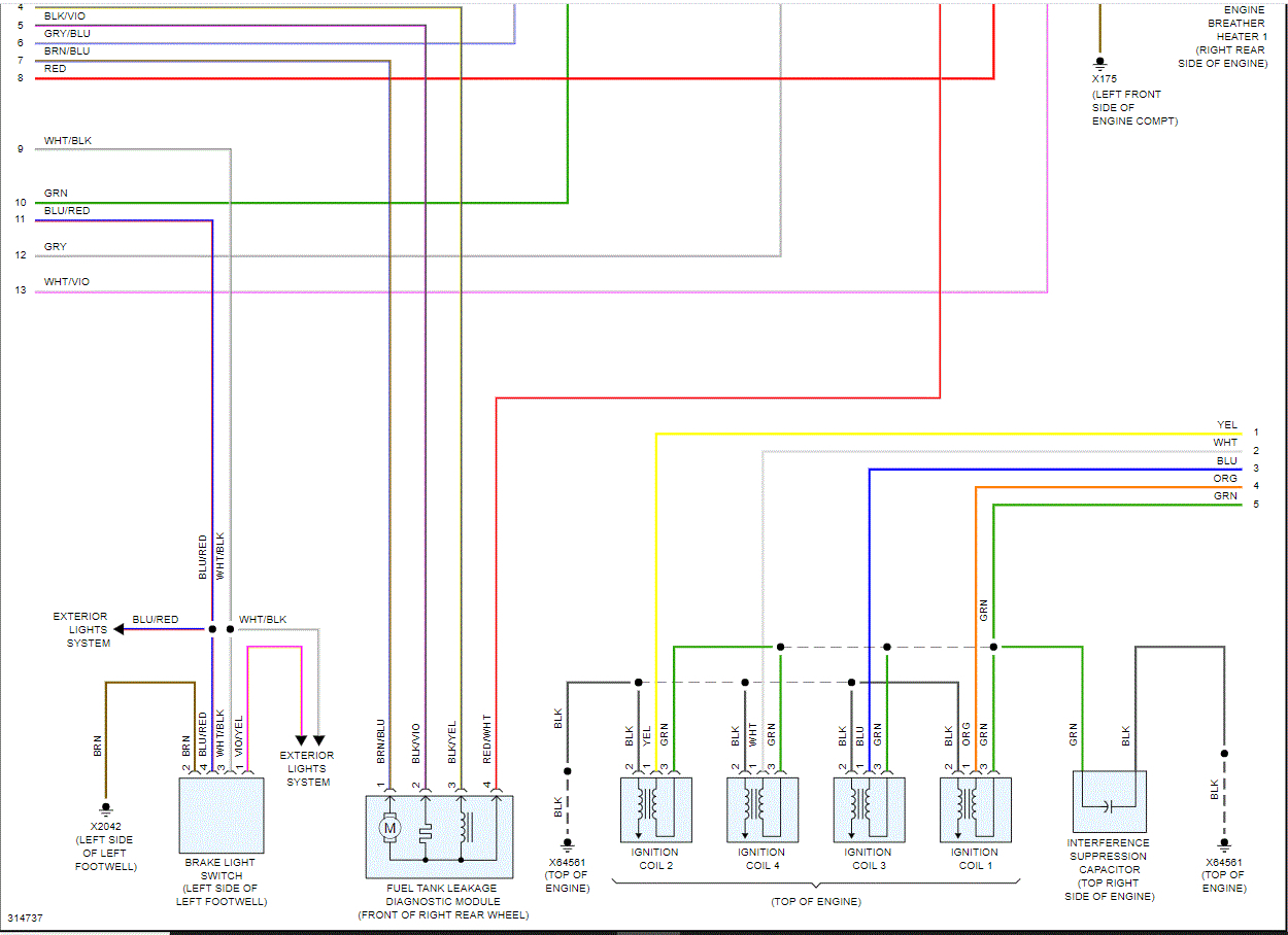

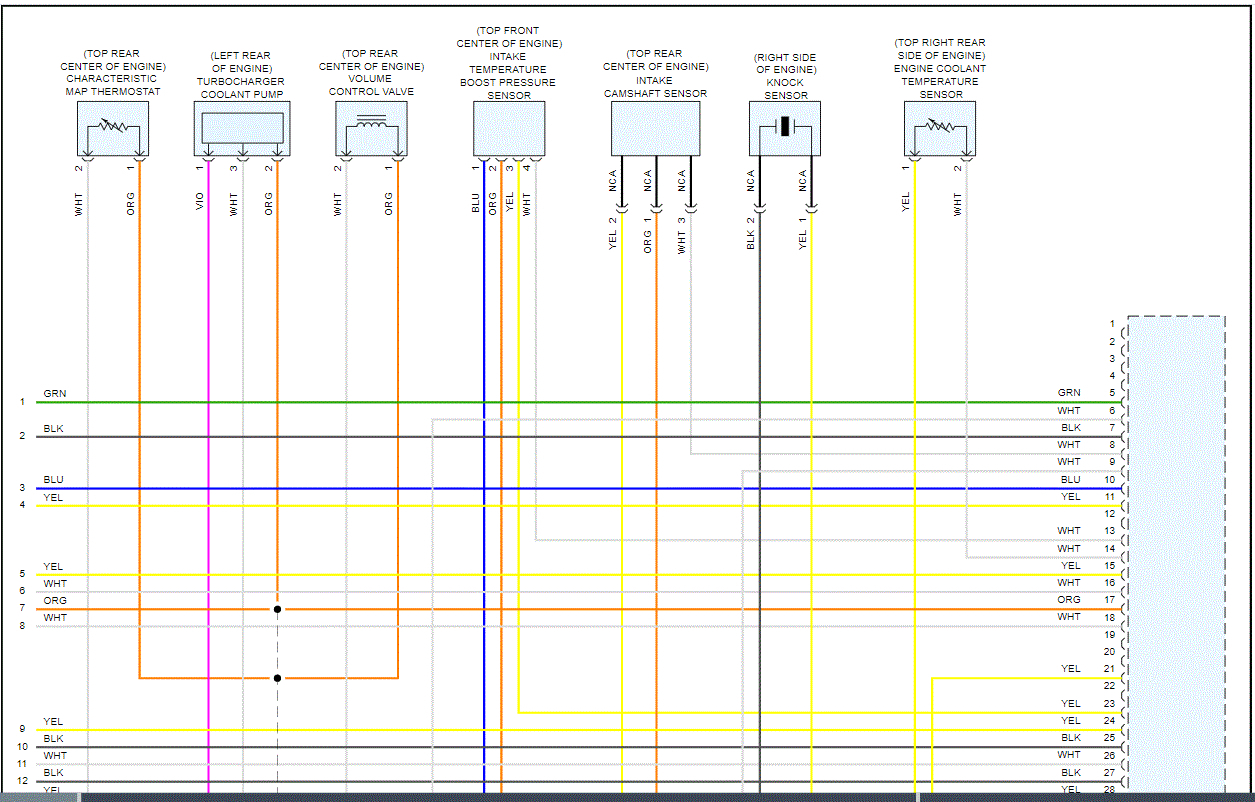

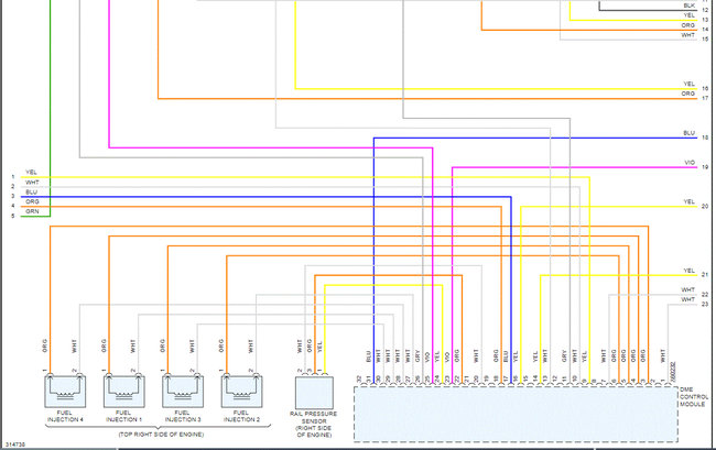

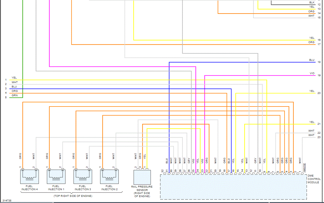

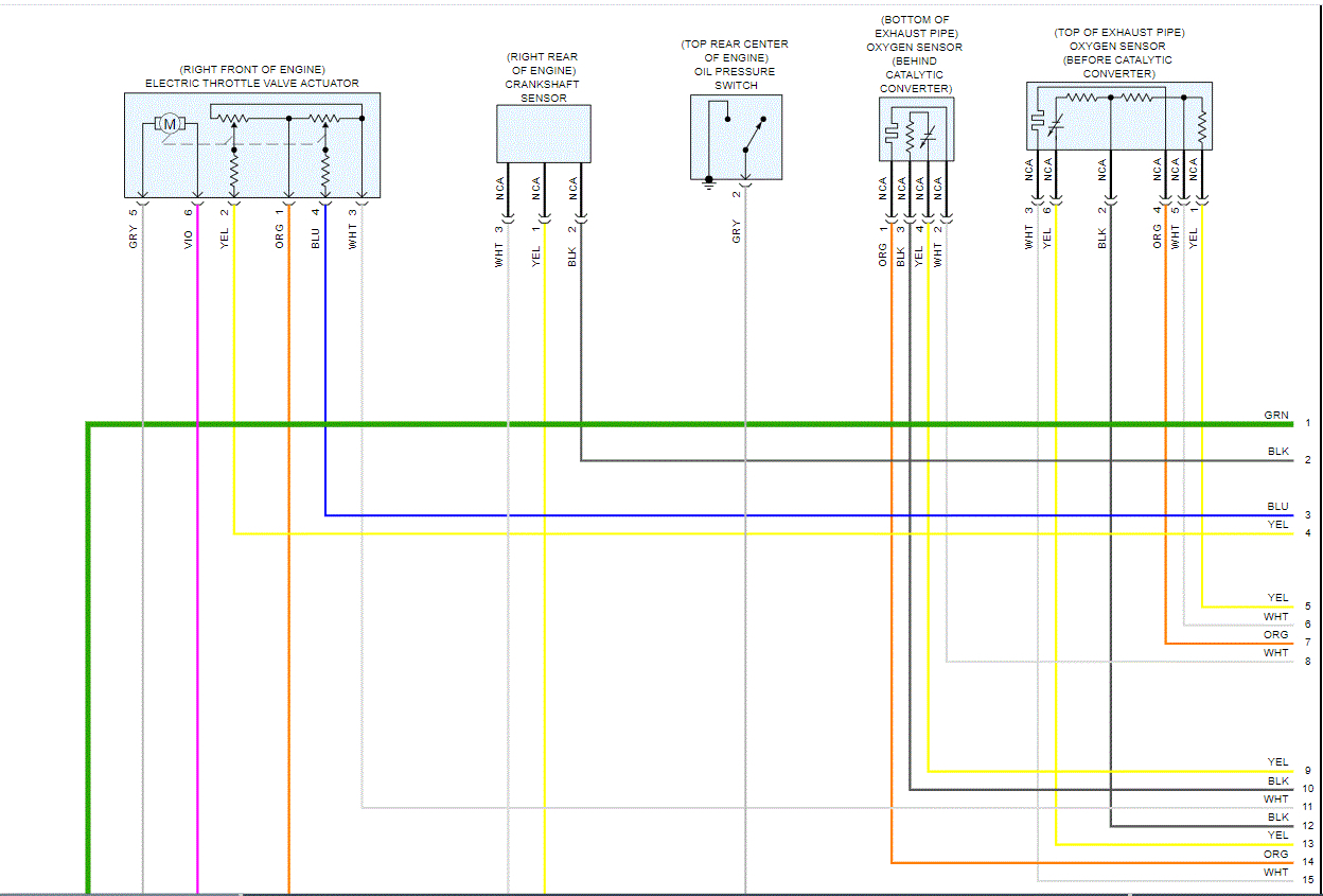

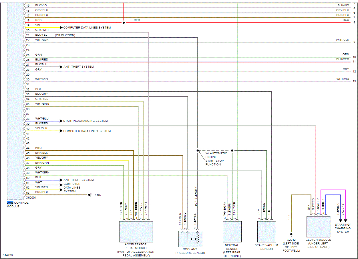

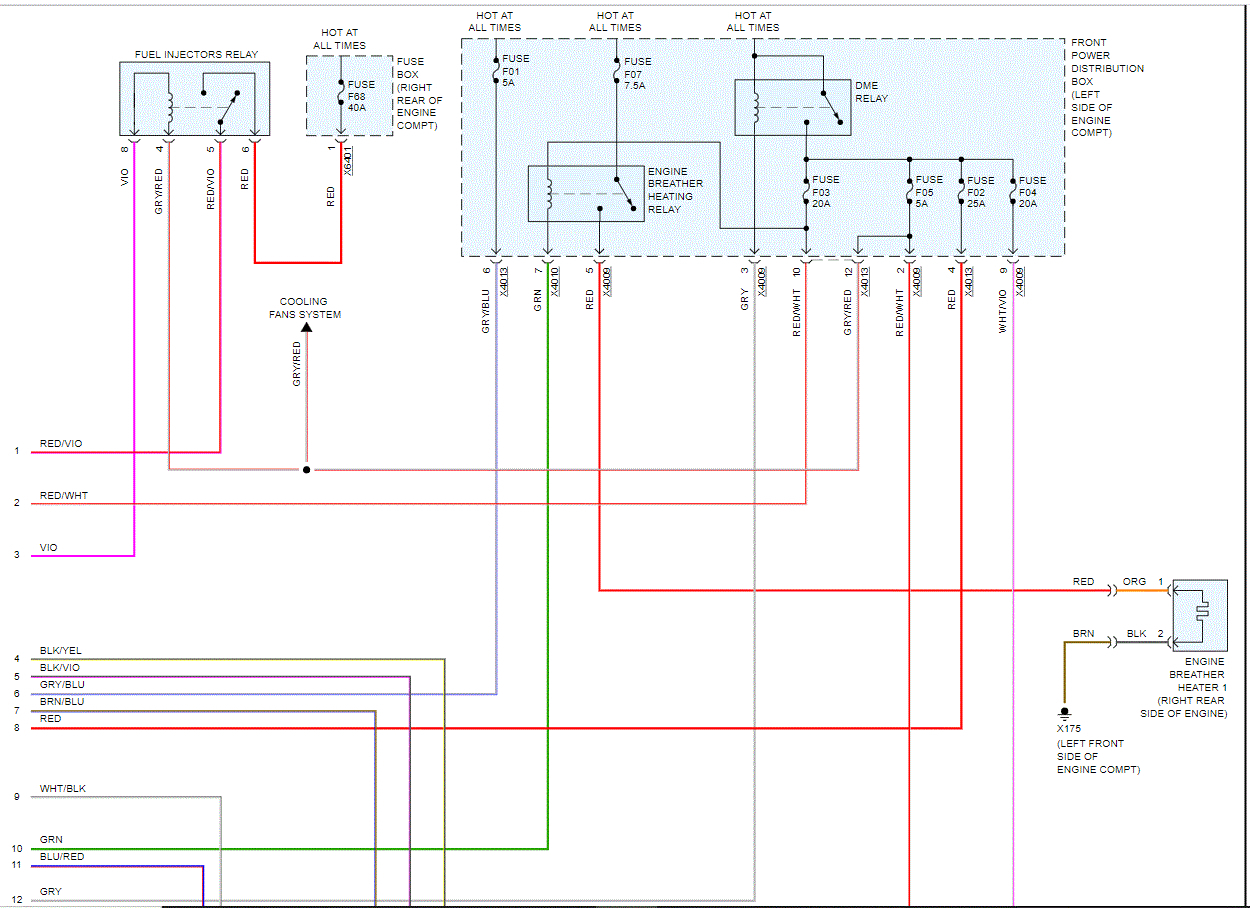

Below, I attached the entire wiring schematic for the powertrain management. I had to cut the pics in half to make them readable, but I did overlap them so you can easily follow from one to the next.

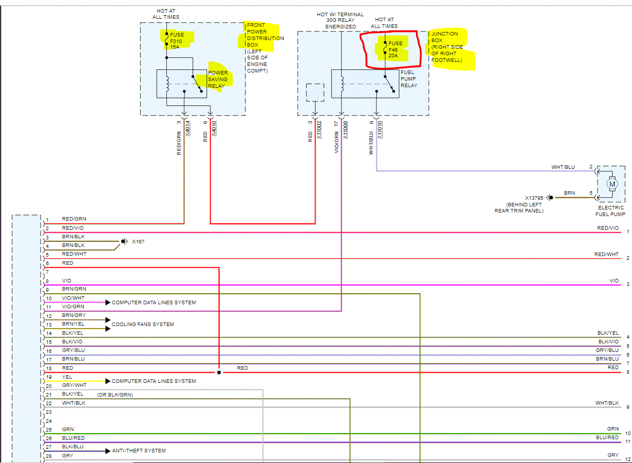

In the first pic, I highlighted two fuses. One is in the vehicle (fuel pump) which I circled and the other is under the hood related to the engine off timer, which again isn't making sense considering what was done.

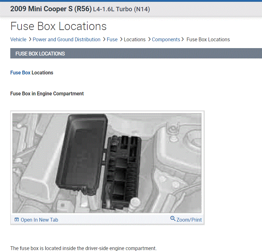

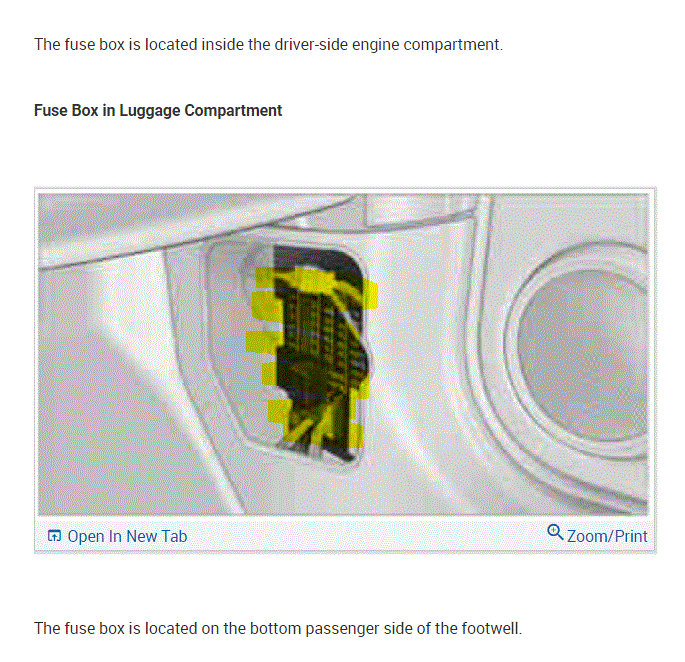

Also, since you pulled the carpet to dry it, make sure nothing was knocked loose at the interior fuse box. The last two pics show the fuse boxes locations. I can't be certain, but I suspect the problem is in the interior passenger side fuse box.
See pics below.
