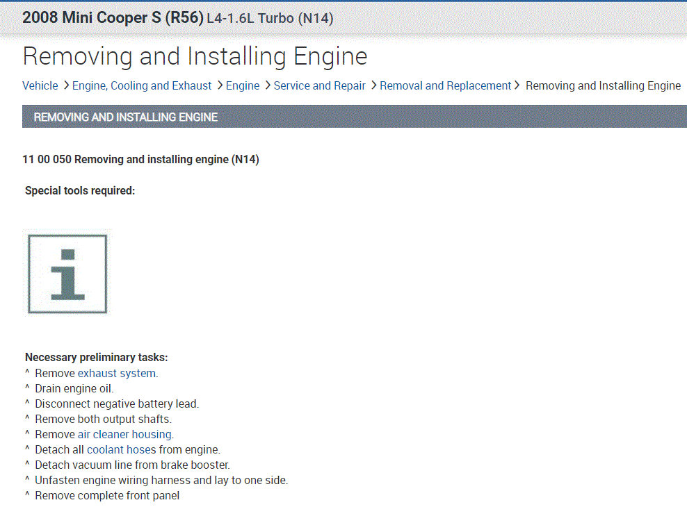

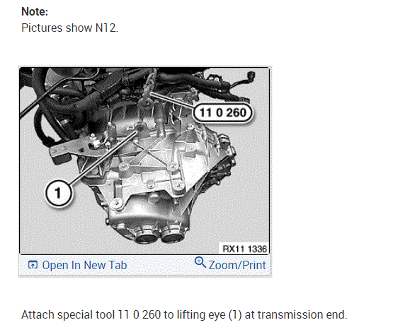

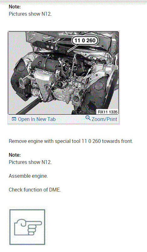

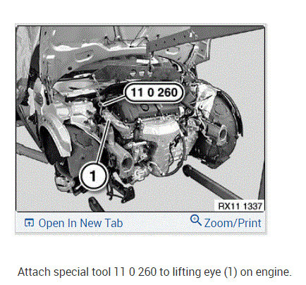

I noticed we haven't heard from you for a couple of days. Has any progress been made? Have you found an engine?
I also noted that you requested directions for removal and replacement. I attached the directions in the pics below. I hope they help.
Let us know if we can help or if you have other questions.
See pics below.
