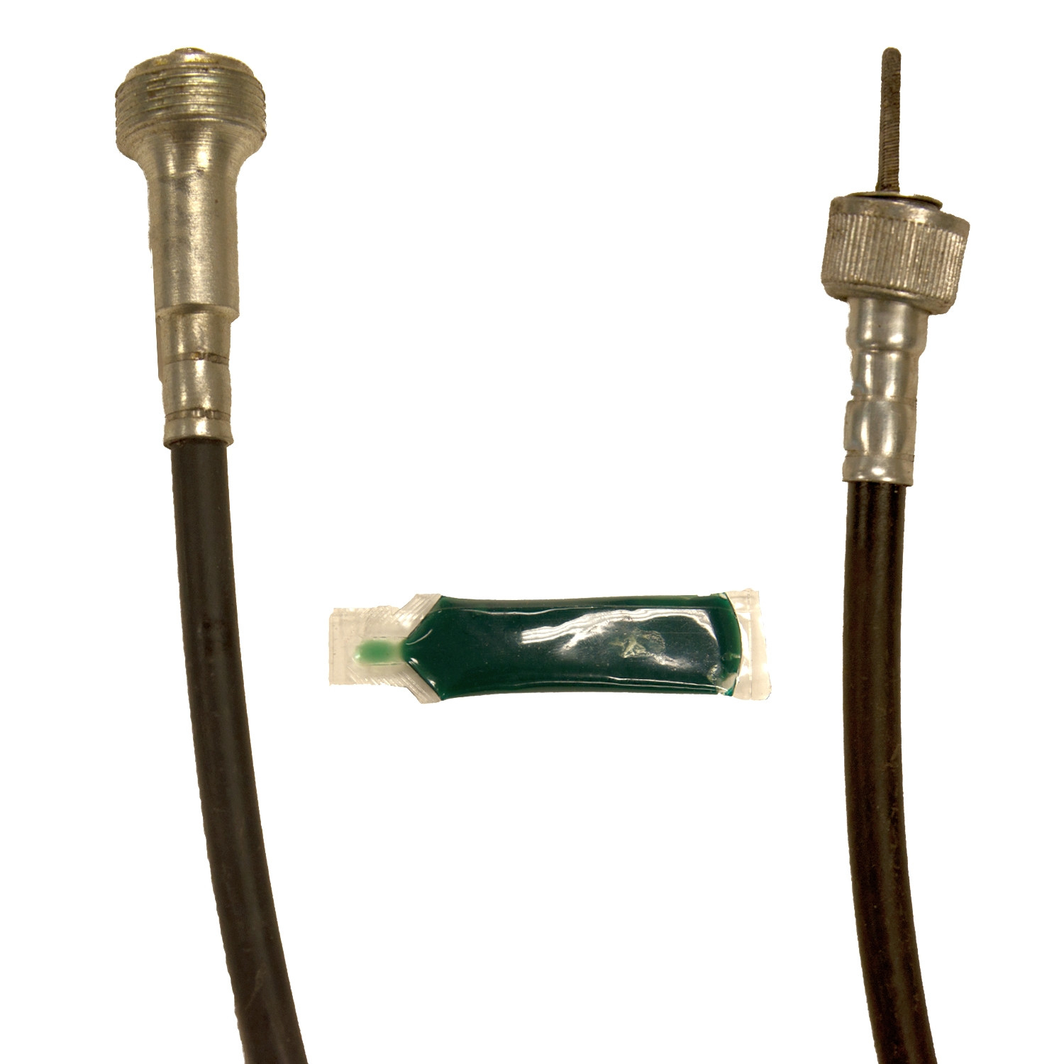

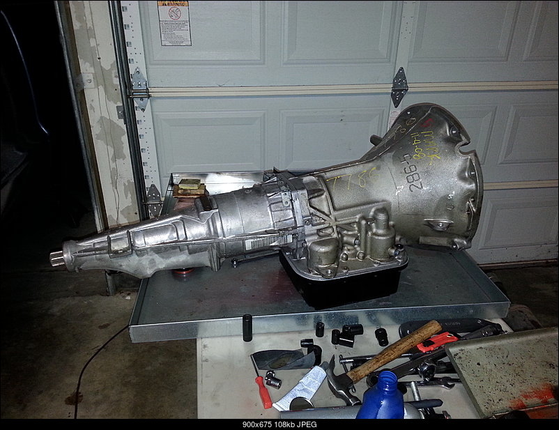

1) Speedometer gear in transmission.
2) Speedometer cable (two separate cables which join in the middle).
3) The speedometer itself.
The most common problem with these vehicles is the cable. If you live in an area where rust can be an issue, it is common for rust to damage the connector where the two cables join which leaves the cable partially disconnected. Thus, a ticking noise inside because the cable is not fully turning.

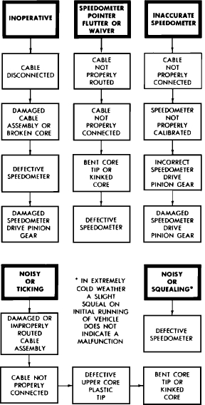

Here is what I suggest: Take a look at the flow chart I have attached. It is designed to narrow down the potential problems until you locate the problem. If you find you have additional questions, please feel free to ask. I am here to help.
