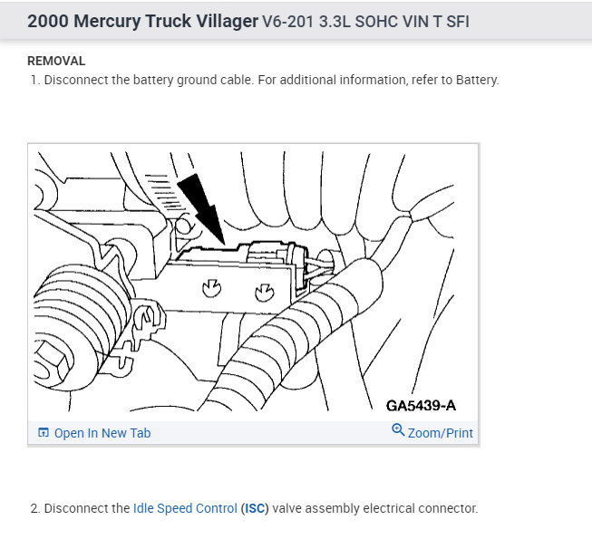

Hello 2CarPros,
I have a question for you. I have the vehicle listed above (van) with A/C. Here in the past couple of months, when I stop at a stop-sign or stop-light, while sitting still the car has a mild miss, but if I have the A/C running, then there is no missing at all. I have checked the spark plug wires, spark plugs, throttle body, and air filter. Any ideas on what I should check now?
