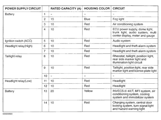

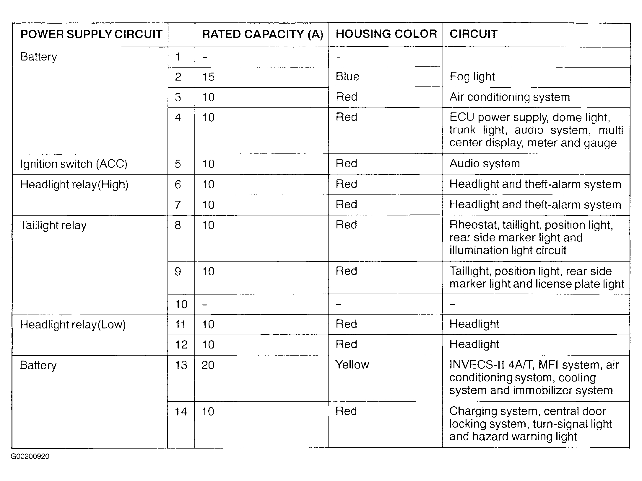

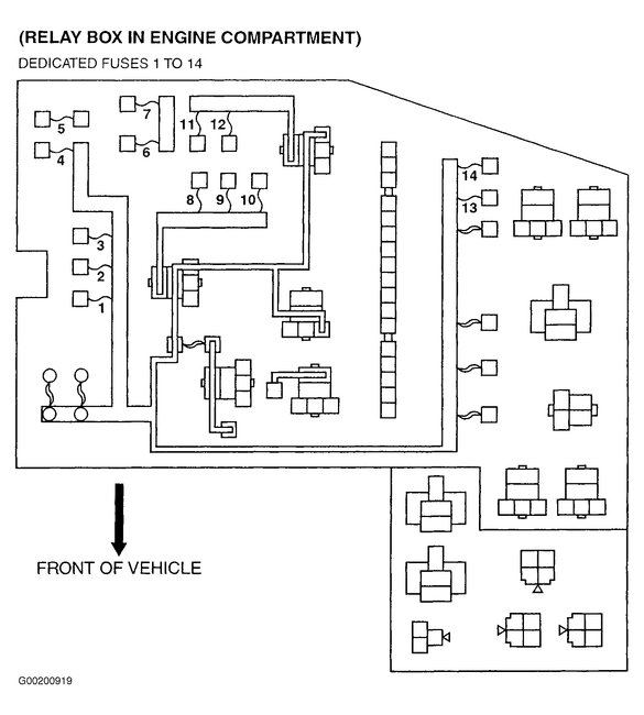

If you still do not hear the pump come on, then you need to check the fuses. There is a fuse box diagram attached below. The fuse box to look at is the one that's under the hood, along the left side. In particular, look at the fuses for "fuel pump", "ECM/TCM," "PWR Train," and "ENG Ign."

If the pump is coming on, the next easy thing to check is for sparks. You can do this with a tester that is available at AutoZone or any other auto parts store. Here is a link for one on Amazon: https://www.amazon.com/Lisle-20610-Inline-Spark-Tester/dp/B0002STSC6/ref=sr_1_3?ie=UTF8&qid=1501325755&sr=8-3&keywords=spark+tester
Basically, you pull the plug wire off of the ignition coil (also pictured below) and plug in this tester between the coil and the plug wire. Then get someone to turn the key while you observe it. If it flashes, then you have spark. Check all of the cylinders.

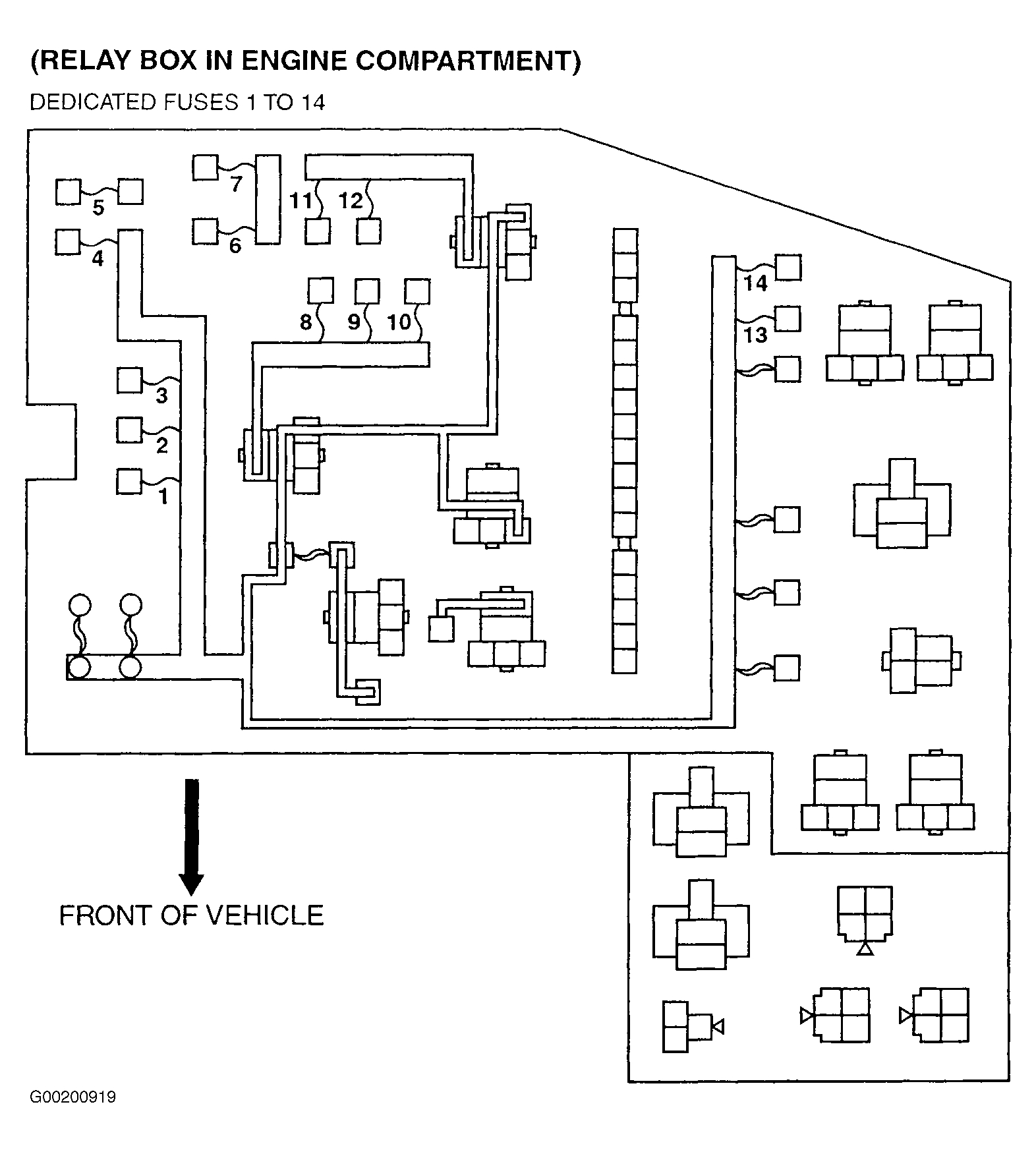

Exactly what are you getting at the MFI relay? And have you inspected the wiring to the relay itself? It is possible that it is burnt or that there is a short somewhere along the way. I would check for continuity between the lead and the ground to check for that short. Any resistance less than infinity indicates a short in the wiring. I would also check for continuity between the terminals of the MFI relay itself. Again, resistance of less than infinity indicates a short.
Number 13 in the image below is what you want to check. I would go ahead and change it out, as sometimes (rarely but occasionally) a visual inspection looks good but the fuse is no good.

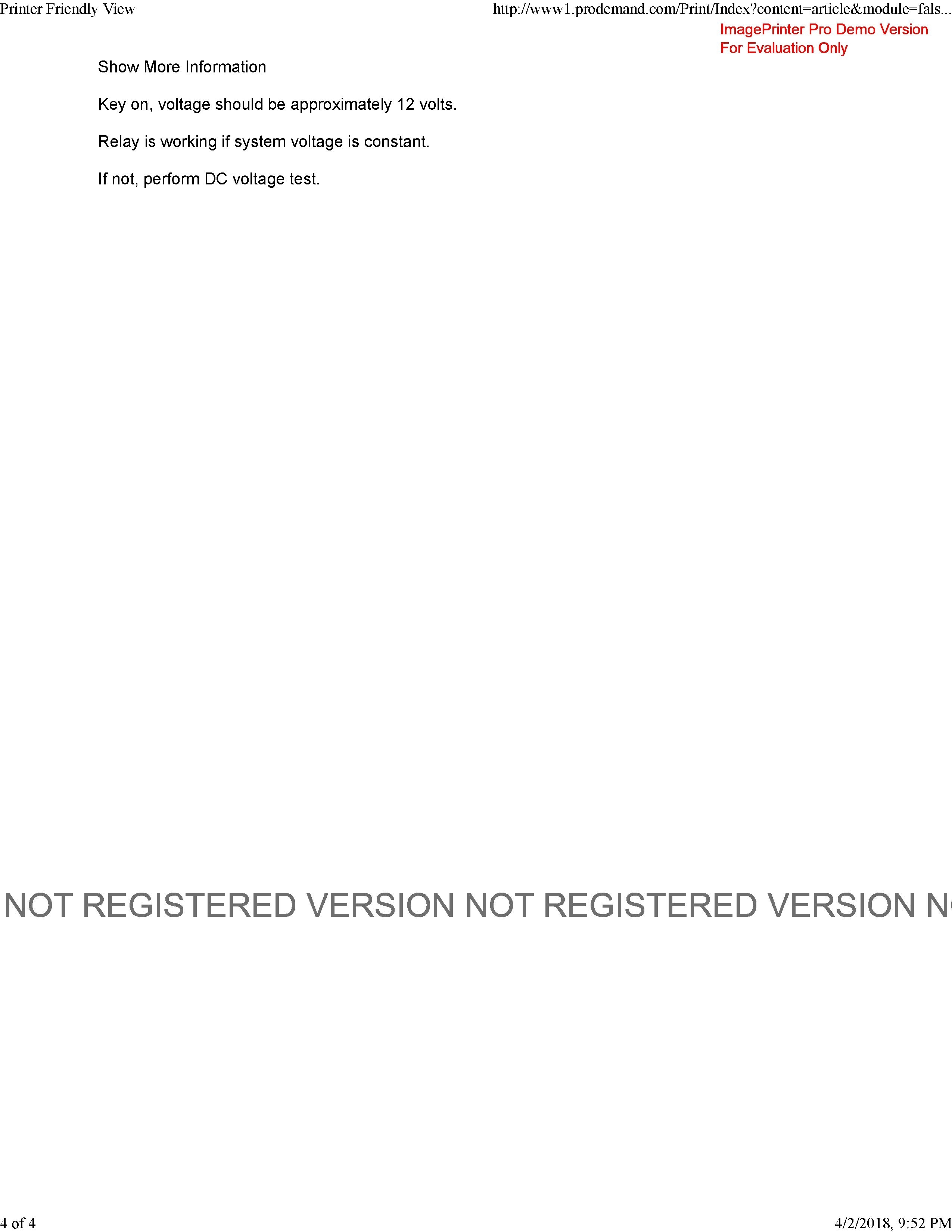

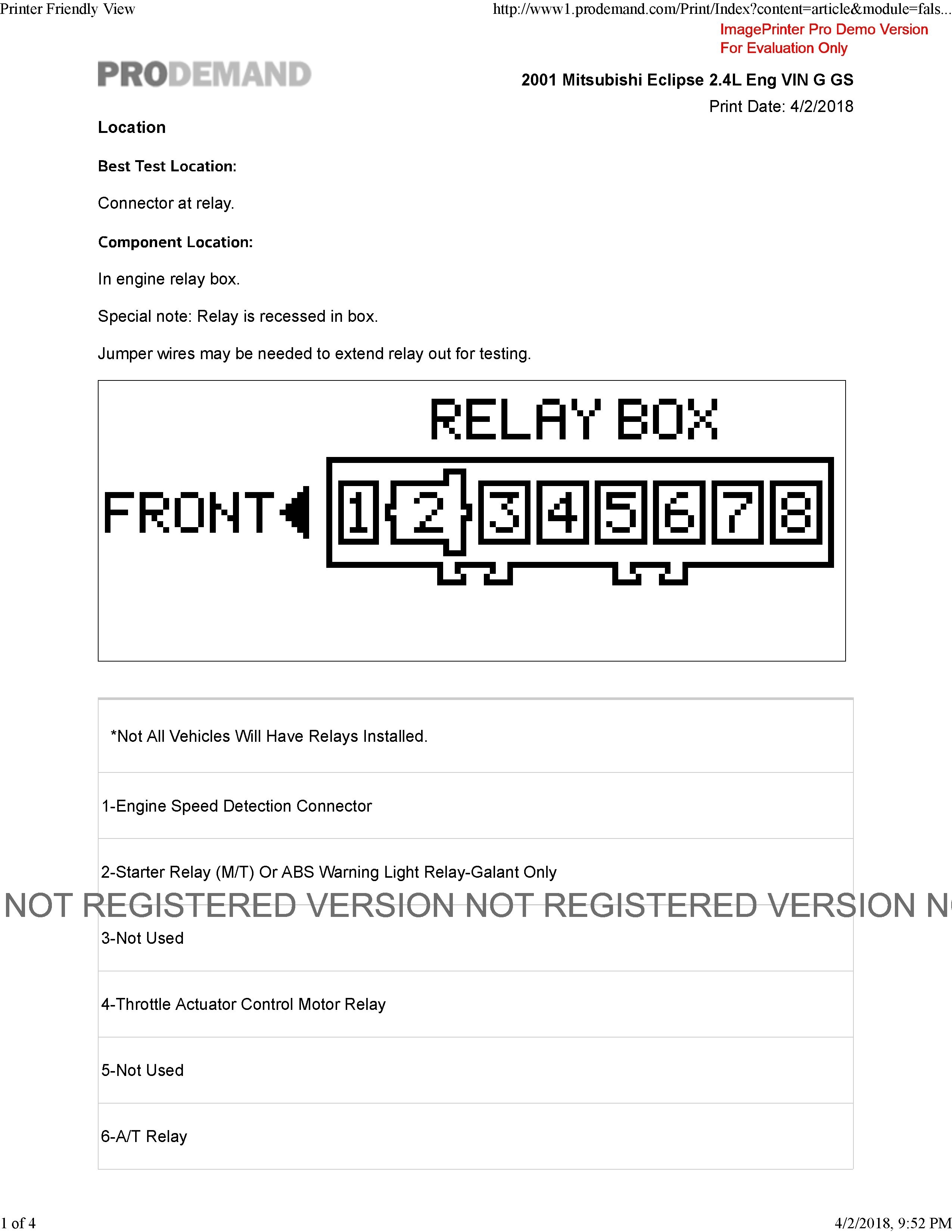

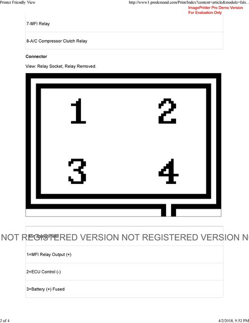

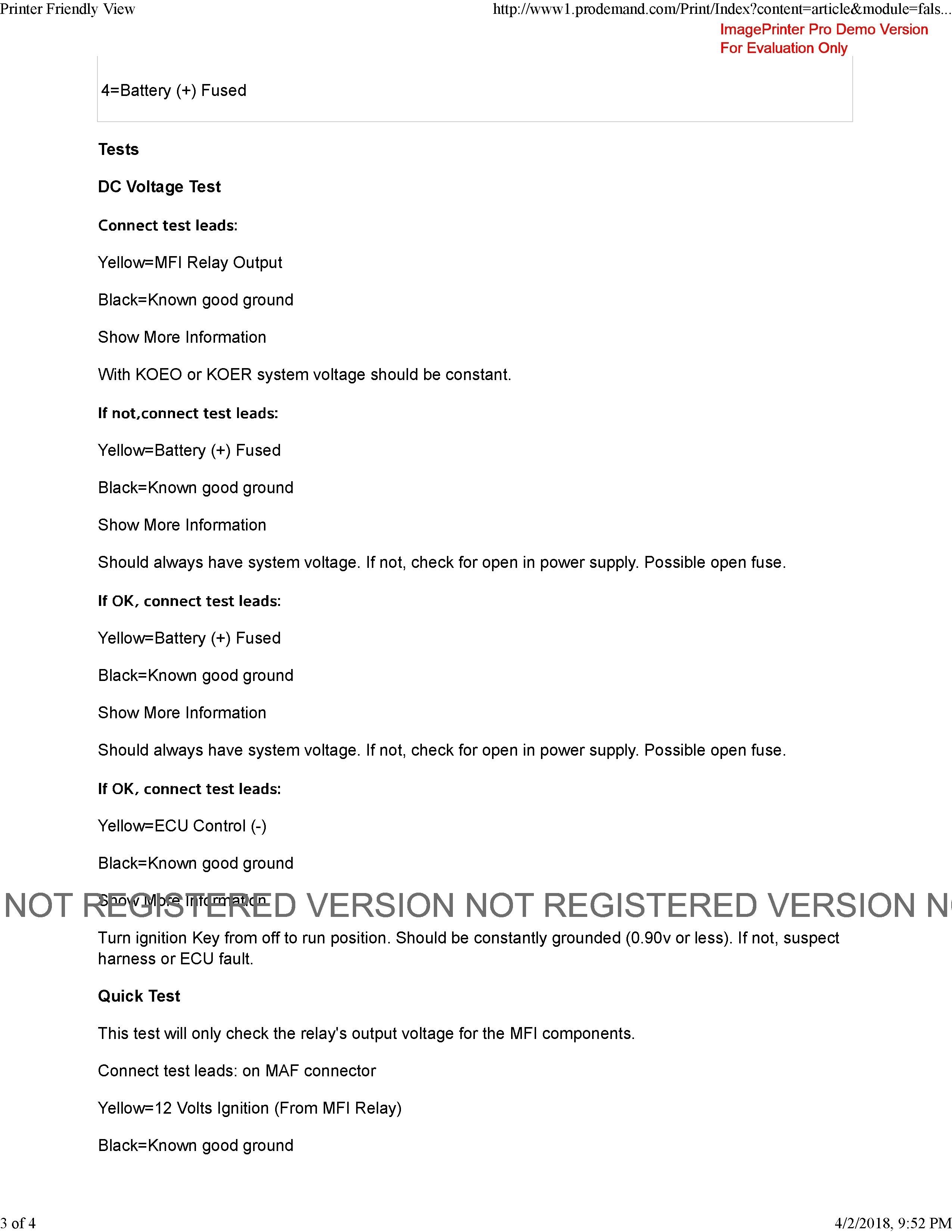

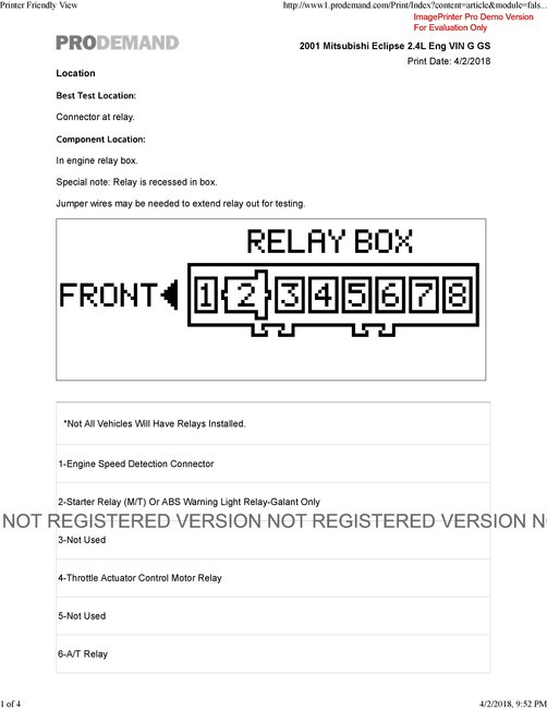

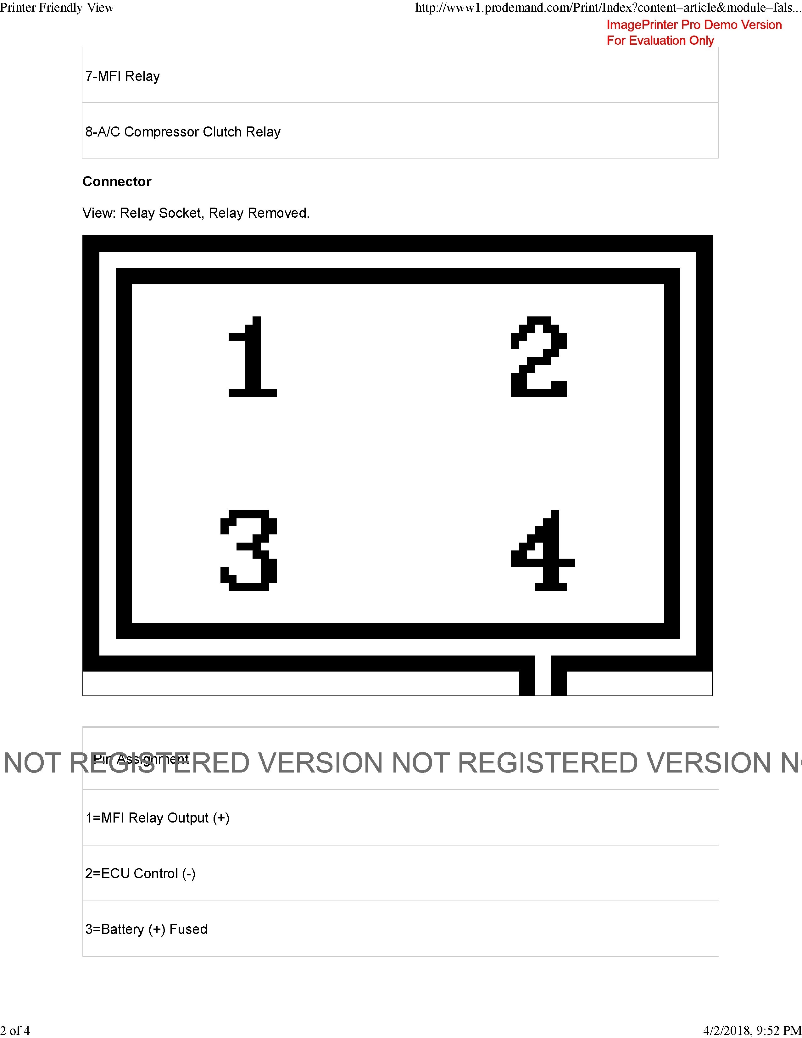

Okay, here is the information that we have on that MFI relay and testing. It does not say how much voltage should be getting there, just that it should be consistent. It also tells you how to test the relay.

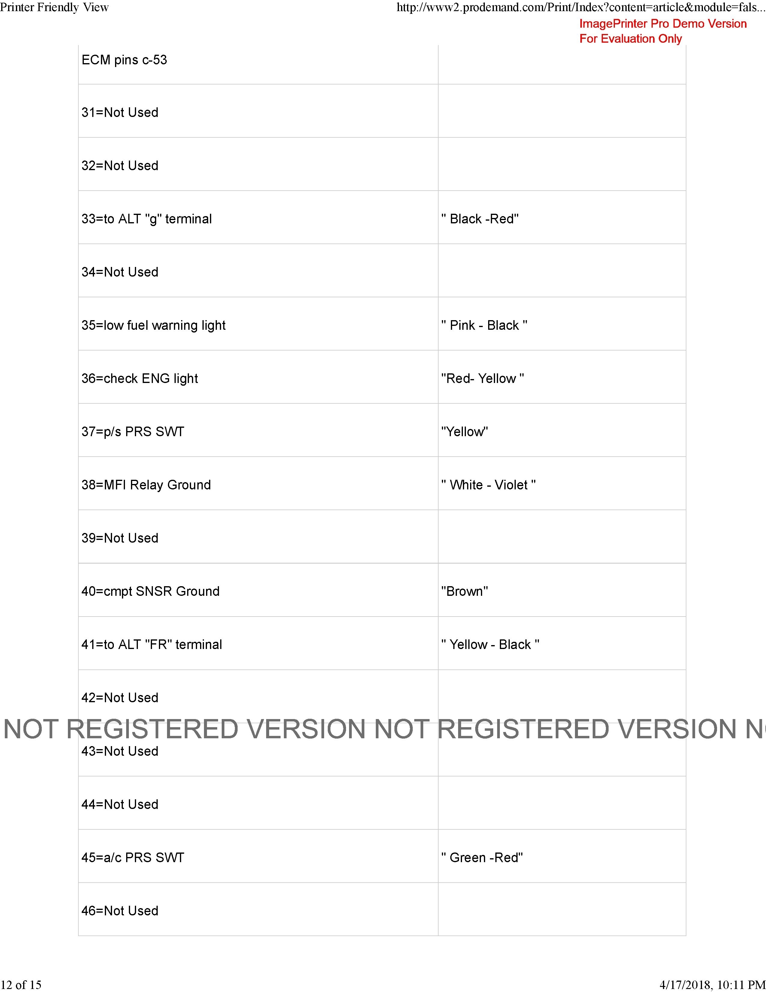

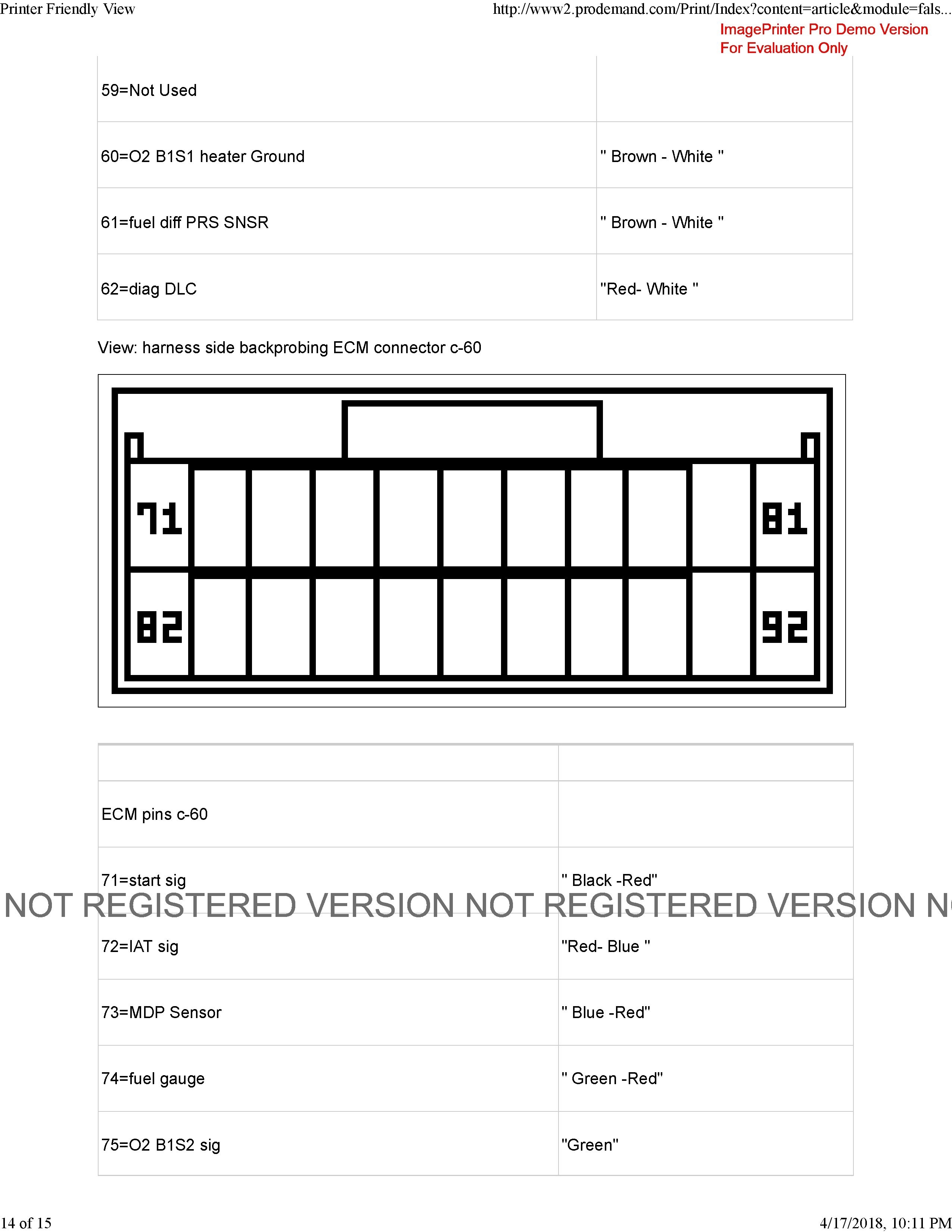

HARRY P
  • 2,292 POSTS

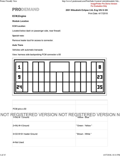

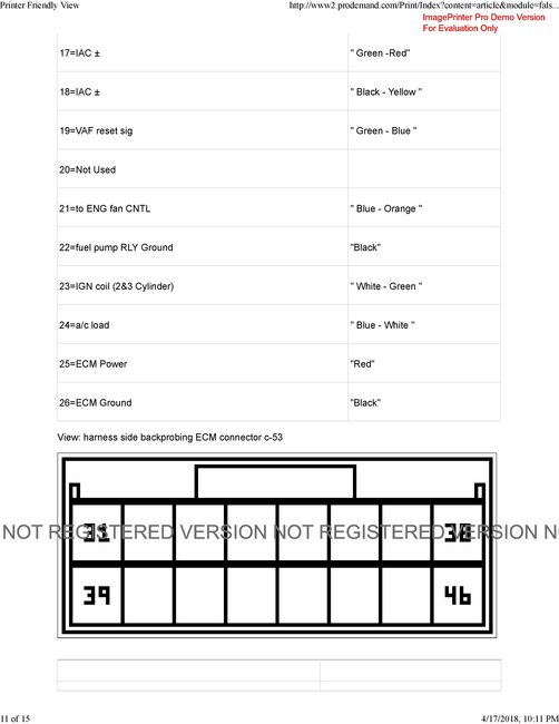

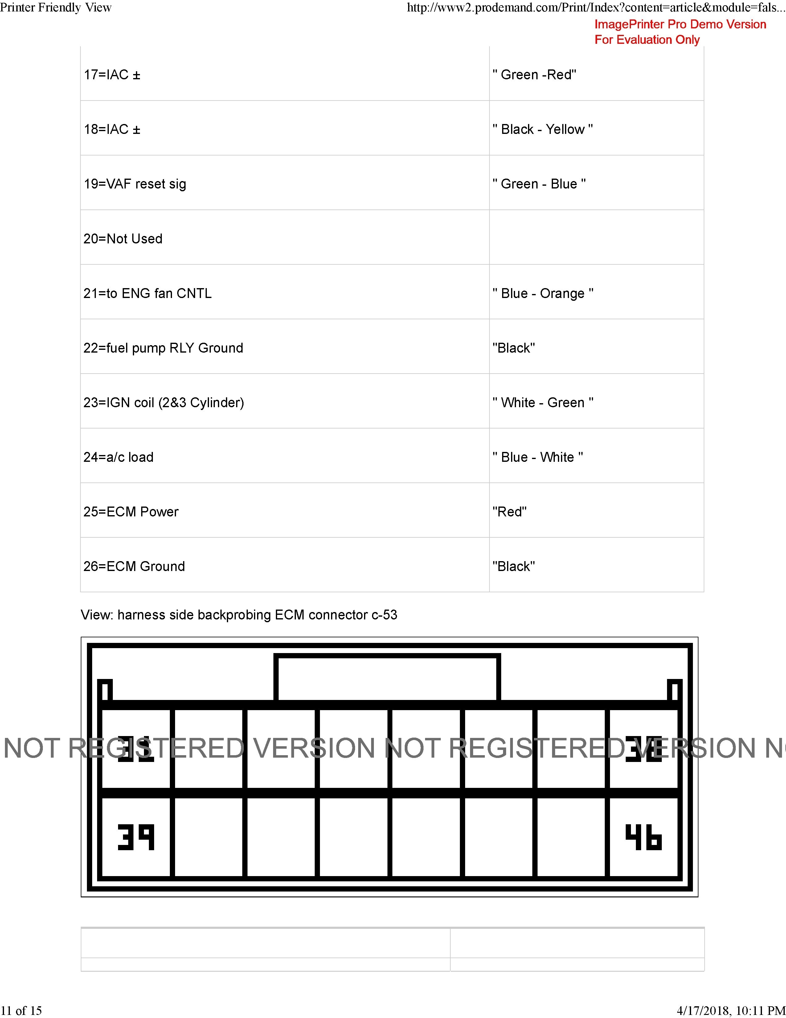

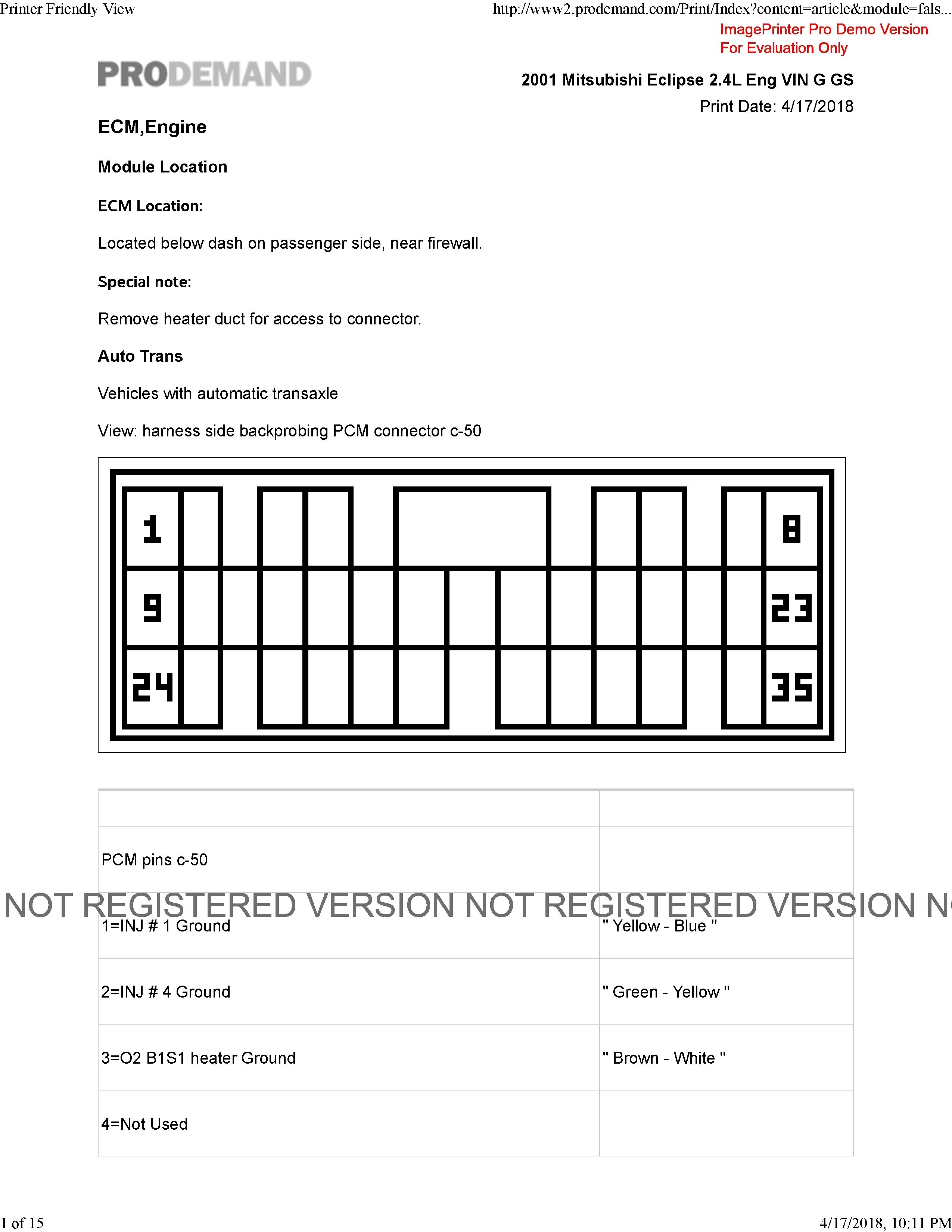

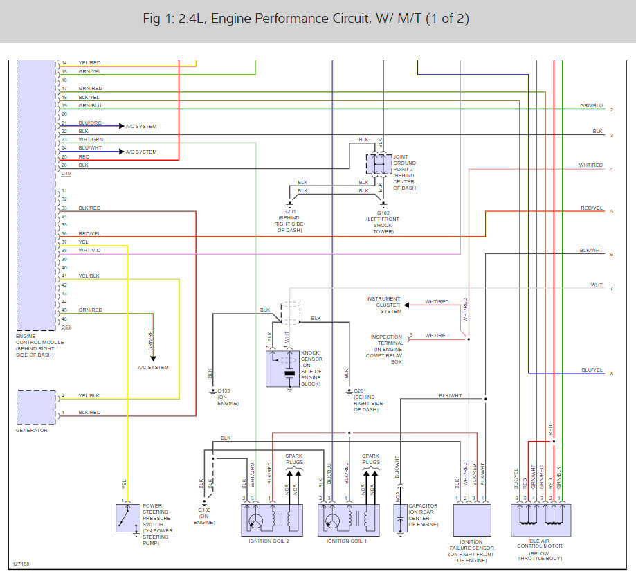

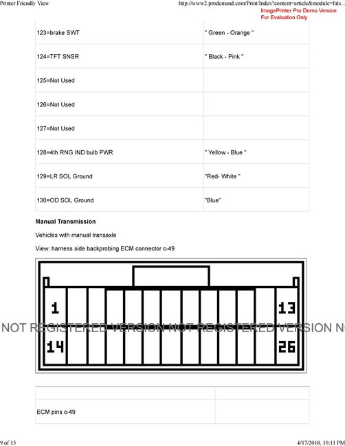

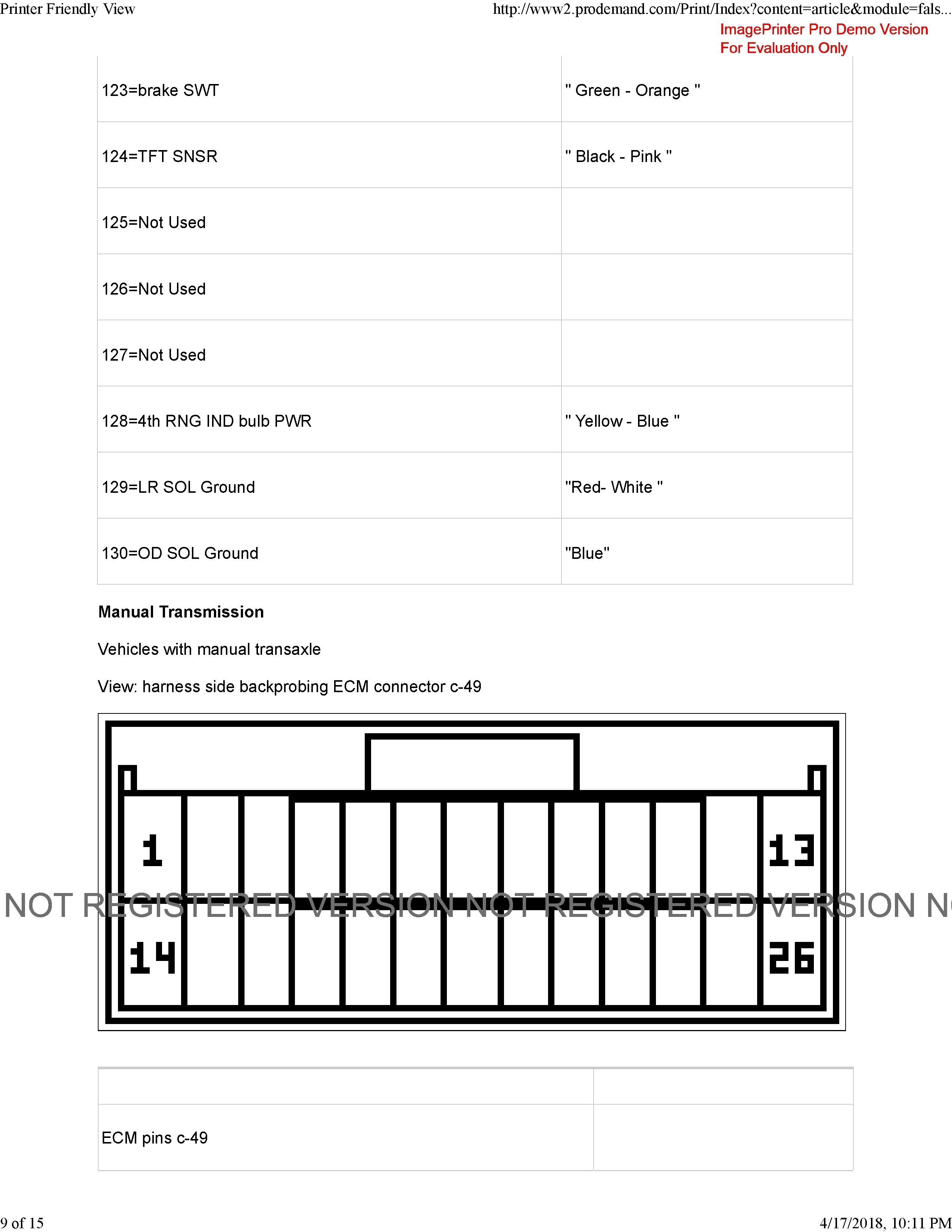

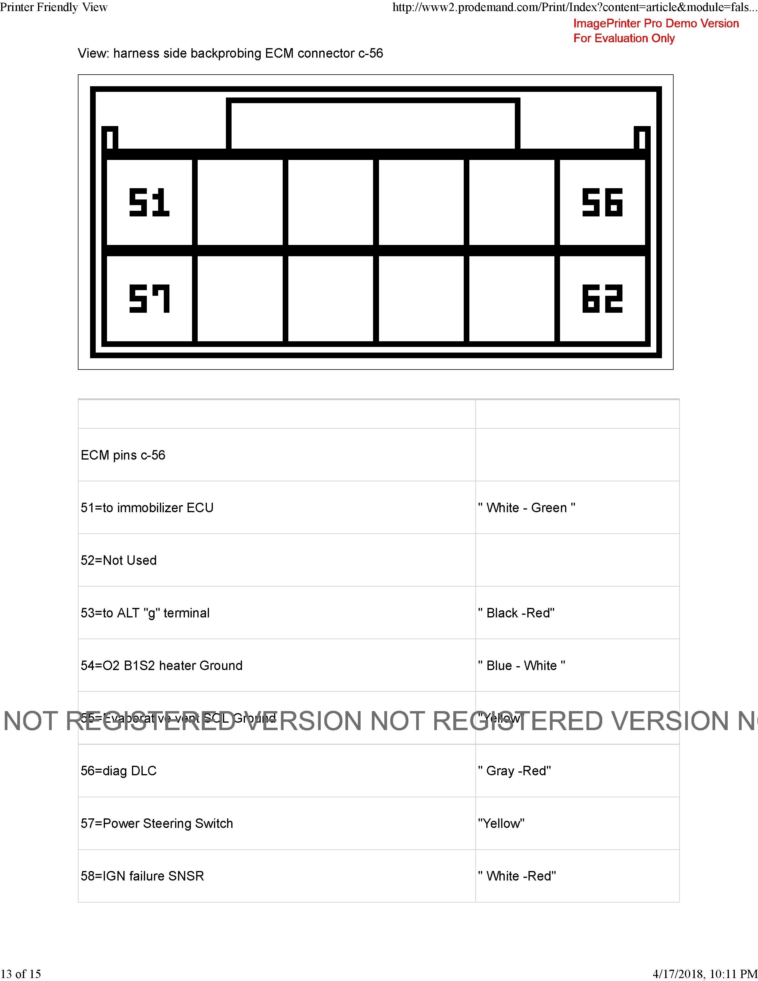

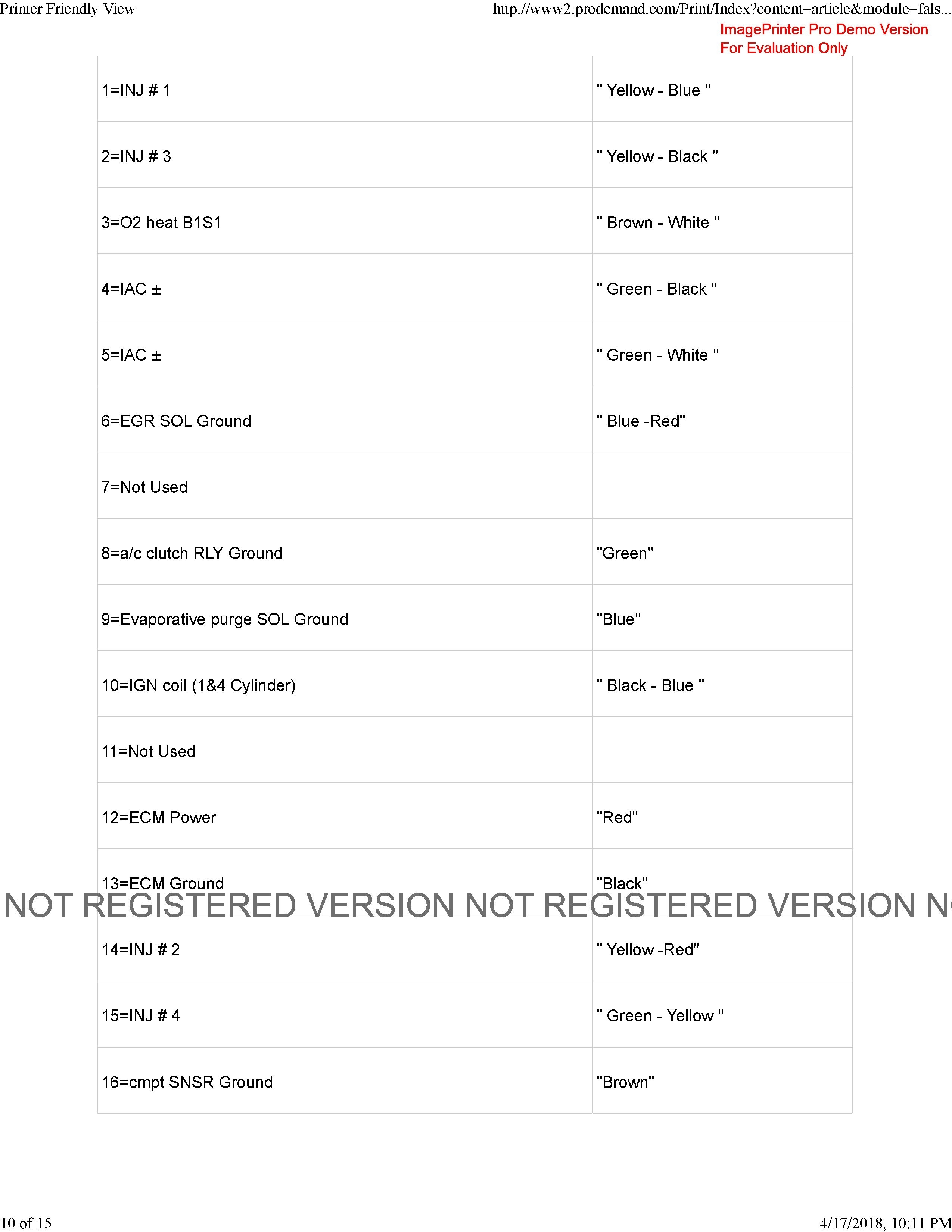

I do not think it will require programming. Just make sure that you get one with the exact same numbers on it. I am attaching Prodemand's info on the PCM. Pin #38 is for the MFI relay ground. You could probe that to see if the PCM is at least attempting to ground the MFI relay. If not, then replace it. If so, then the PCM is not your problem. Note: I skipped the info for the automatic transmission.

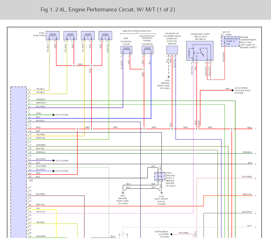

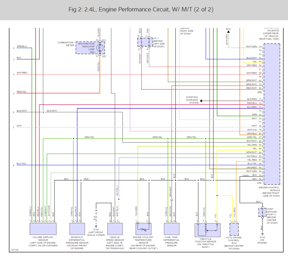

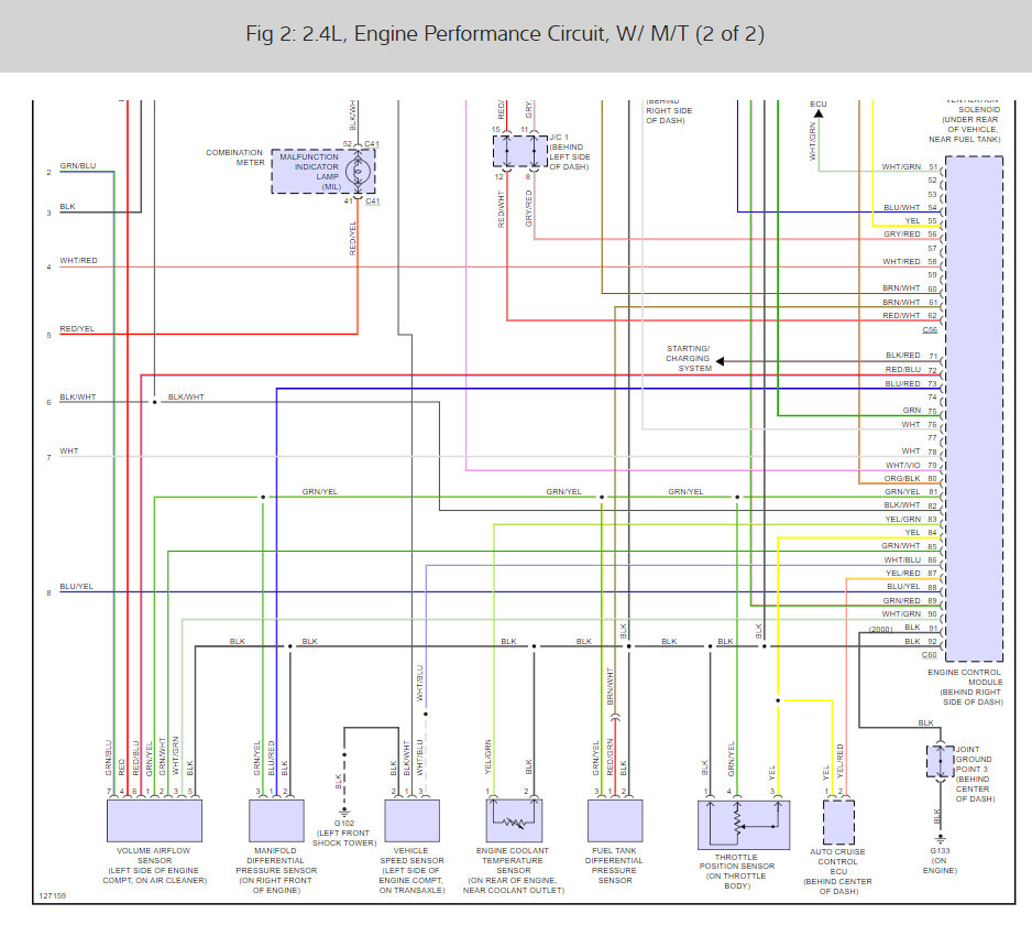

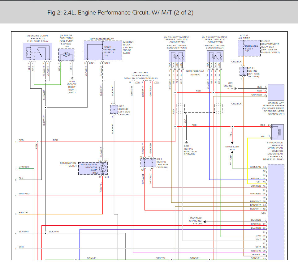

You will need to go over the wiring power ground and connection to make sure we do not have an open or shorted wire somewhere. Here is a guide to help you get the job done:
Check out the diagrams (below). Please let us know what you find.
