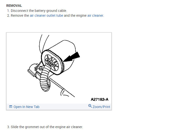

Cleaned mfa and throttle body new filter . Started fine ran a short distance shut car off went back out fine 5 blocks down road stopped running, didn't want to start back up. Kept trying started wanting to die used 2 footed made it home barley coasted into drive with some strange sound.
Nov 7, 2020 at 8:50 AM

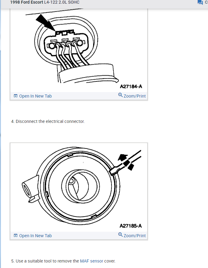

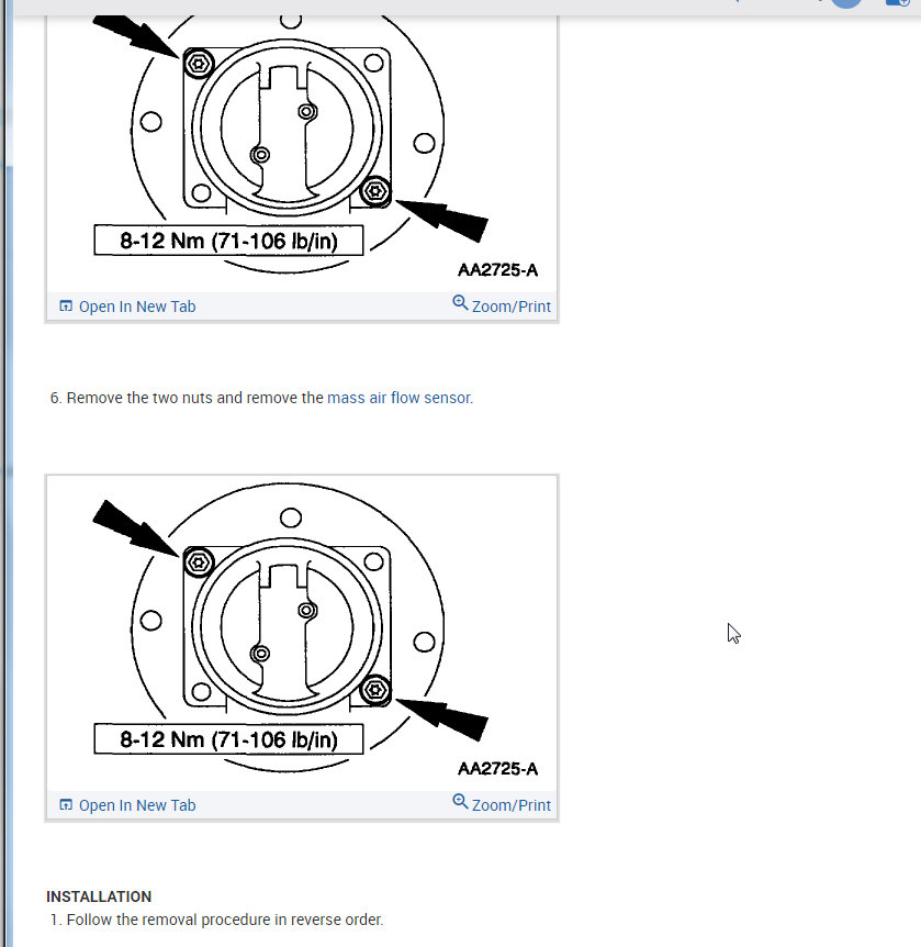

When you cleaned the MAF did you follow this process?
https://www.2carpros.com/articles/mass-air-flow-service
If not, I suspect the sensor is damaged and not reading the air properly that is coming into the engine. If this is all that you did, I would start with checking for codes and then replace the MAF if nothing else comes up.
