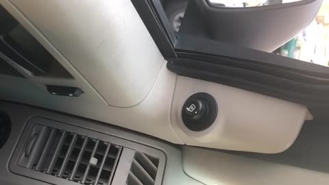

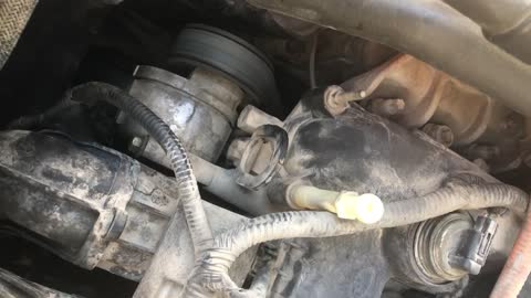

That click sounds like your A/C compressor clutch engaging and disengaging which is normal as long as your a/c is performing good. Here is the official description of the modes of operation for your HVAC system:
The humidity sensor is used by the HVAC module to optimize the A/C compressor cycling for fuel economy while maintaining passenger comfort.
When the relative humidity inside the vehicle is low, passengers are comfortable at a higher air temperature. The A/C compressor can be shut down before the commanded temperature is reached to increase fuel economy while maintaining passenger comfort.
