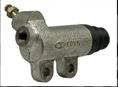

I see the issue you are having with this line. I am not seeing it either. However, I attached a picture of the slave cylinder below just to confirm we are talking about the line that threads into it?
If so, I would just make my own. You can get about 12 inches of straight brake line and then bend it and flare the other end.

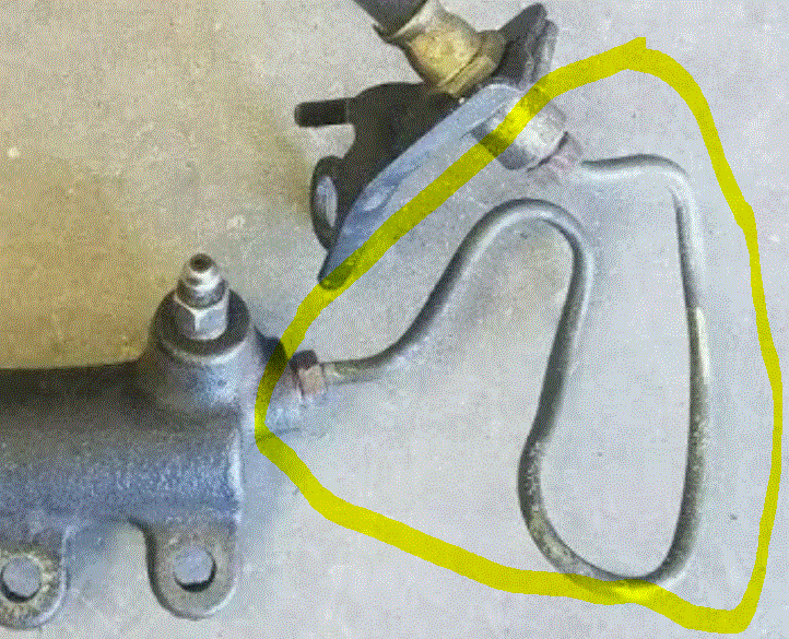

Because of the model year, chances are you will need to make your own. Do me a favor. Take a look at the attached pic. Is that what yours's looks like? If so, I understand why you are concerned about the bends. However, it doesn't need to look exactly like that.

That is it.
Sep 20, 2021 at 3:17 AM
Perfect. Joe can weigh in on this but if it were me, I would just bend a single tube and remove that S bend. It is there in case there is any movement that it doesn't pull on the threads.
However, you can make it a decent size U bend and achieve the same thing.
Either way, sounds like we think the best bet is to make your own.
