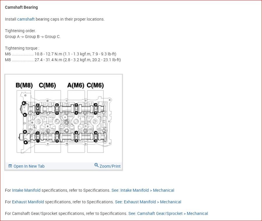

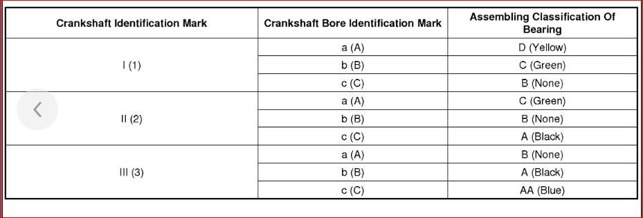

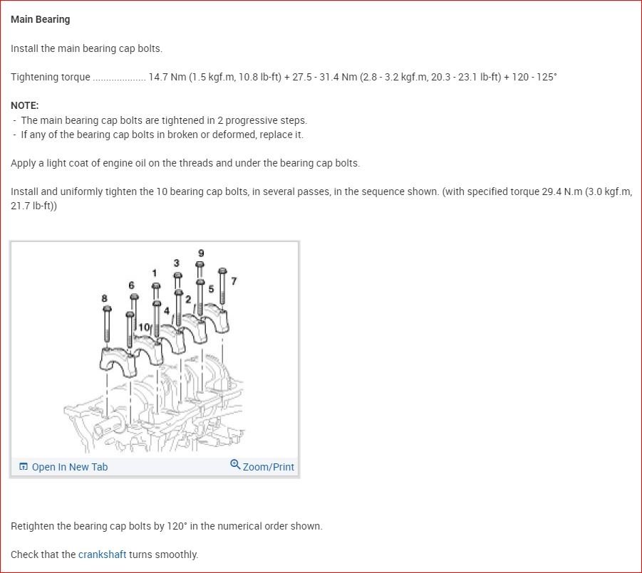

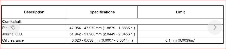

I understand the concern and I would share it. The metal you are finding is most likely from a bearing. The tapping is most likely the source of the metal so it is either the cam or crank that is causing it.
It is common when you find metal in the solenoid screen that it is throughout the engine. More than likely when the engine ran low on oil, it actually pulled air into the oil pick up and not oil and this allowed the bearings to run with no oil for a enough time that they are scored. Once this happens, it unfortunately only gets worse.
I would suggest draining the oil through a coffee filter so that you can see how much metal is in the oil. However, if the tapping is not changing after new oil, most likely you will need to pull the oil pan and valve cover to look at the bearings.
