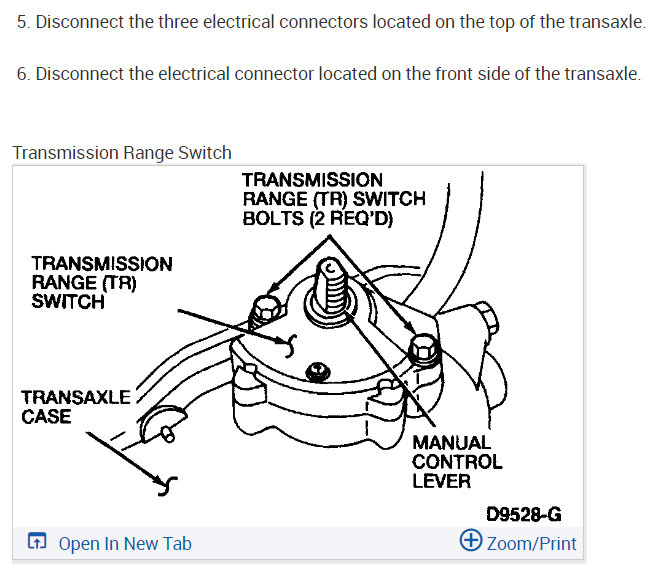

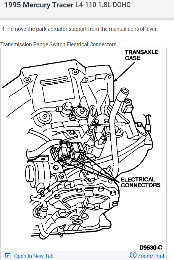

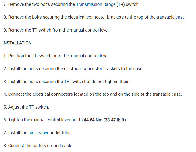

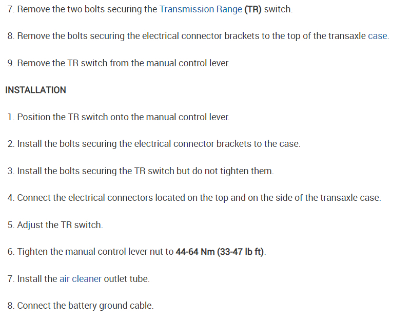

This guide can help because it sounds like the neutral safety switch has gone bad.
https://www.2carpros.com/articles/starter-not-working-repair
