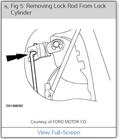

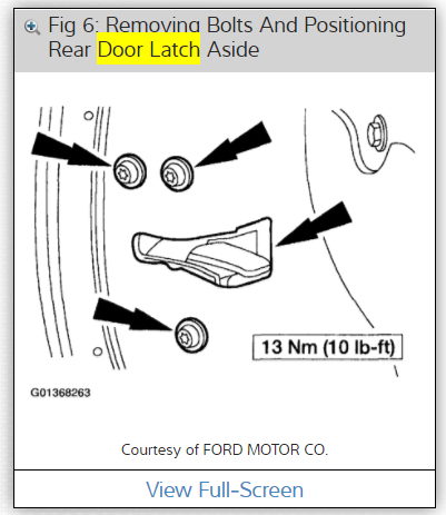

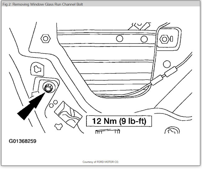

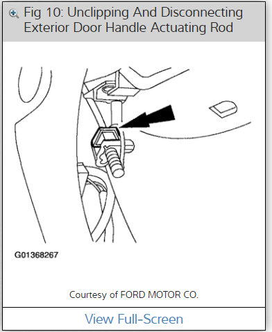

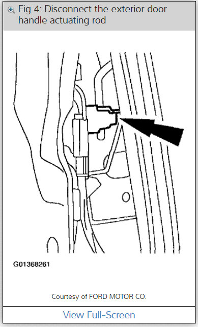

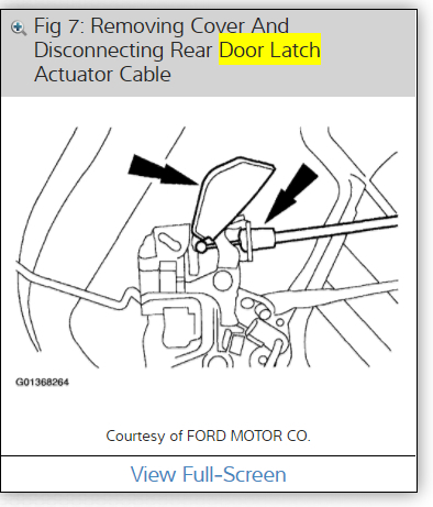

This means the micro switch inside the door latch has gone bad and the latch on the drivers side needs to be replaced.
You will need to remove the door panel to get started the guide will give you an idea of what you are in for when doing the job.
