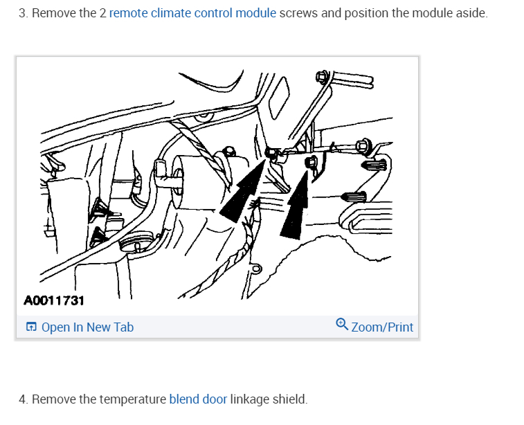

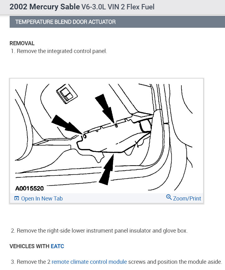

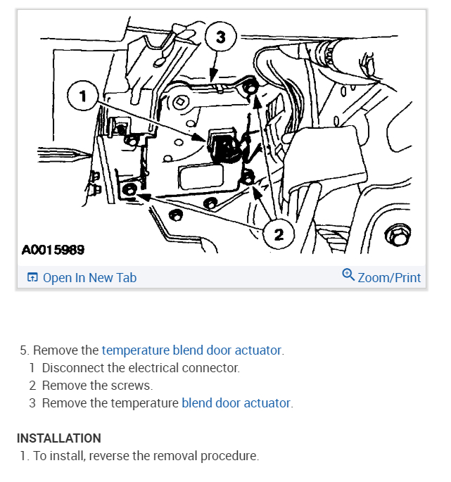

car blows cold air changed thermostat and flushed heater core it helped a little now is warm but not hot any ideas?
Jan 3, 2009 at 2:20 PM
It sounds like the temperature blend door actuator is not working here is a guide to help walk you through the repair and diagrams below to show you how to fix the problem on your car.
This guide can help as well
https://www.2carpros.com/articles/car-heater-not-working
Check out the diagrams (Below). Please let us know if you need anything else to get the problem fixed. Joe

if the two heater hoses hot then its the blend door motor stuck on cold remove and replace blend door motor
https://www.2carpros.com/forum/automotive_pictures/99387_Graphic1_67.jpg
