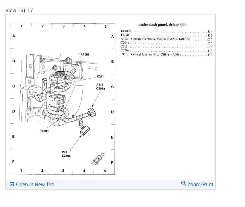

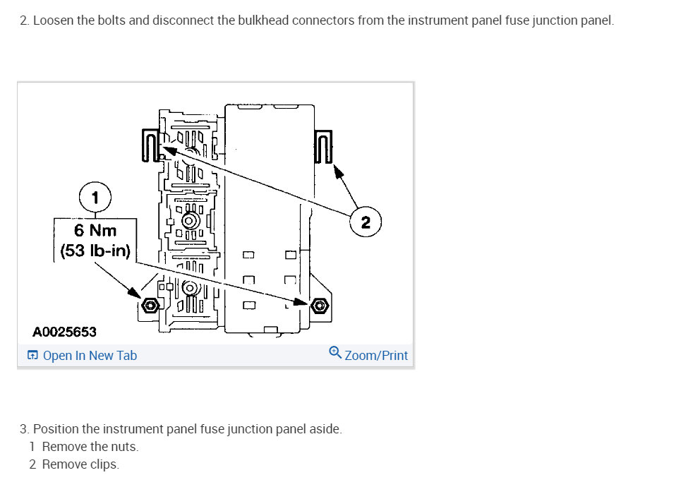

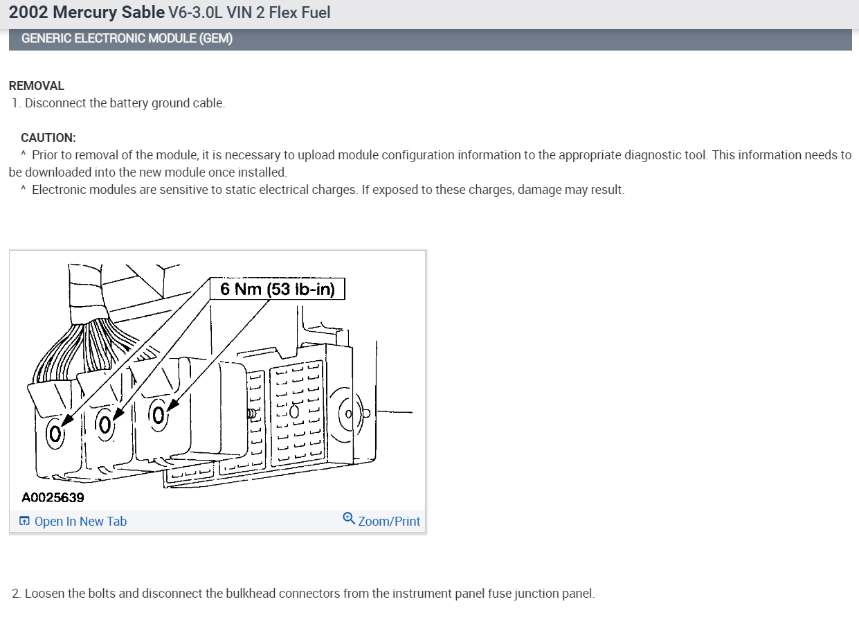

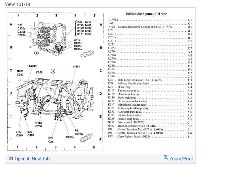

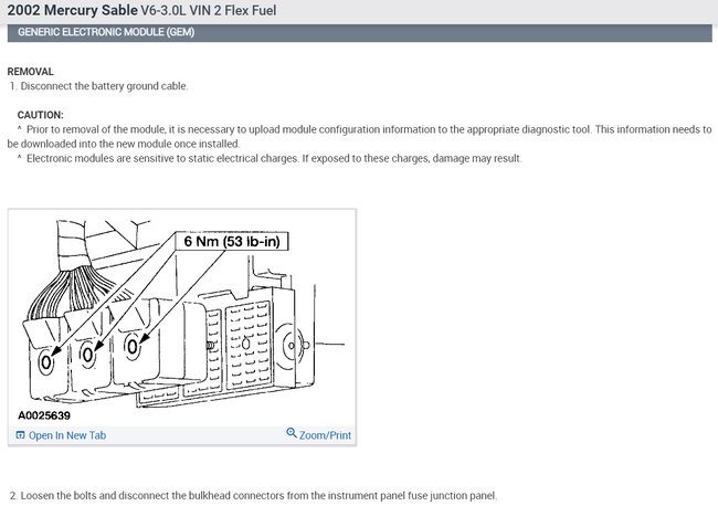

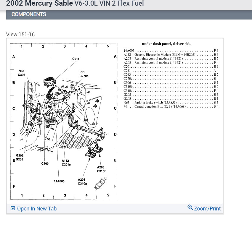

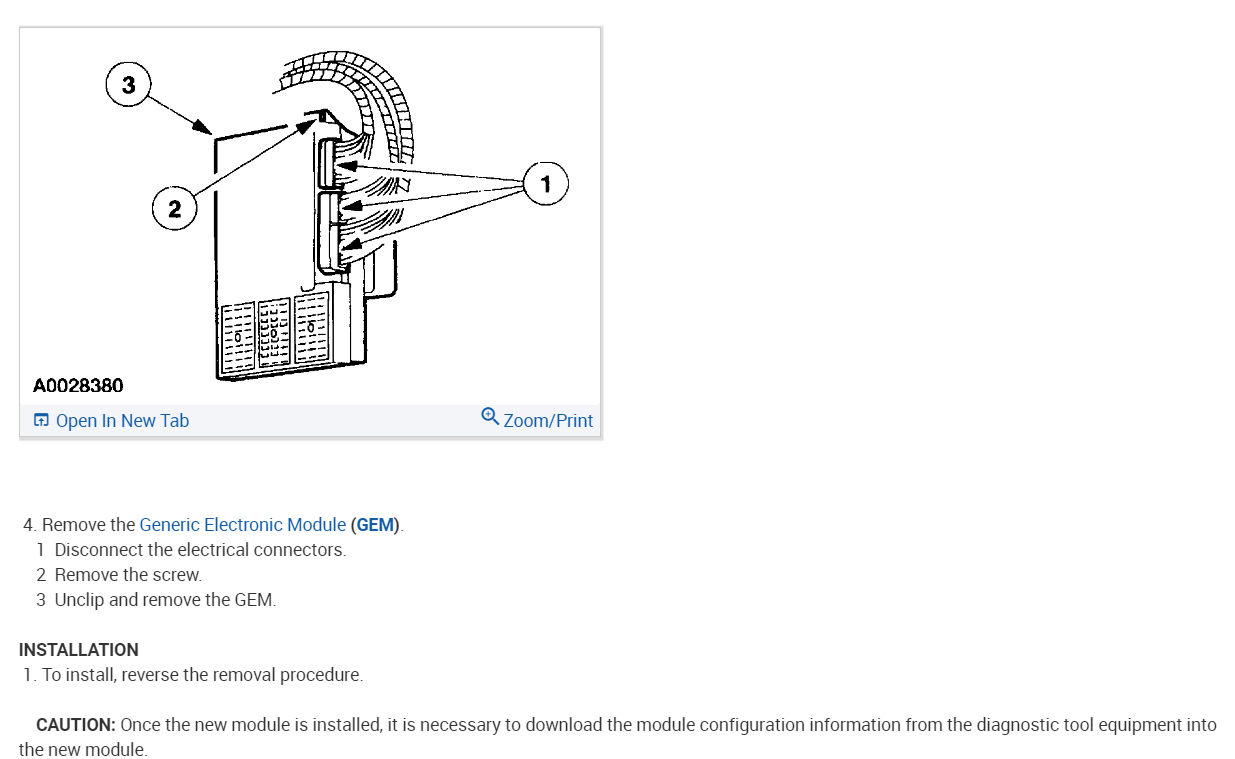

This is common when the GEM module goes out which will not leave a code, here is the location of the GEM and how to change it out, GEM (generic electronic module). Check out the images (below). Please let us know if you need anything else to get the problem fixed.
