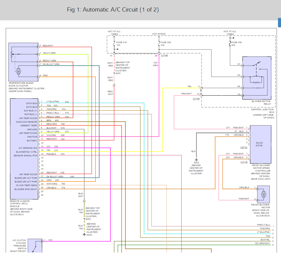

My car has ATC. The air conditioner blows hot air. When I set the temperature control it will not switch to the lower temperature from the heat control. When a certain temperature is reached it usually switches to maintain a temperature.
