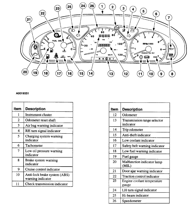

I'm not sure what you are seeing there. The only thing close to looking like a gear is actually a tire and it's the low tire pressure warning. See if you can identify which one from this. Check out the images (below). Let us know how it goes
Aug 18, 2010 at 5:02 PM
TOM DARDEN
  • 20 POSTS
It is a yellow/orange circle, with teeth on the outside of the circle, and a ! (explamation) point in it.
it is just to the left of the ABS light.
The diagram is really poor quality, but it probably is #11
Aug 18, 2010 at 5:16 PM
WRENCHTECH
  • 20,761 POSTS
That has nothing to do with brakes. That is a "Check transmission" light. It indicates that the Transmission Control Module has monitored a malfunction and stored a trouble code to identify it. You will need a professional scan tool to be able to read the code which will get you pointed in the right direction. I recommend a transmission shop.
