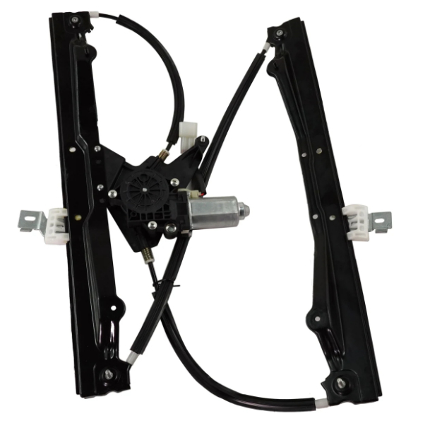

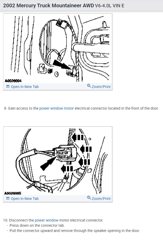

I need to know were to hook the cables from the window regulator?
Sep 11, 2009 at 10:22 PM
SQM
  • 6,383 POSTS

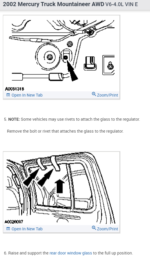

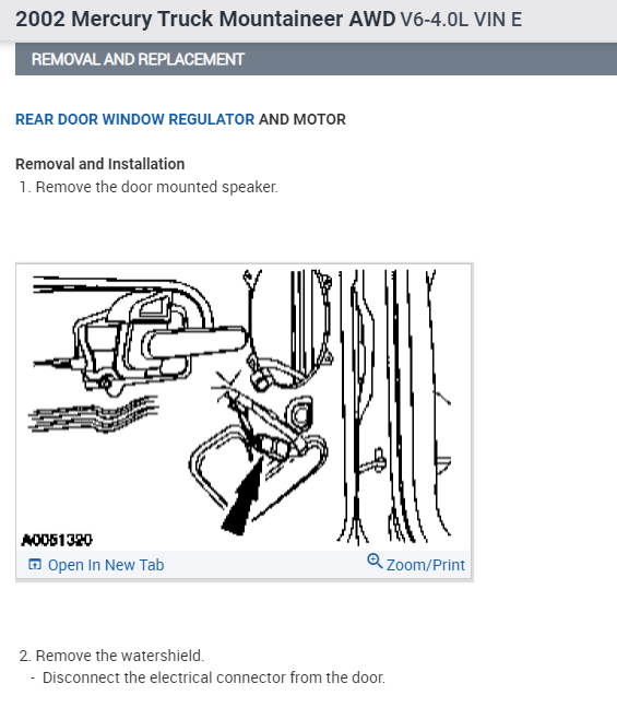

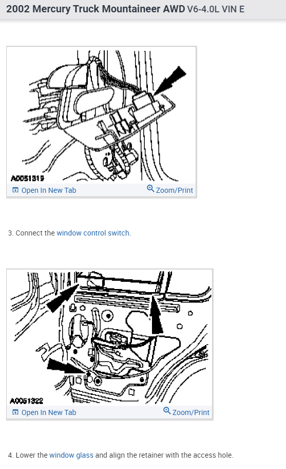

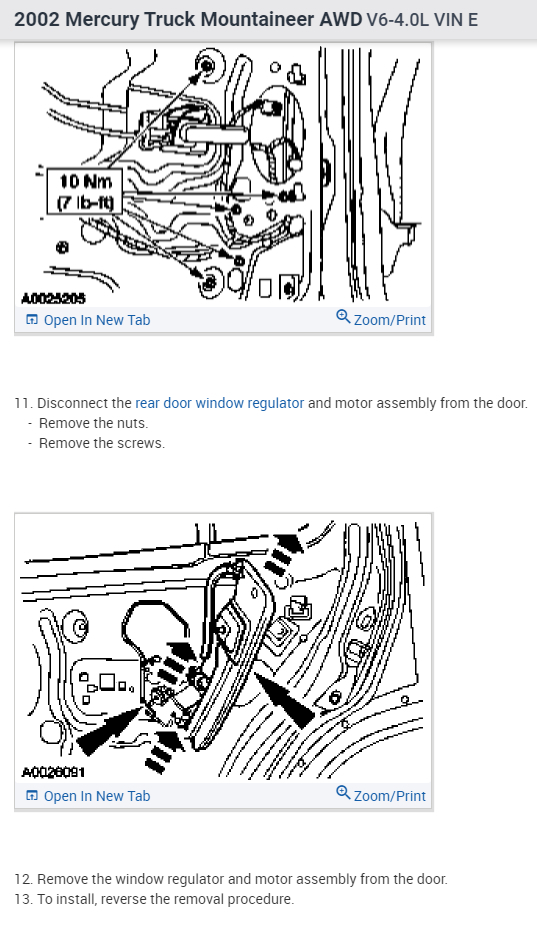

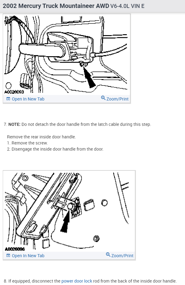

The window regulator attaches to the window and helps is go up and down. The cables on the regulator attaches to the metal brackets that is a part of the regulator. I have attached the picture below to show how the regulator looks like.
Here is a helpful guide:
https://www.2carpros.com/articles/how-to-check-and-replace-a-electric-power-window-motor
