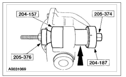

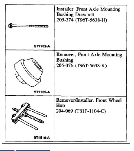

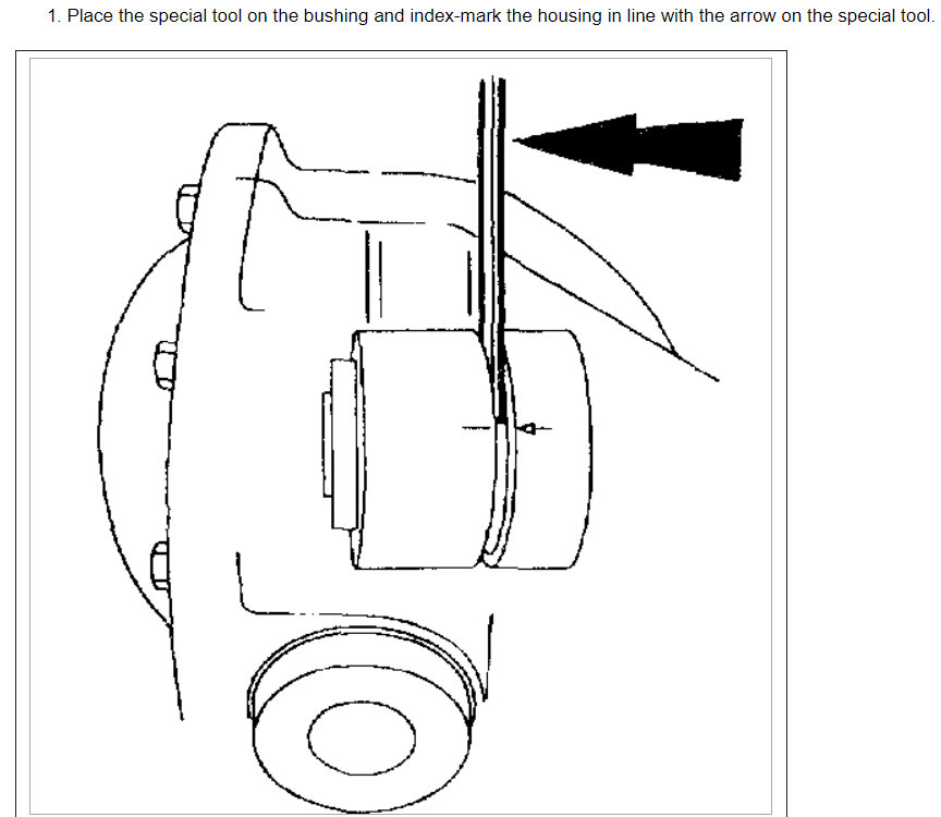

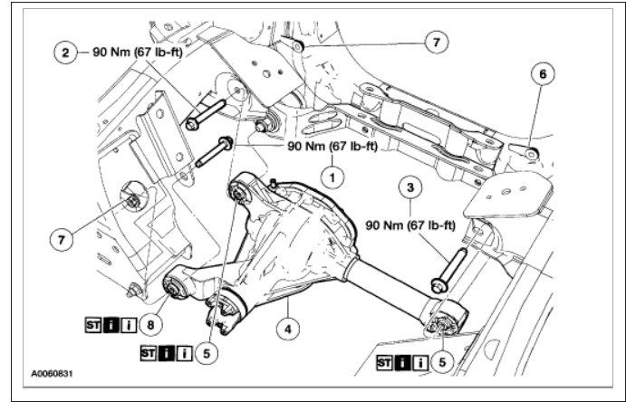

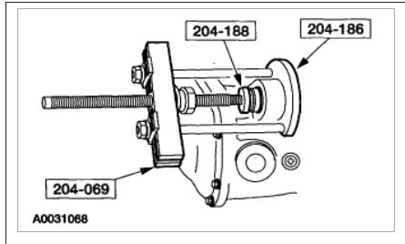

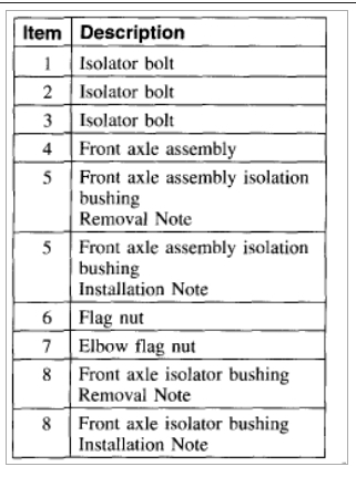

MUDDUCK4X4FUN
How do i replace the differential bushings front mount bushing replacement?
Nov 19, 2018 at 7:30 PM (Merged)
RIVERMIKERAT
  • 6,110 POSTS

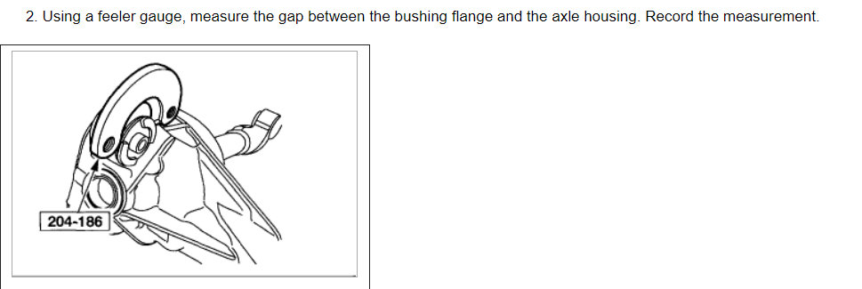

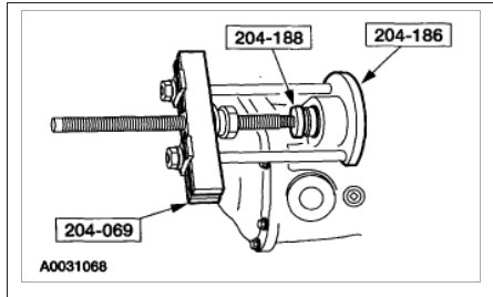

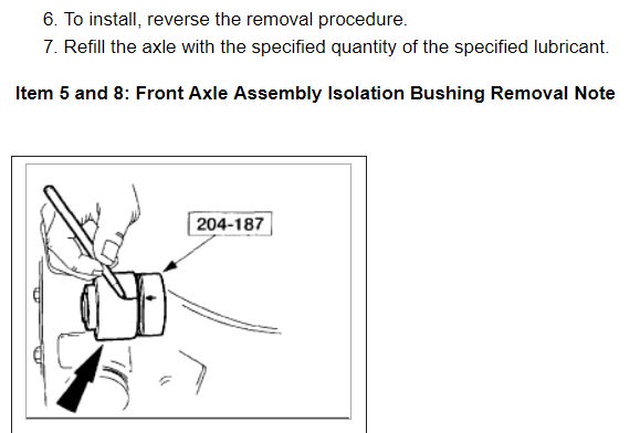

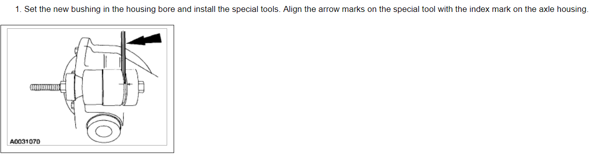

First disconnect the battery then raise the truck up on jack stands here is a guide to help.
It will take some special tolls are you might be able to rig something to work but here is the diagrams they give to do the job.
Please let us know what you find.
Cheers
