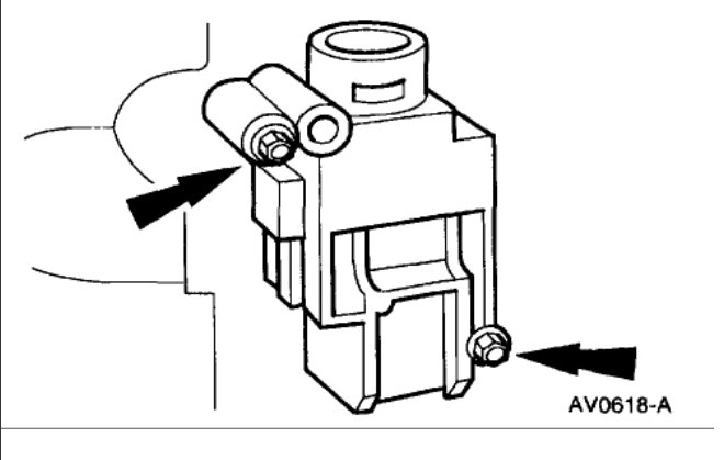

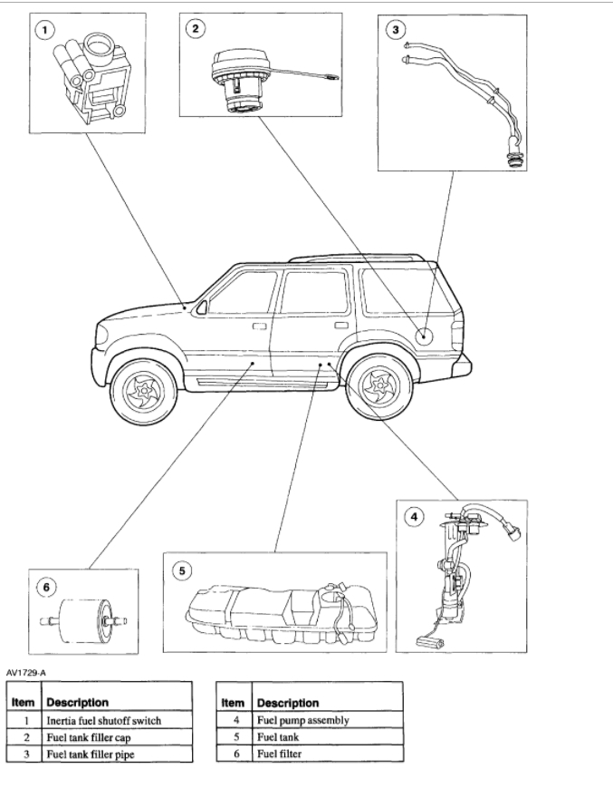

Your vehicle's inertia (fuel cut off) switch is located behind the right kick panel, also check fuses and fuel pump relay.
Here is a diagram of where it is (below)
