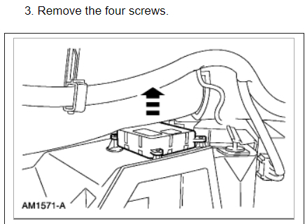

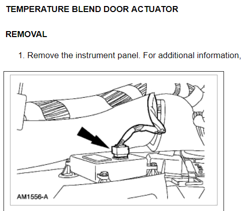

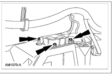

Can anyone tell me where in the dash I can find the air blend door actuator?

Could be a clogged heater core here is a guide to help you see what you are in for when changing the mode blend door actuator.
and
https://www.2carpros.com/articles/car-heater-not-working
Cheers
