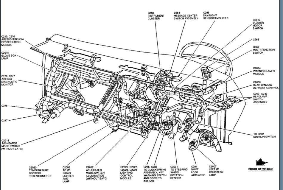

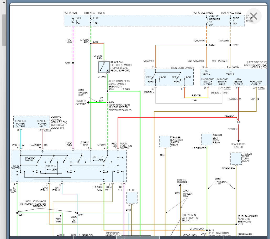

You actually do not have a flasher relay. Your flasher is integral to the lighting control module.
If the flashers are not working then we need to check the output from the control module when the switch is on.

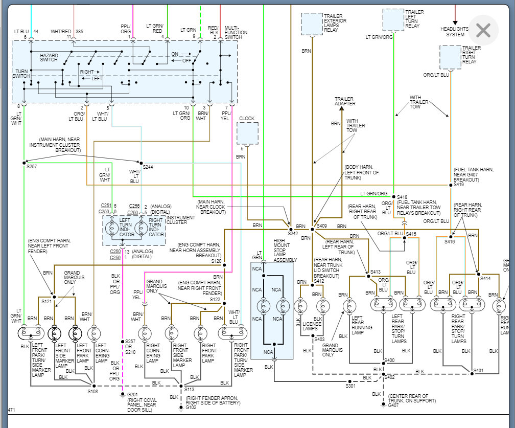

I am attaching the info below on this including the wiring diagrams. Please run through this and let us know what you find.
If you have no voltage from the LCM then we need to replace it.

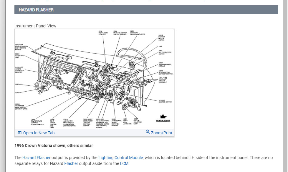

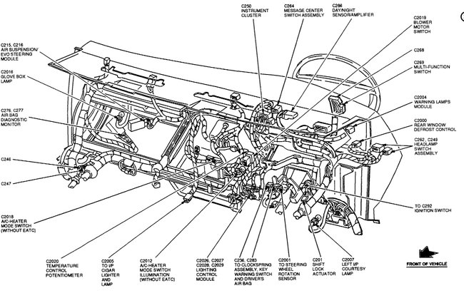

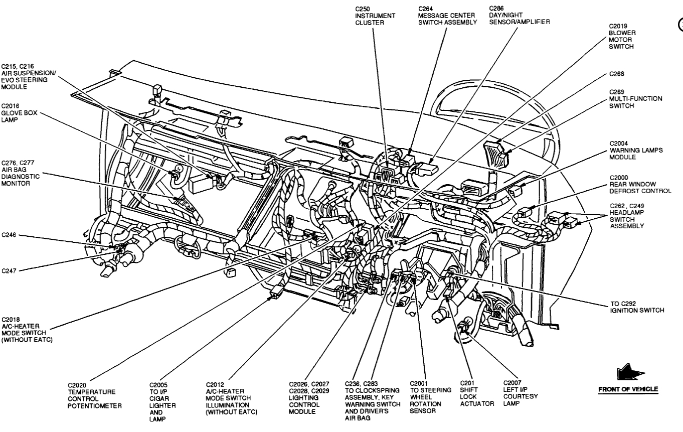

The Turn Signal Flasher output is provided by the Lighting Control Module, which is located behind the LH side of the instrument panel. There are no separate relays for Turn Signal Flasher output aside from the LCM.
