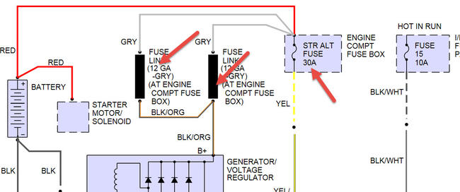

Hey all, I have a couple of real straight forward questions about symptoms of a possibly failing (or failed) alternator on my vehicle. I have a 1995 Mercury Grand Marquis LS and this morning I went out to start the car and let it warm up a bit (I live in Minnesota and mornings are rather cold in winter). The vehicle cold started perfectly and the voltage gauge was reading normal, about smack dab in the middle between High and low. After about a 10 minute warm up I came back out to the vehicle to discover the voltage meter had dropped to just above the low indication, and the battery light was illuminated on the dashboard. I drove around hoping the alternator would charge the battery a bit but the voltage gauge continued to hover right around the very bottom. Looking back, I was starting to see some symptoms of a possibly failing alternator, when I was at stop lights my headlights would dim, if I had a lot of electronics on, the voltage meter would dip quite a bit. The battery is less than two years old and I’ve never had issues with it, even cold starting in these cold Minnesota winter mornings. I’ve also looked to make sure there were no loose connections in the wiring. I just wanted to ask the professionals if replacing the alternator would be a prudent plan.

check battery for condition including load test auto parts does for free. they can check output of alternator as well . however belt and tensioner recommended replacement is 60k

Thank you so much for your quick response! I did bring the battery in for a condition and load test and the battery did fail the test. I purchased a new battery from Napa auto parts and threw the new one in. The engine started up perfectly. All lights are definitely brighter but the voltage gauge is still just hovering above the bottom with the battery light on the dash still illuminated. again I checked for loose cabling and made sure there was tension on the belt and the alternator was spinning. would it be prudent to turn my attention to the alternator?

check items in pic prior to checking alternator the links may be burnt up causing the problem they should have battery voltage on both sides.

Thank you again for your quick response, and the very good advice!! I'll check those locations for voltage for sure. And, hopefully, come back with some more information!
