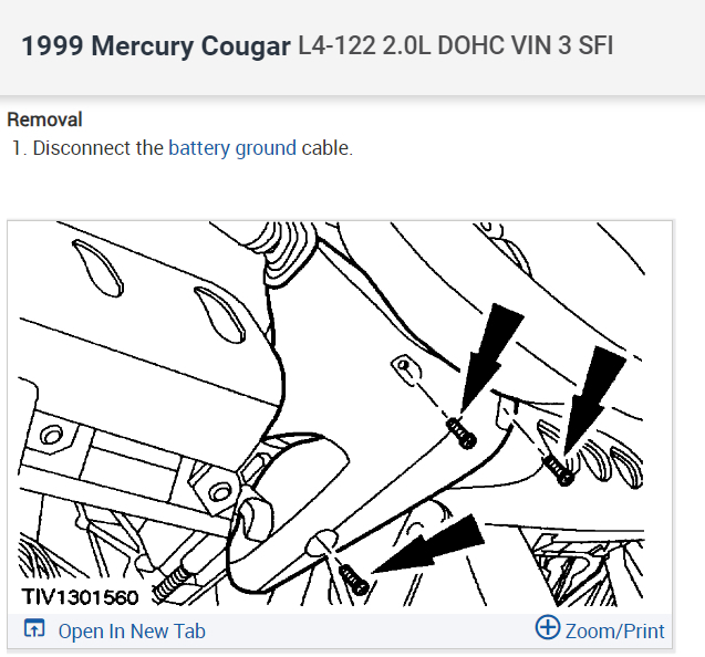

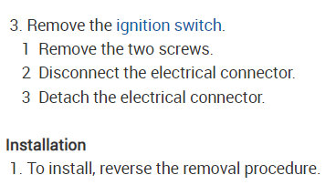

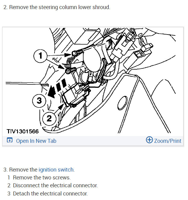

This happens when the ignition switch overheats because of a bad connection internally. Here is how to swap the switch out to help fix the problem. Check out the images (below). Let us know how it goes
