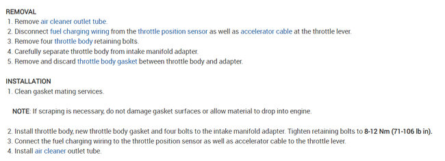

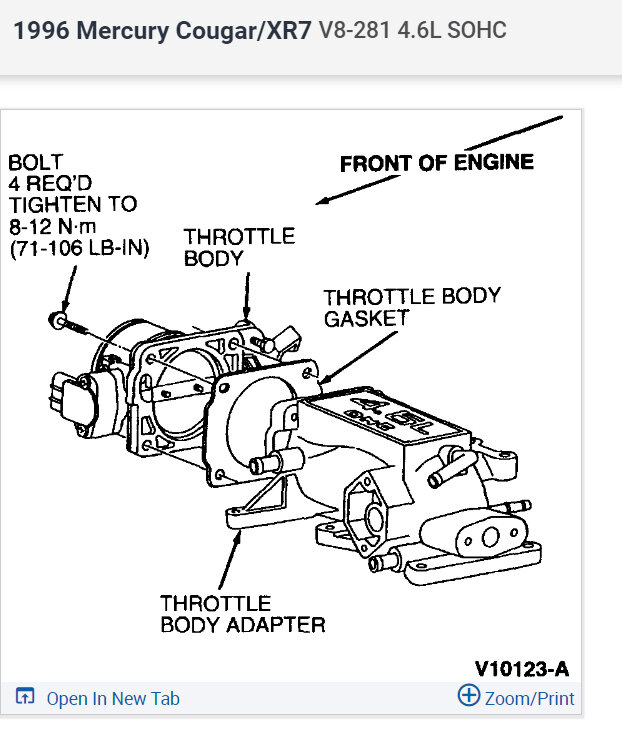

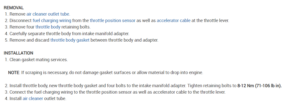

I have seen a dirty throttle body cause this problem, here is a guide to help you see what to do to fix the car.
https://www.2carpros.com/articles/engine-cranks-excessively-before-starting
Here is a guide to help you service the throttle body and check out the images below as well.
Check out the images (below). Let us know how it goes
