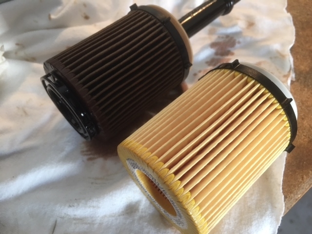

I noticed on your video of the Mercedes c300 that there is a plastic ring on top of the oil filter. My GLC 300 has the same ring. The replacement oil filter does not have that ring. What should I do with the ring?

Here is the picture.

Put the existing plastic ring on the new filter and you will be good to go.

I tired to remove it but it seems attached to the filter.
Oct 18, 2016 at 1:33 PM
It is attached to the long tube sticking out of the other side push the whole thing though the filter.
