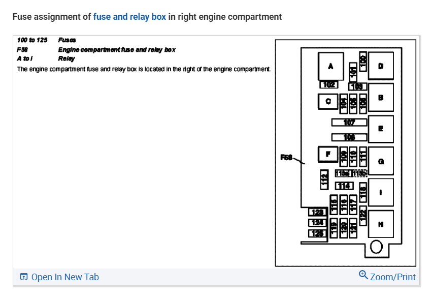

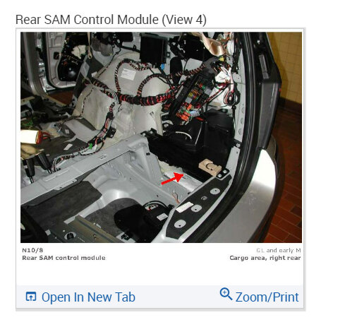

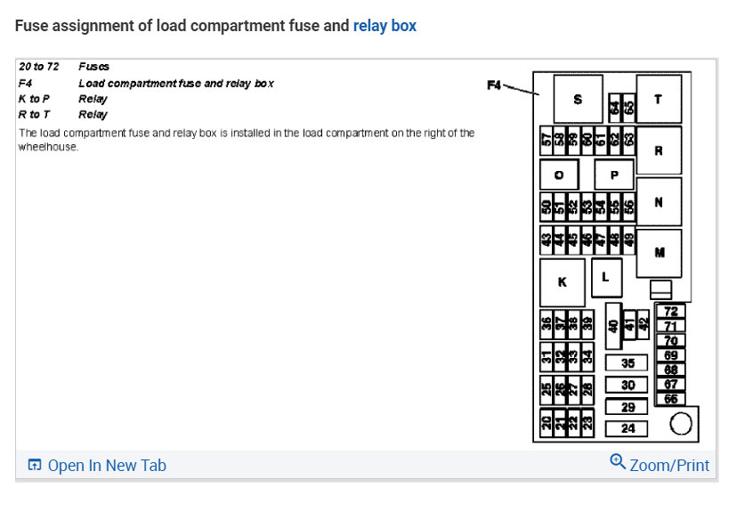

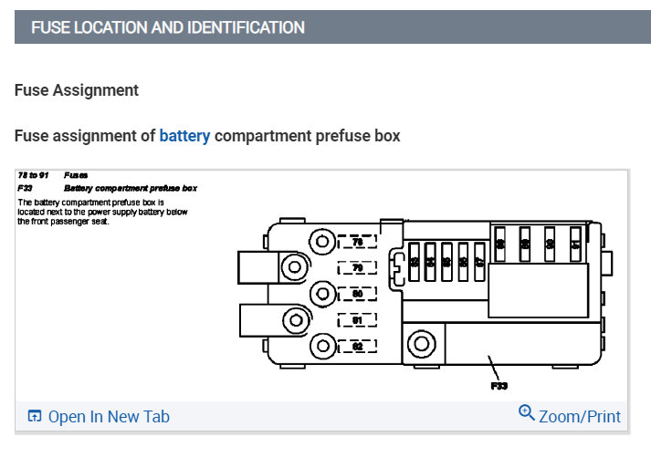

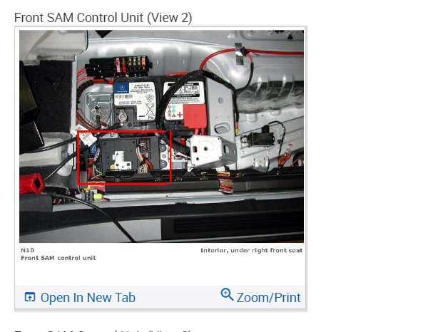

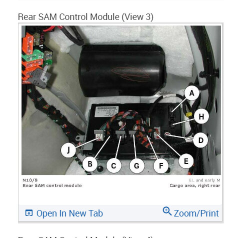

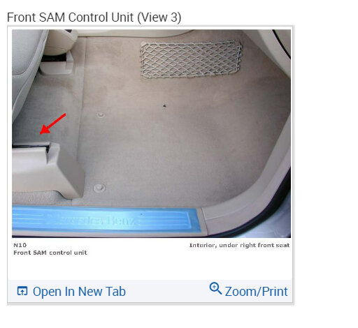

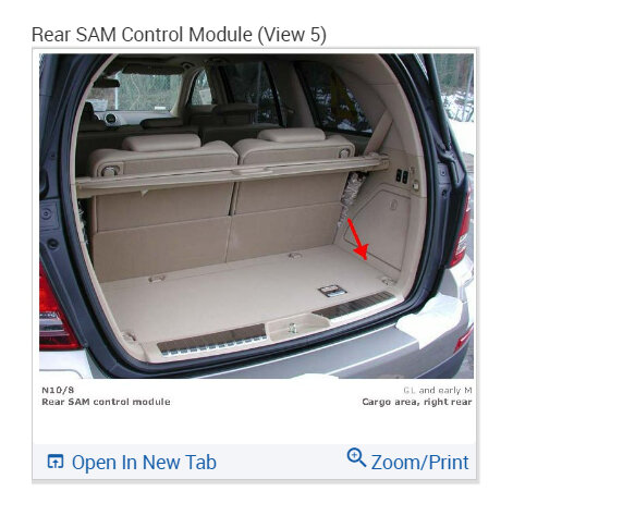

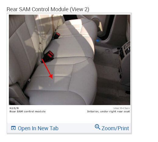

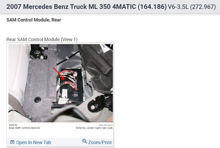

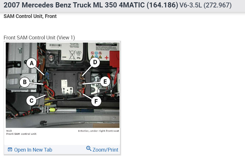

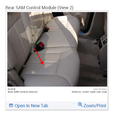

This could be a problem with the front or rear SAM control unit, which is common, but we should check all fuses with the system on. This guide can help, and I have included the fuse locations in the images below.
If the fuses are good, we need to do a CAN scan, you can get a CAN scanner (Controller Area Network) from Amazon.
Here is a video to show you how:
https://youtu.be/u-4syLc-ifQ
and
https://www.2carpros.com/articles/can-scan-controller-area-network-easy
Here is one for about $99.00 if you need it:
https://amzn.to/3ZixY4v
I have also included how to change out the front and rear SAM controller in case you need it after the scan. Check out the images (below). Please let us know what you find. We are interested to see what it is.
