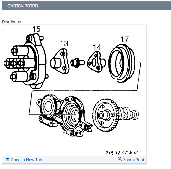

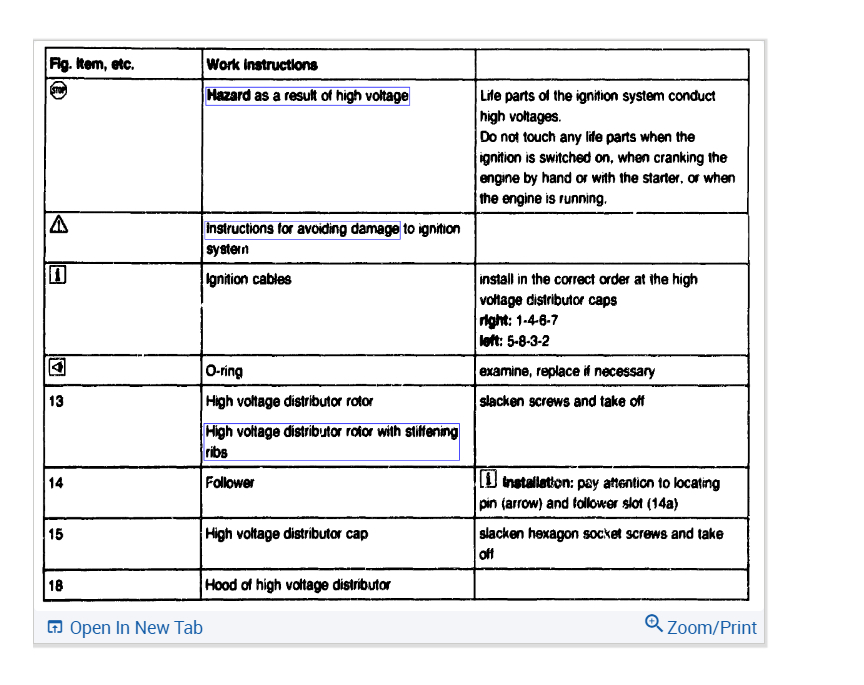

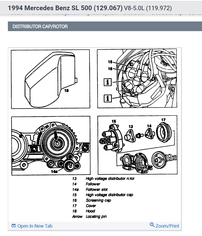

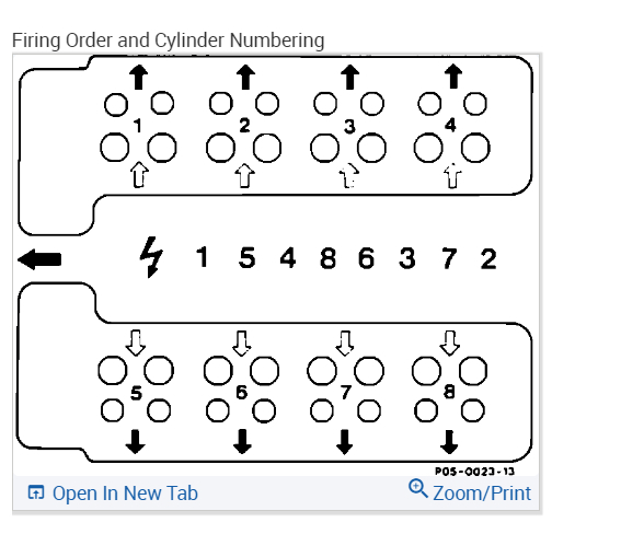

Here is the instructions on how to change out the ignition cap and rotor there is two of each on this engine. I have included the firing order as well. Check out the images (Below). Please let us know if you need anything else to get the problem fixed.
