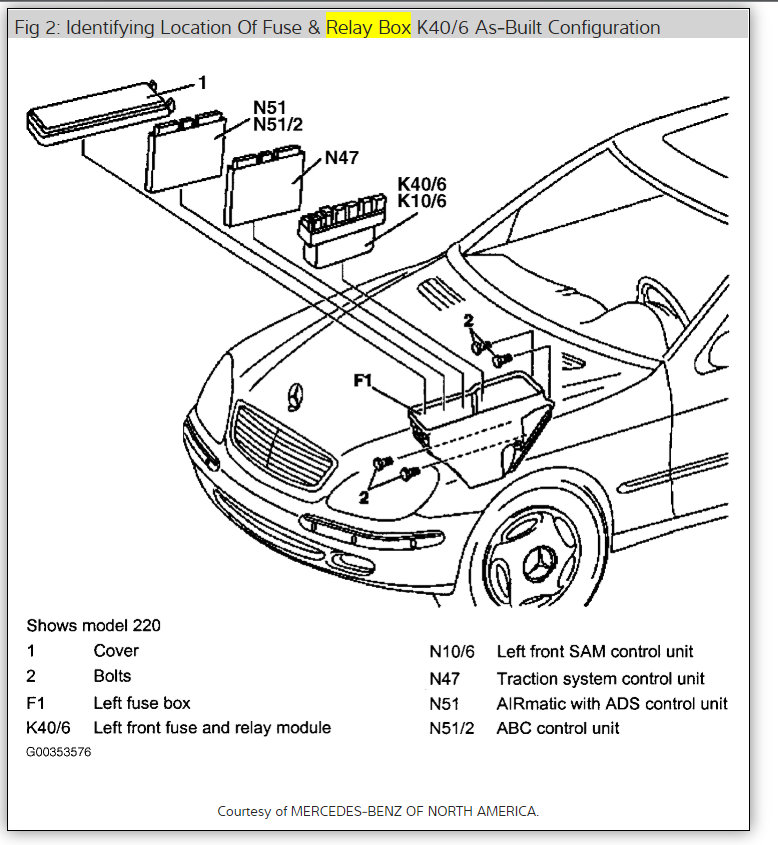

MERCEDES- BENZ: Model 215.373/374/375/376/378/379; Model 220.170/173/174/175/176/178/179; Model 221.171/176/179; Model 230.471/474/475/476/477/479 GROUP: 32 - Suspension NOTE: Vehicle lowering is generally not the result of a malfunction of a suspension strut. The suspension strut can only be responsible for vehicle lowering if it has an external leak. This can be recognized by an oil fouled boot. NOTE: The revised 3microm ABC filter entered series production as of October 2005.
