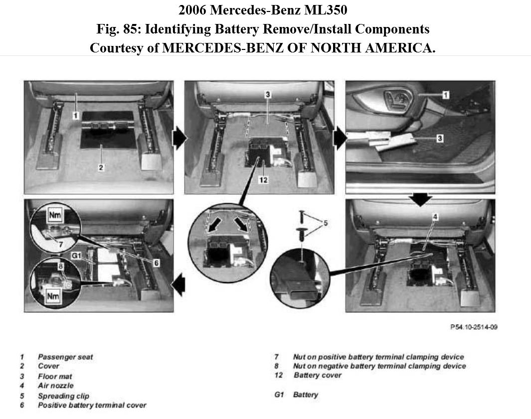

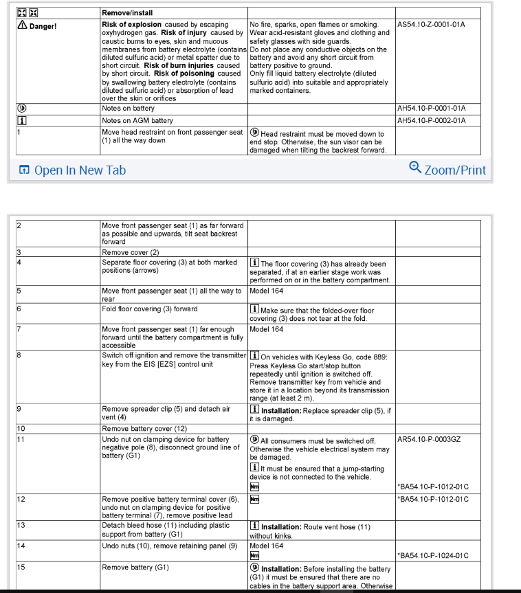

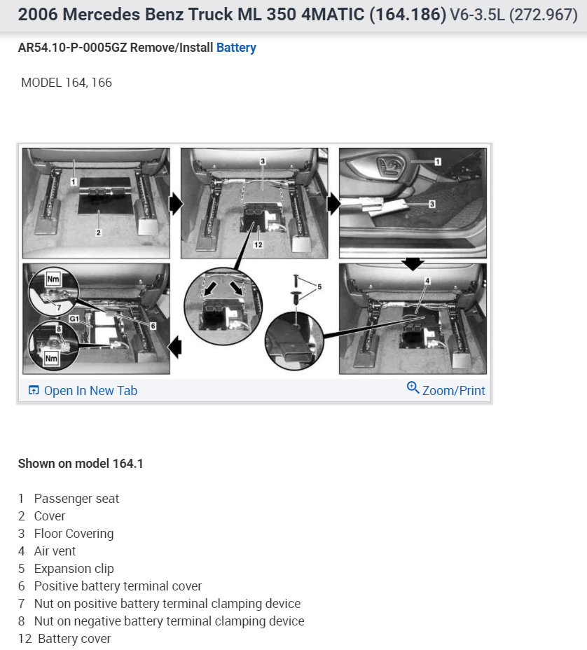

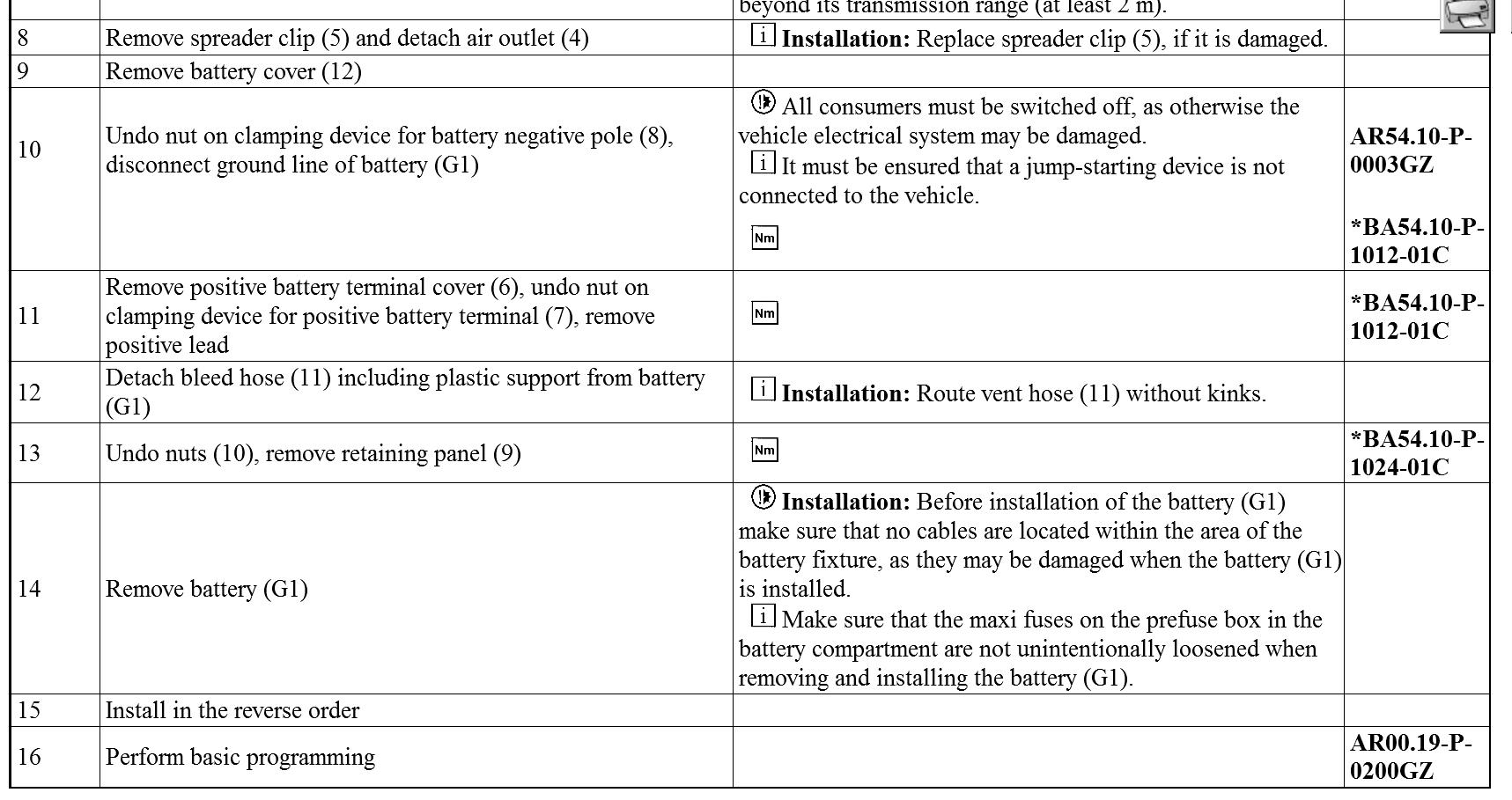

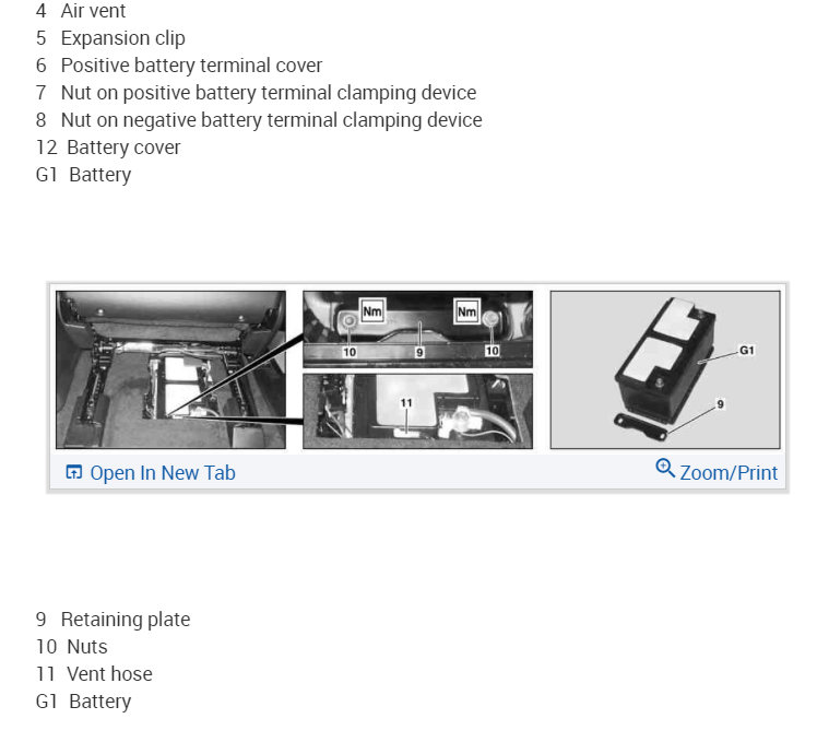

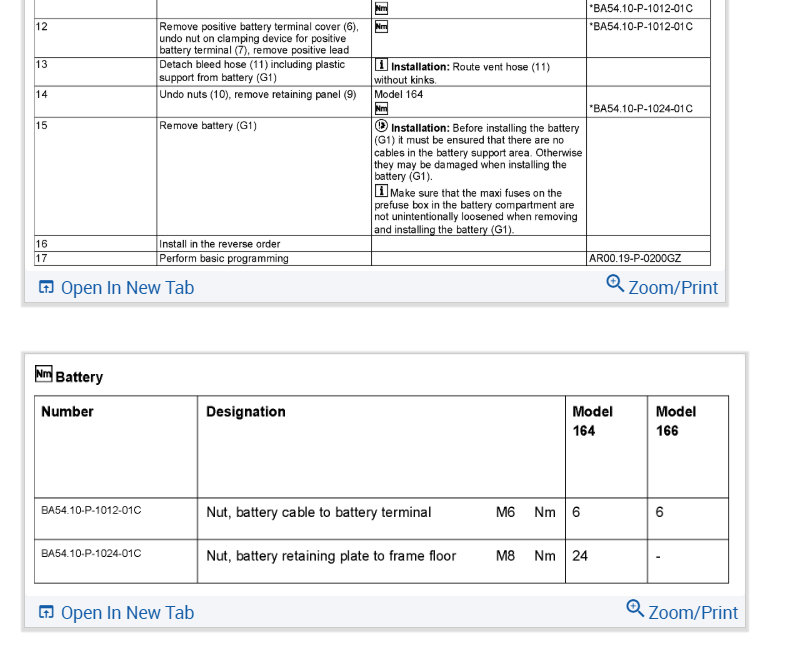

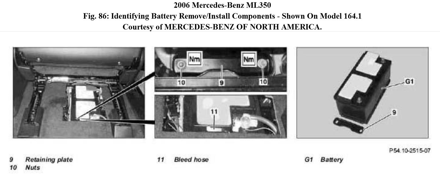

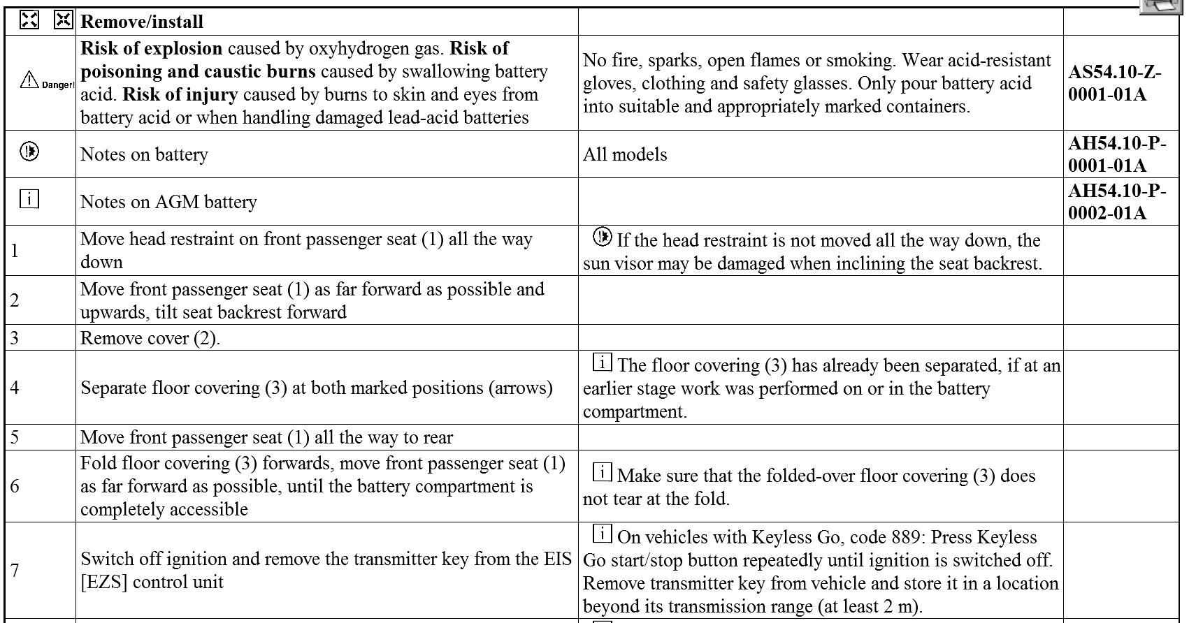

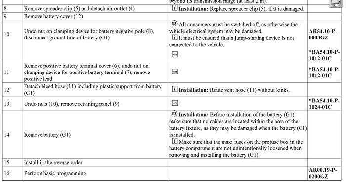

My car has starting problems - nothing happens when I turn the key. Seems to have plenty of battery power (lights etc.) and the issue happens with both keys. I think it's either an electrical issue or a computer chip related issue. The dealership has replaced and updated the SAM module and also the main car computer but still have the problem. I would like to just disconnect the battery and let everything reset but I cannot find the battery. 2 questions - where is the battery and has anyone experienced similar problems?
