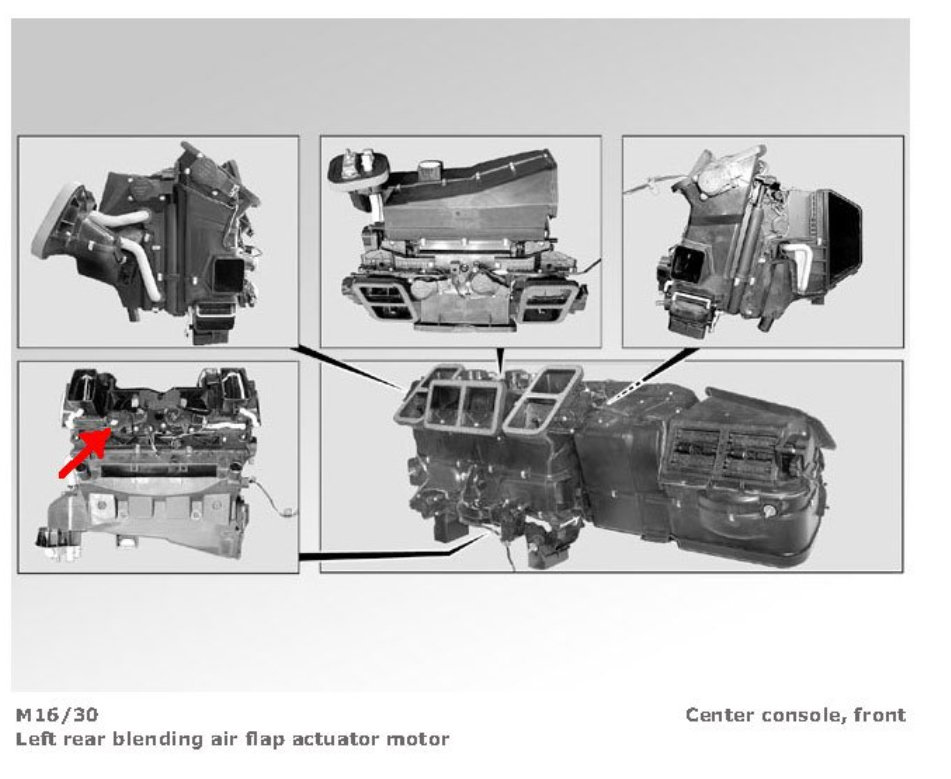

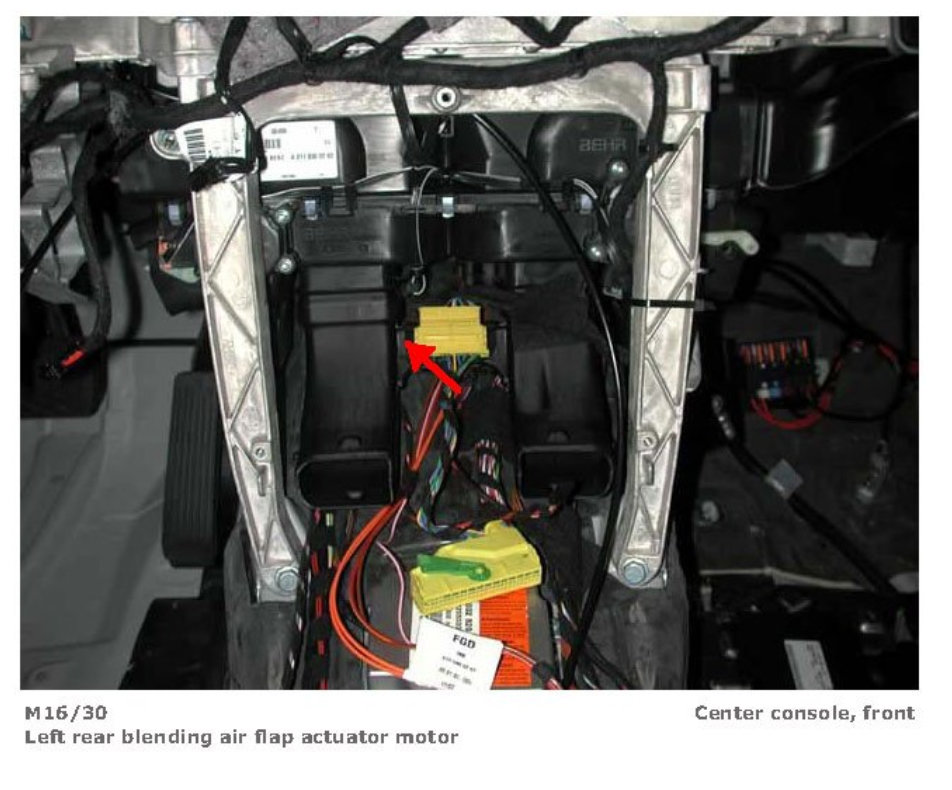

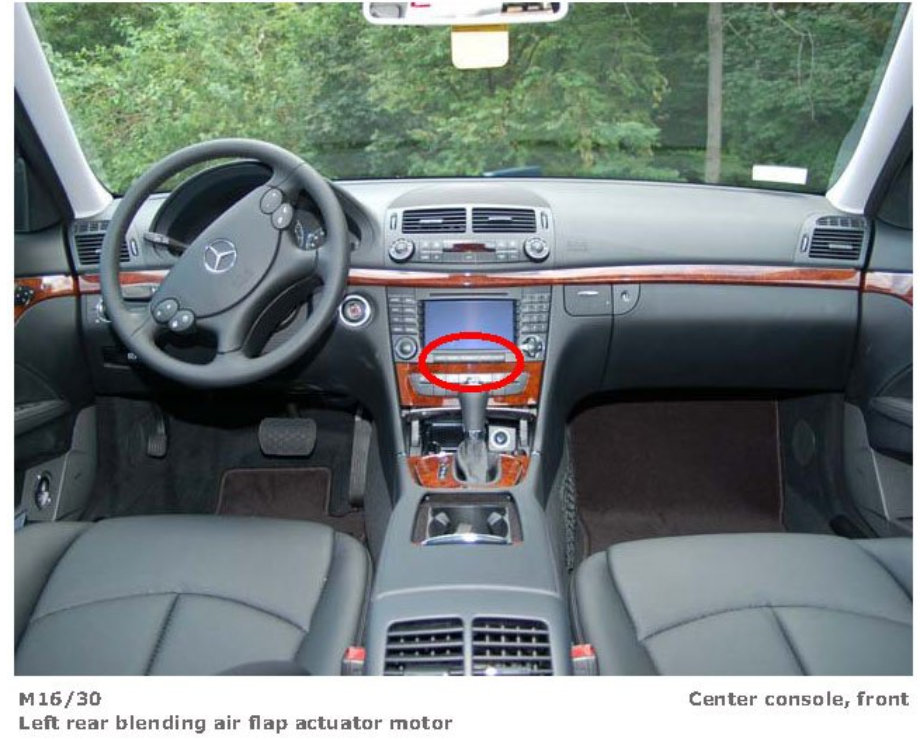

Rear unit blows hot air while front unit operates normally.
Aug 11, 2009 at 2:16 PM
DOCFIXIT
CERTIFIED EXPERT
18,828 POSTS
Hi
There are blend doors that control the rear air it sounds like one of them is not working here sia guide to help you see how to replace one and diagrams below to show you how on your car
