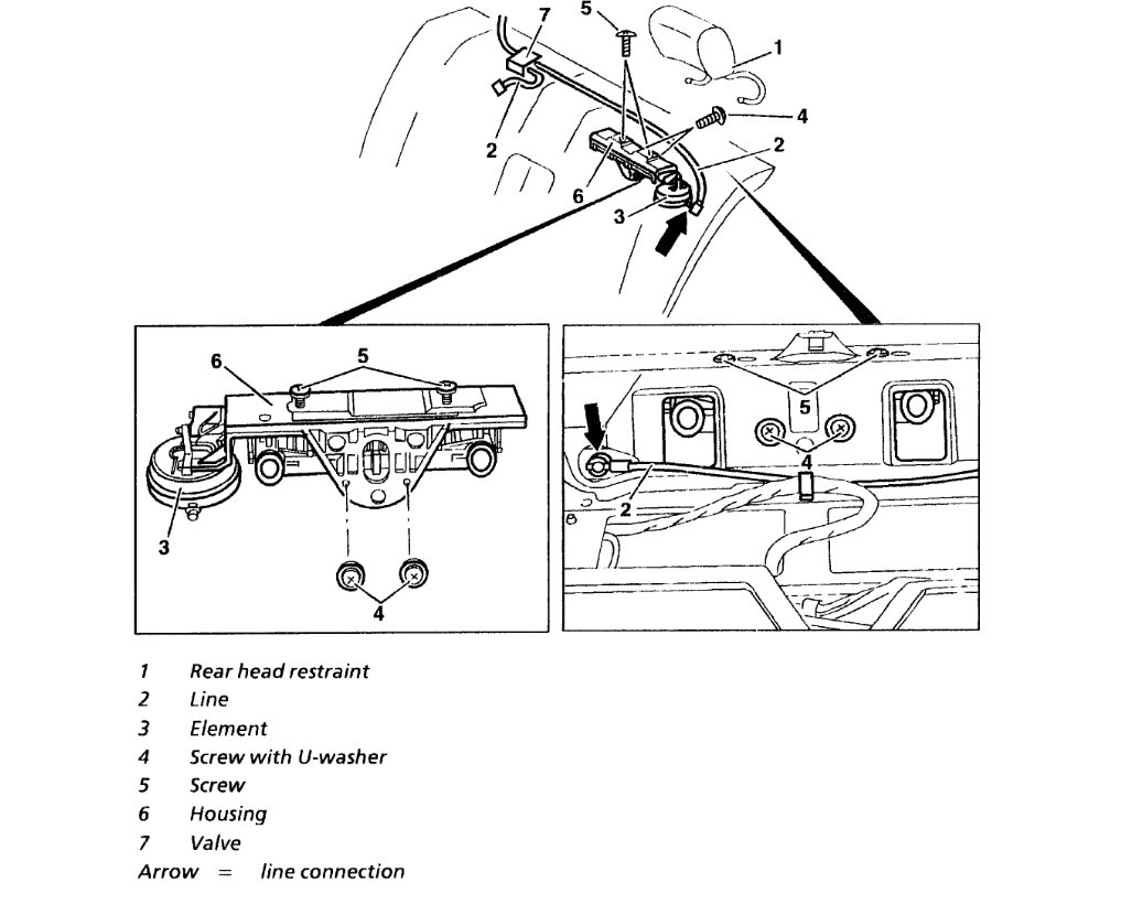

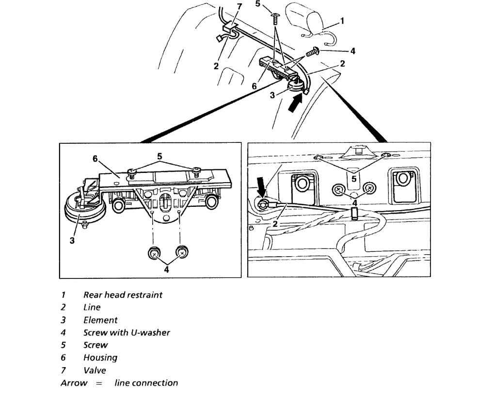

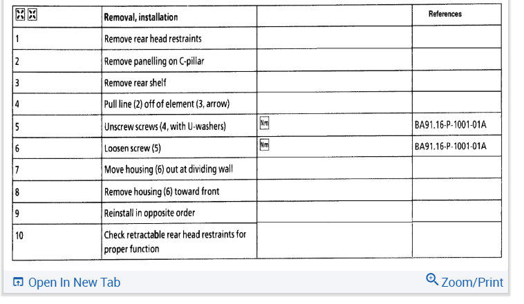

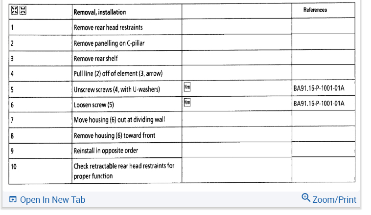

Hello Try checking fuse #5 by following this guide below and removing the headrests then lubricating mounts with WD40. https://www.2carpros.com/articles/how-to-check-a-car-fuse
