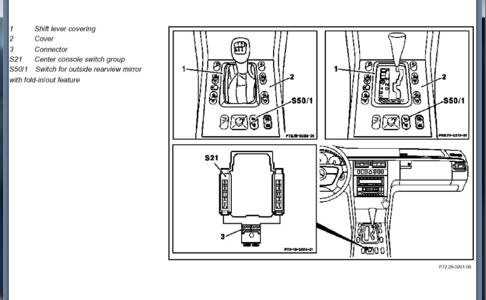

both front windows and back passenger side window will go down with console switch, but not back up. However, all windows go up with the infrared keyless lock system (meaning when I press and hold the lock button on the ignition key). Does that mean the problem is the console switches?

I think you are correct because the switch is the most likely cause of this. Here is a guide that will help with testing the switch:
https://youtu.be/HBFBcJrdym4
This is another guide that will help with this type of electrical testing:

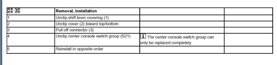

I attached the process below on how to replace the switches if this proves out.
Let us know if you have questions. Thanks
