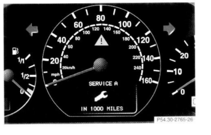

The FSS permits a flexible service schedule that is directly related to the operating conditions of the vehicle.
The service symbol appears together with a message in the multifunction indicator prior to the next suggested service. Depending on operating conditions throughout the year, the next service is calculated and displayed in days or distance remaining.
The message is displayed for approx. 10 seconds when turning the electronic key in steering lock to position 2, or while driving when reaching the service warning threshold.
The symbols and messages indicate the type of service to be performed.
One of the following messages will appear in the display (e.g. Service A):
"SERVICE A - IN xx DAYS"
"SERVICE A - IN xx MILES" (Canada: KM)
"SERVICE A - EXCEEDED BY xx DAYS"
"SERVICE A - EXCEEDED BY xx MILES" (Canada: KM)
"SERVICE A - DUE NOW"
The next service due date is displayed either in days or in miles, depending on your driving style.

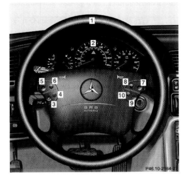

Turn the electronic key in steering lock to position 1 or 2.
Call up the trip odometer and main odometer, by pressing button 3 or 4 on the multifunction steering wheel until the display appears.
Press button 5 or 6 until the FSS indicator appears.
Pressing the 3 or 4 button displays the next or previous system.

Turn the electronic key in steering lock to position 2. To call up the trip odometer and main odometer, press button 3 or 4 on the multifunction steering wheel until the display appears.

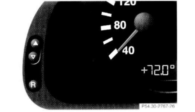

Press button "R" on the instrument cluster for approximately 2 seconds.
The multifunction display will show the question:
"DO YOU WANT TO RESET SERVICE INTERVAL? - CONFIRM BY PRESSING R"
Press button "R" on the instrument cluster again, and hold until a signal sounds. The message "SERVICE INTERVAL HAS BEEN RESET" appears in the multifunction display.
The new service indicator is displayed with the reset distance of 10,000 miles (Canada 15,000 km).
