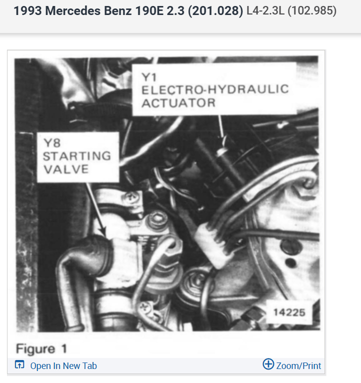

I agree with RASMATAZ, it sounds like the cold start valve is not working or needs to be cleaned here is a guide to help and I have included the location of the cold start valve in the images below so you can check it out.
https://www.2carpros.com/articles/engine-cranks-excessively-before-starting
