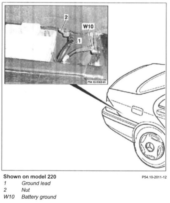

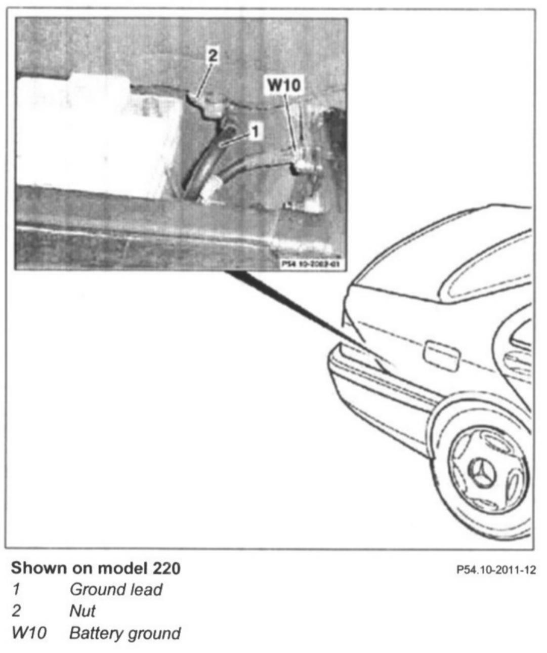

I have attached a picture of the battery location and ground wire. Plus, if you do not have a ground retention unit, what will need to be done if the cable is removed.
1. Fold back trunk cover.
2. Connect quiescent current retention unit.
3. Loosen nut (2) and disconnect ground lead (1) from battery.
4. Connect ground lead.
Note: Perform work described below only if quiescent current retention unit was not connected
5. Code radio
Note: See owner's manual
6. Set time on instrument cluster.
7. Activate steering angle sensor.
8. Synchronize power windows.
Note: See owner's manual.
9. Synchronize sliding/pop-up roof.
Note: See Owner's Manual
10. Synchronize jacket tube module.
