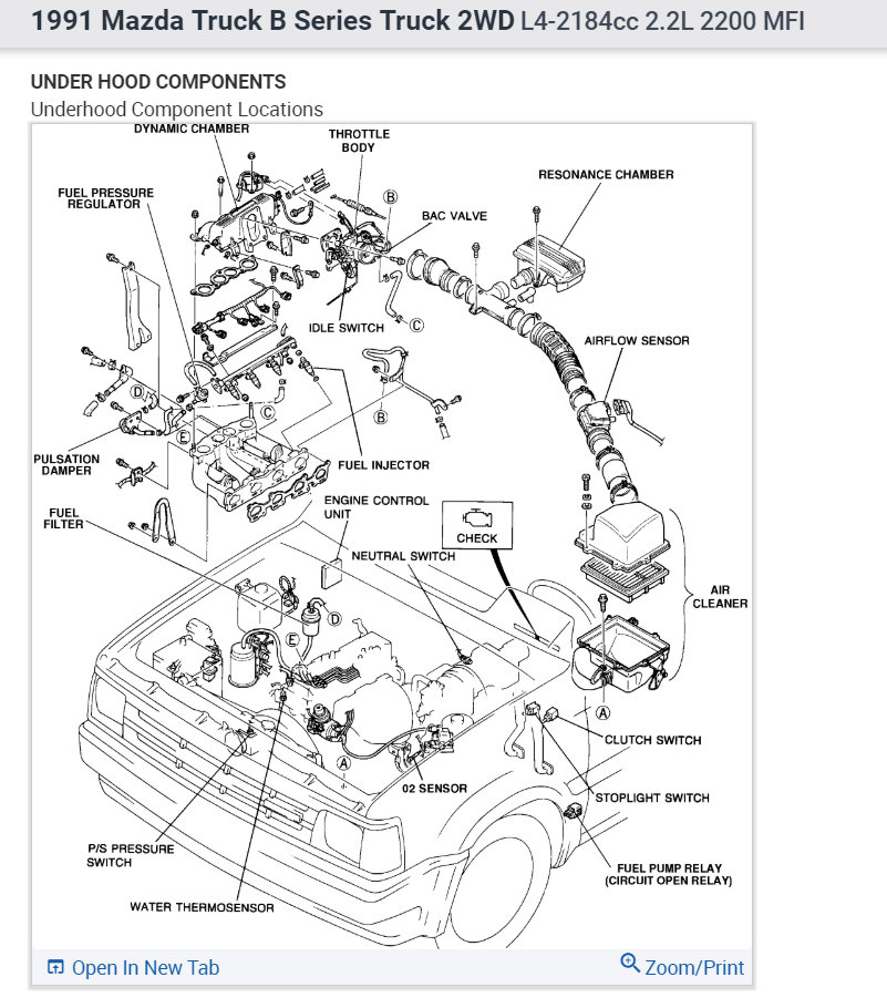

The fuel filter is under the hood here is a guide to walk you through the steps of changing it plus a diagram below to show you the location.
https://www.2carpros.com/articles/how-to-change-a-fuel-filter
Image (Click to enlarge)

I don't know the exact truck model so look in these two locations
1.Under vehicle, passenger side, below bed area, mounted on frame in fuel line.
2.Under hood, passenger side, rear engine area, mounted on upper firewall
-Rob
