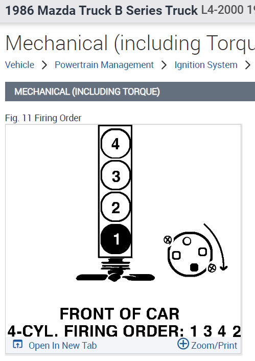

cylinder 1 is TDC, which direction should the rotor in the distributor be facing?
1986 MAZDA TRUCK
BOND343
  • 5 POSTS
when timing marks are all lined up and cylinder 1 is TDC, which direction should the rotor in the distributor be facing?
Mar 31, 2007 at 3:06 PM
RASMATAZ
  • 75,992 POSTS
Should be rotating clockwise and the no.1 tower @ 12 o clock looking at it at the drivers side-
Firing order-1342 ( clockwise) rotation
