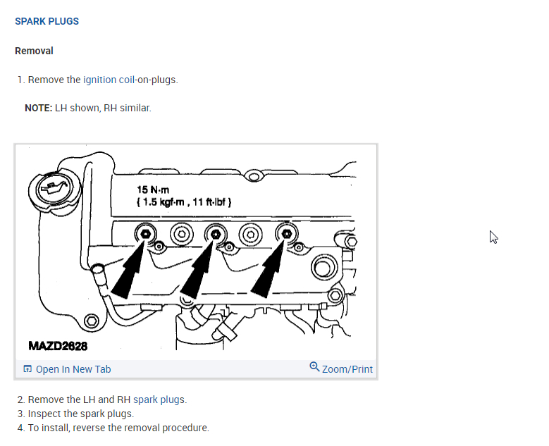

where are the spark plugs located?

Here are some guides that will help with this:
https://www.2carpros.com/articles/how-to-tune-up-a-car-engine
Plus here is a video on a similar vehicle:
https://www.youtube.com/watch?v=sIgLqmfmWgs
I attached the info from the manual below on how to replace these on your engine.
Lastly here is a guide that shows how to properly gap a spark plug in case you need this:
https://www.youtube.com/watch?v=c9_NVXiwvYg
