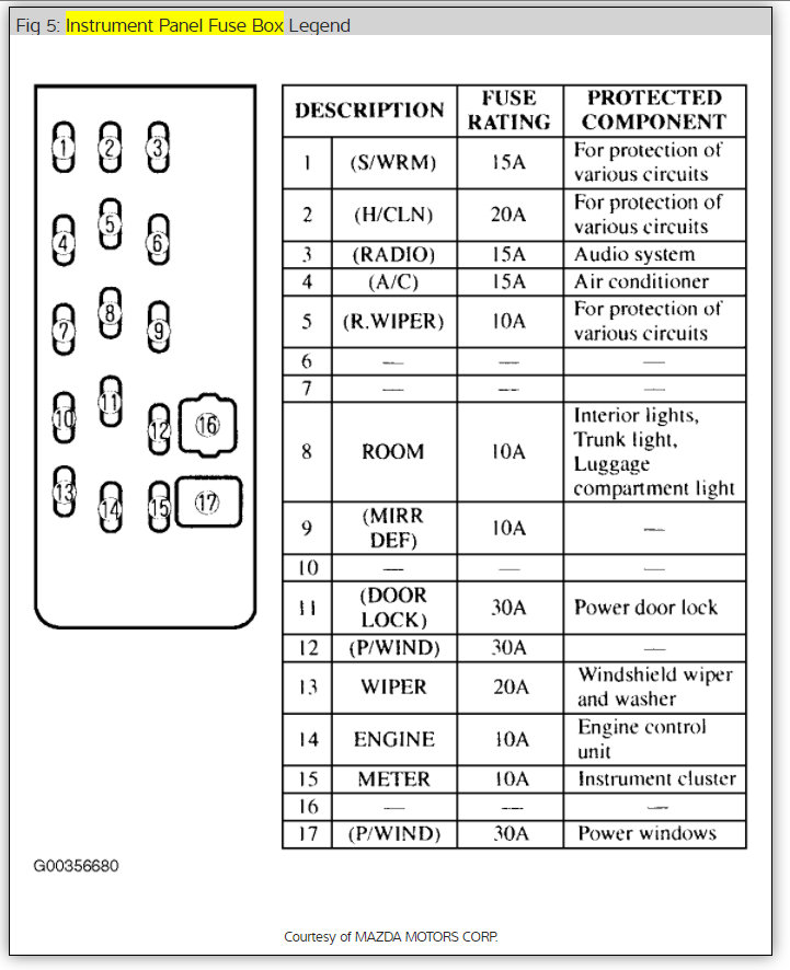

Start by checking for power at the fuse to make sure the radio is getting power.
Here is a guide to help you see whats going on.
Please let us know what you find.

I checked the power at the fuse and it is getting power, I think the radio is fried!
I will get an aftermarket one and install it. Thanks for everything guys, I love this site.
