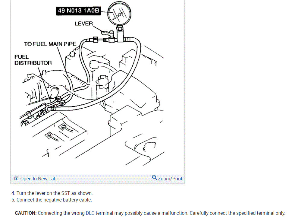

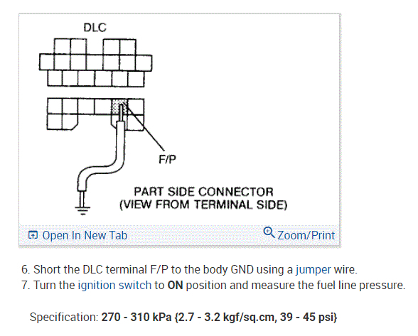

Since you have a lean mixture, chances are there is an engine vacuum leak or low fuel pressure. To get you started, here is a link that explains how to check for and repair an engine vacuum leak:

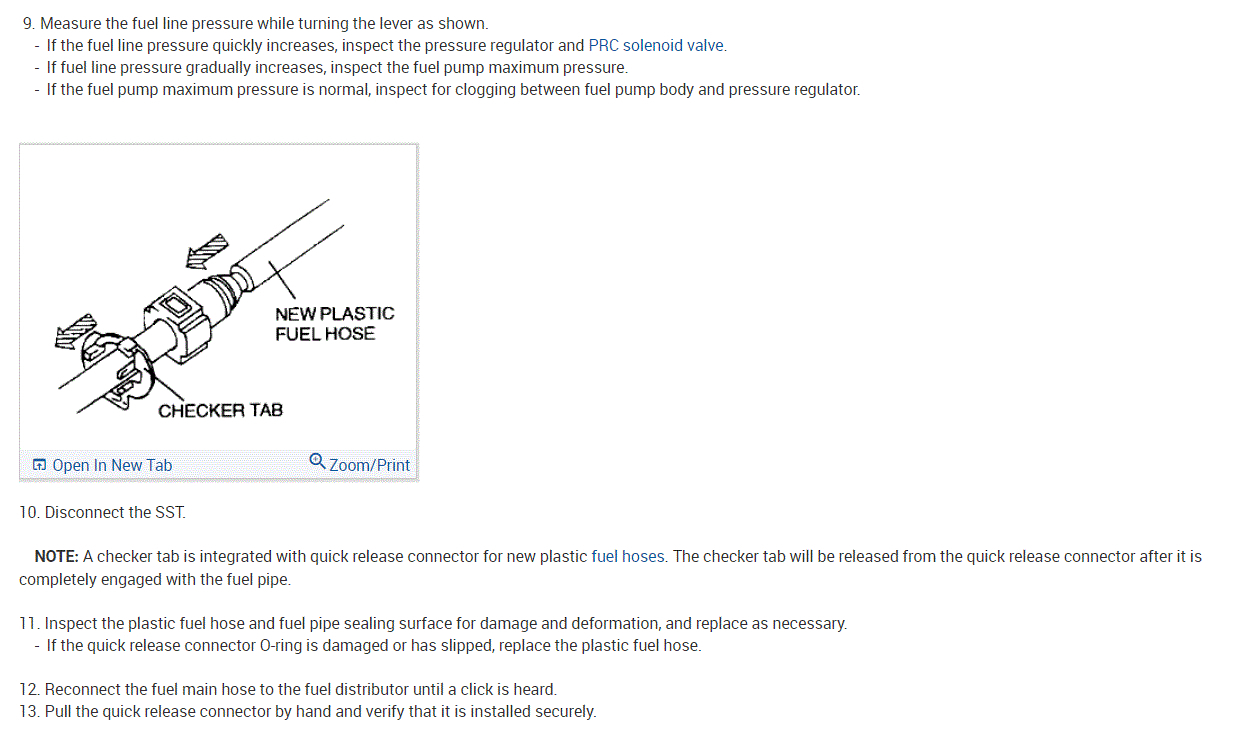

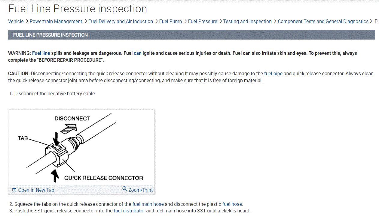

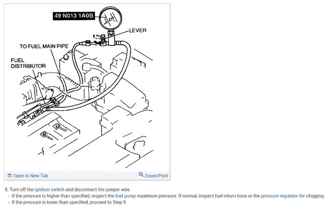

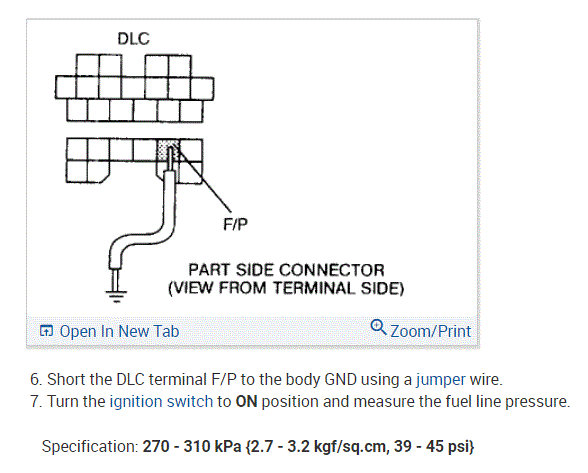

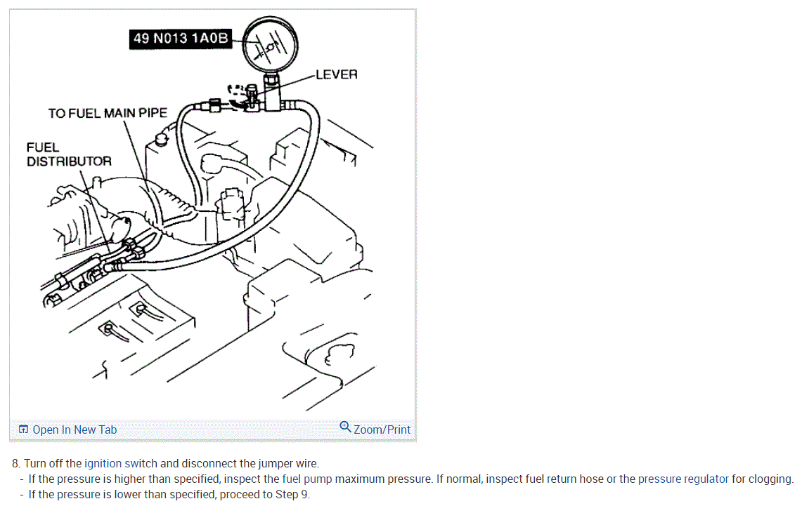

If no leaks are found, I recommend testing the fuel pressure to confirm the pump is producing what the engine needs to run properly. Here is a link that shows in general how it's done.
If you look at the attachments below, they provide the directions specific to your vehicle. Additionally, they include the manufacturer's fuel pressure specifications.
I hope this helps. Let me know if you have other questions.
See pics below.
