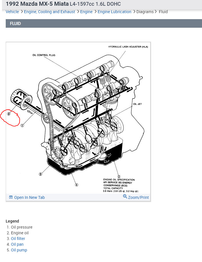

Location of oil filter needed.
May 24, 2010 at 2:42 PM
SQM
  • 6,383 POSTS
The oil filter is located on the lower part, on the passenger side of the engine. See picture and diagram below.

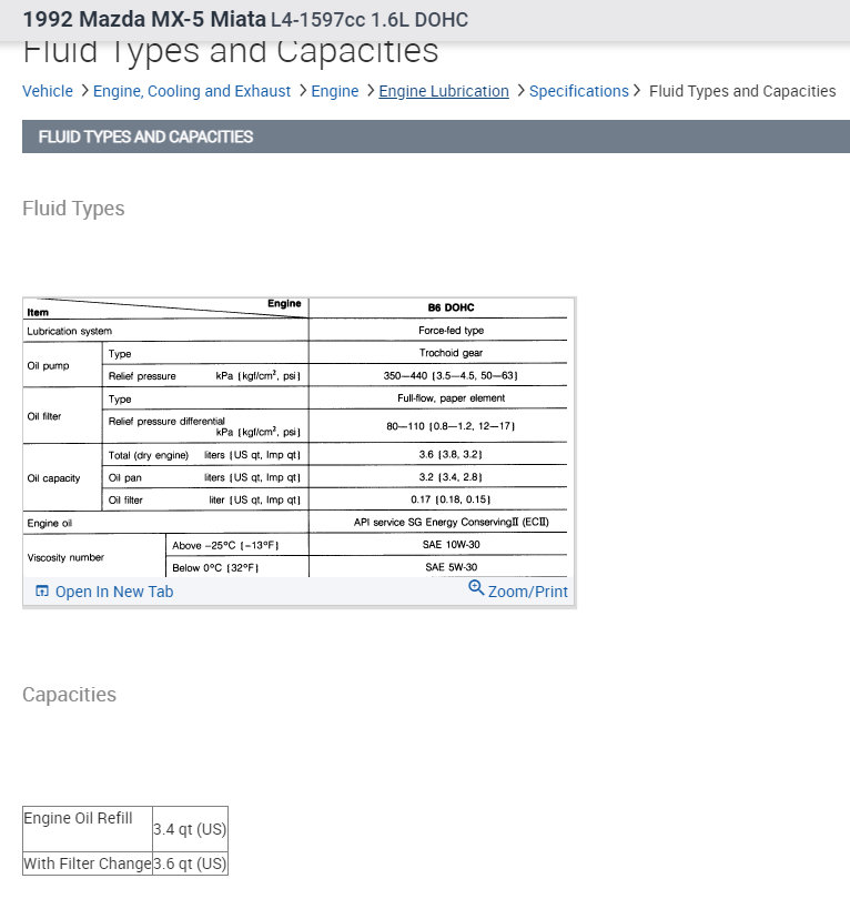

This vehicle uses 5W-30 or 10W-30 oil and takes 3.6 Quarts to fill up on an oil change.
