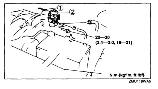

EGR VALVE REMOVAL/INSTALLATION
1.Disconnect the negative battery cable.
2.Remove the air cleaner.
3.Disconnect the vacuum hose.
4.Disconnect the EGR pipe.
5.Remove in the order indicated below.
1.EGR valve connector
2.EGR pipe
3.EGR valve
6.Install in the reverse order of removal.
7.Connect the negative battery cable.
